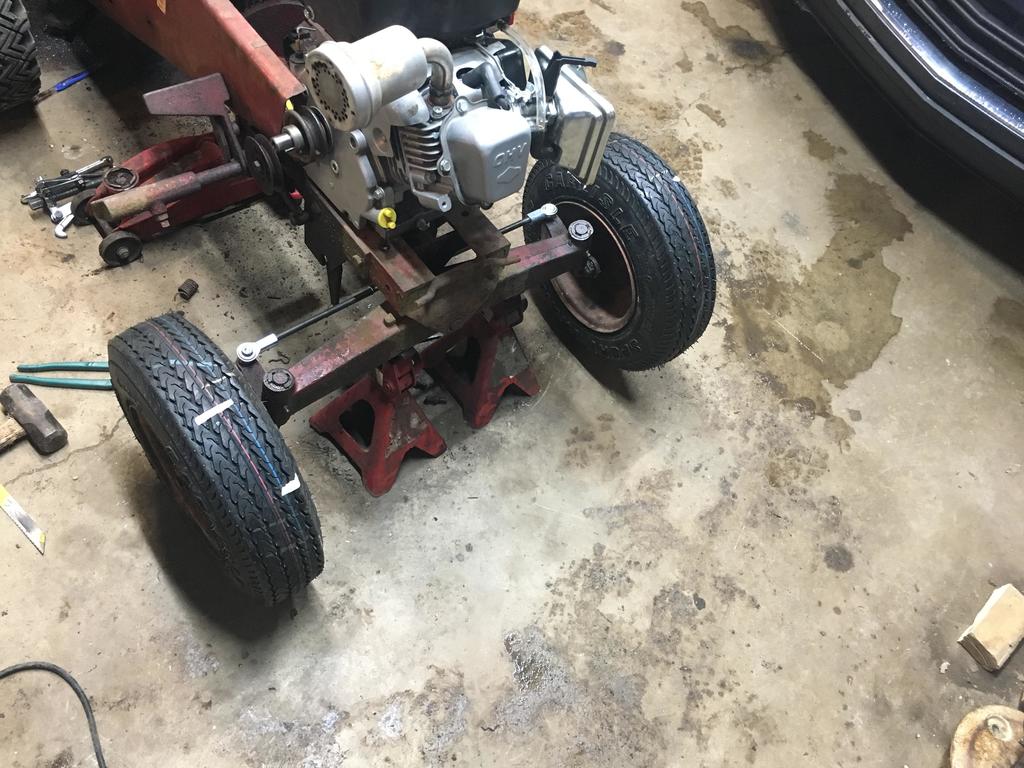

Well I scored a gently used Briggs 900 series to repower my new 606! Doesn't have an air cleaner cover for it so I zip tied the filter on after I cleaned all the junk out of the carb and it ran good. Now it will rev slow and die after it idles a second. I'm guessing there's some more gunk in the carb that I either missed or broke free??
