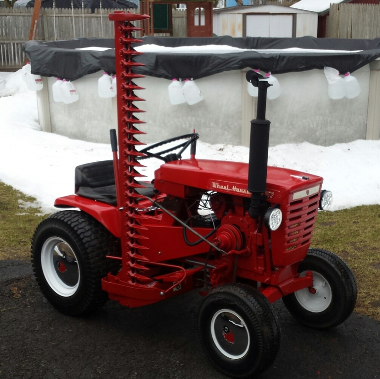

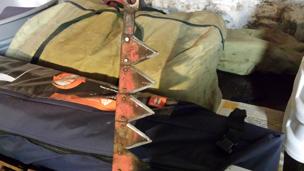

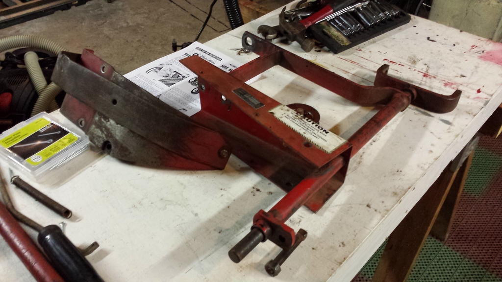

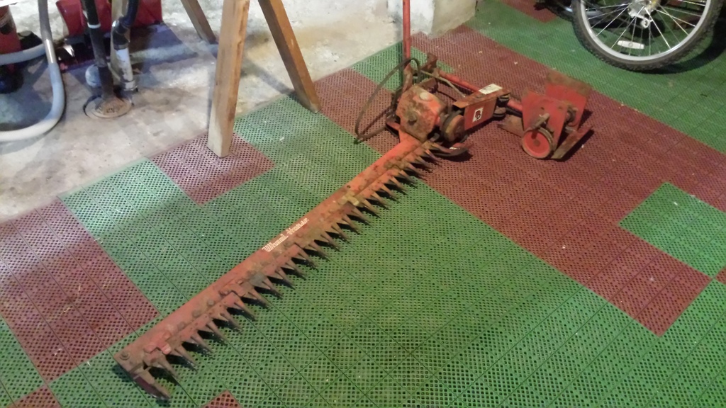

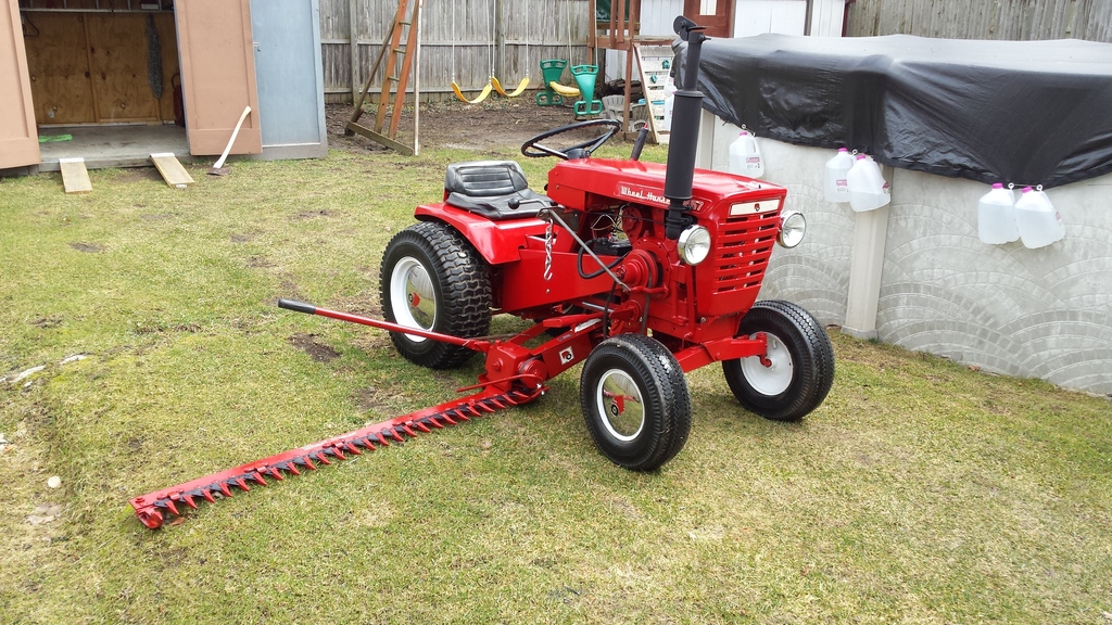

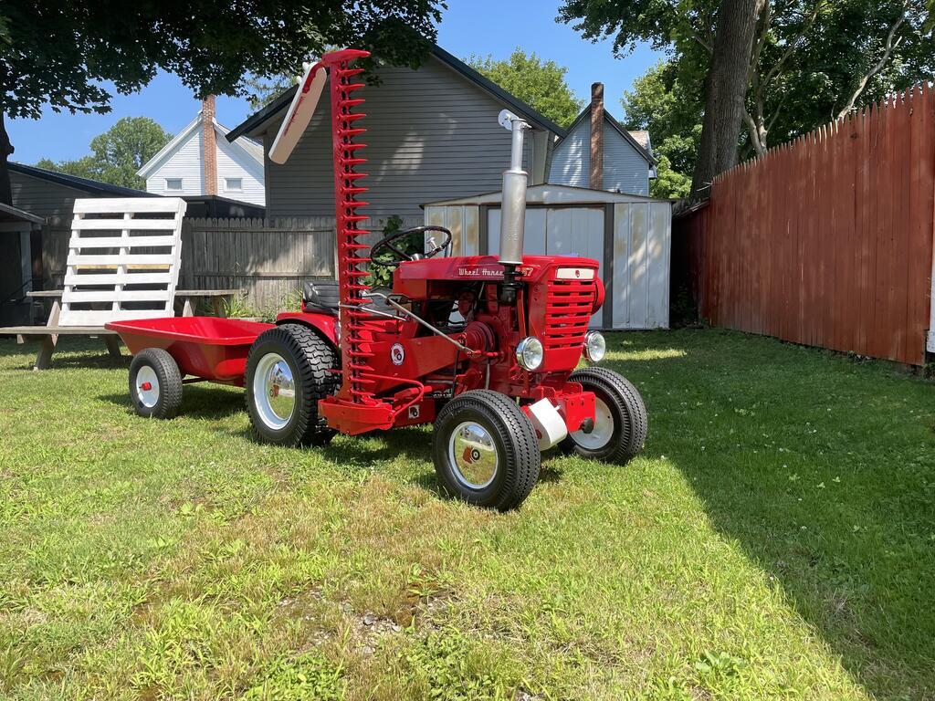

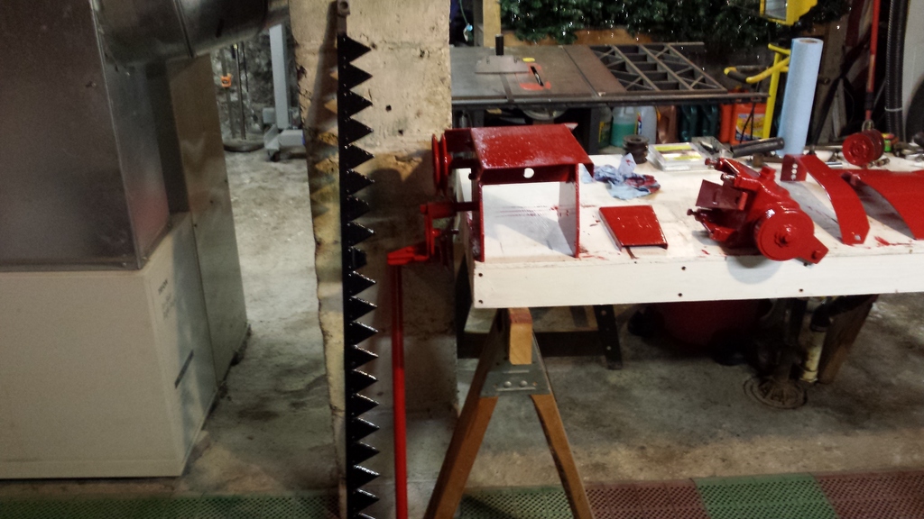

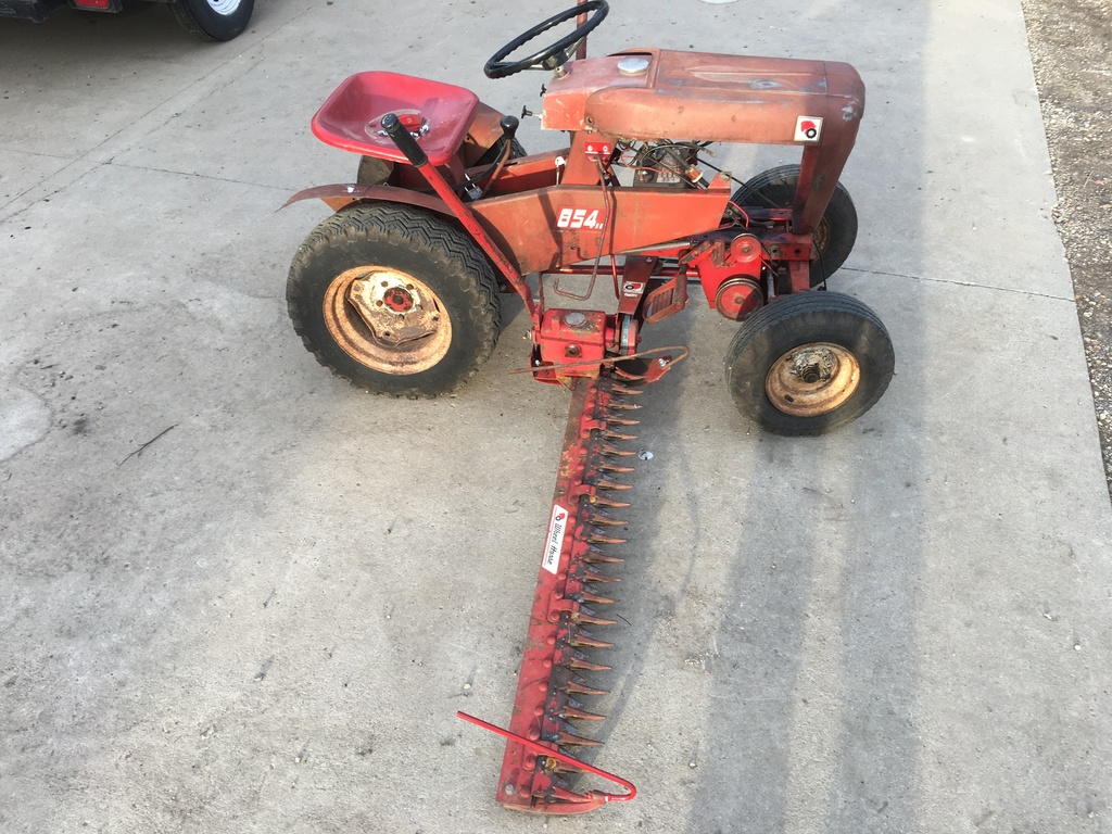

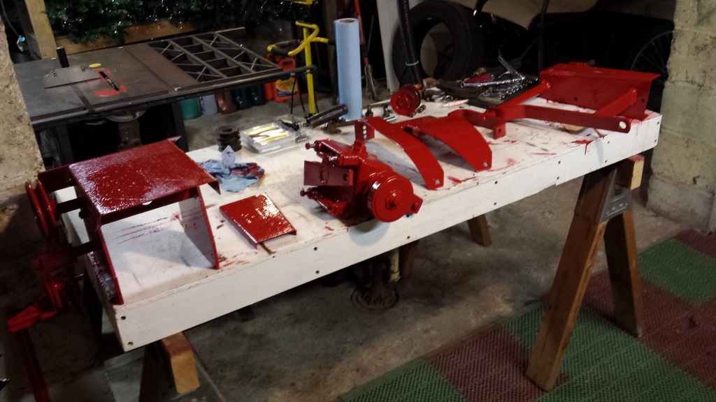

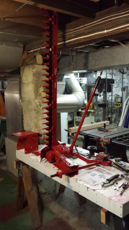

Thegearhead0324 1,265 #1 Posted April 4, 2017 Now that I'm able to post more pics, here are some from the sickle I did last month. 19 2 Share this post Link to post Share on other sites
KC9KAS 4,744 #2 Posted April 4, 2017 That is sharp...sorry for the pun! 3 1 Share this post Link to post Share on other sites
Thegearhead0324 1,265 #3 Posted April 4, 2017 Thank you, this was probably my favorite project so far with the horse. It was worth the drive, money, and time. I love it 3 Share this post Link to post Share on other sites
farmer 1,078 #4 Posted April 5, 2017 Ooo I like that, one of those attachments that just look right on a and you've done a spot on restoration on it. I can almost smell that fresh cut grass falling in the hay meadow. Tell me did it have a swath board originally or not? 2 Share this post Link to post Share on other sites
Thegearhead0324 1,265 #5 Posted April 5, 2017 No swath board, although not a bad thought. That how I felt about these attachments when I first became a member on here and looked through all the attachments out there, just had to have it they look sharp in general. I kinda wish I kept the original patina of it... but wanted it to match the tractor. 2 Share this post Link to post Share on other sites

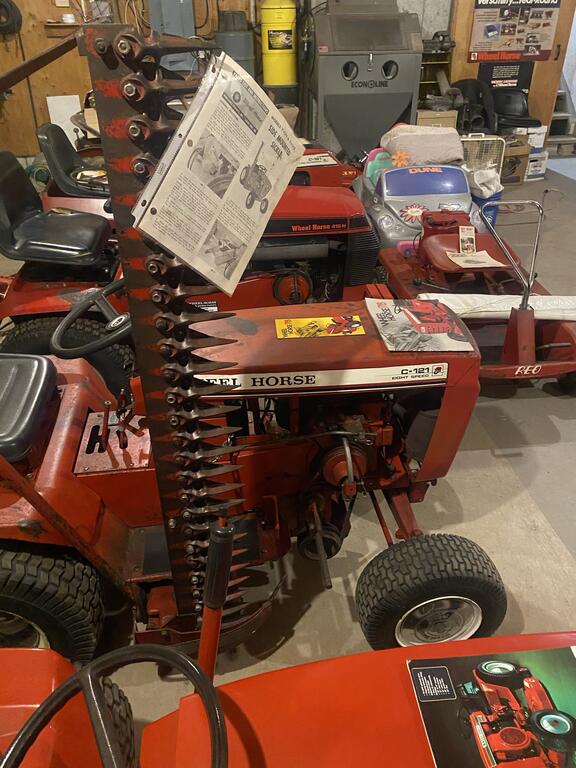

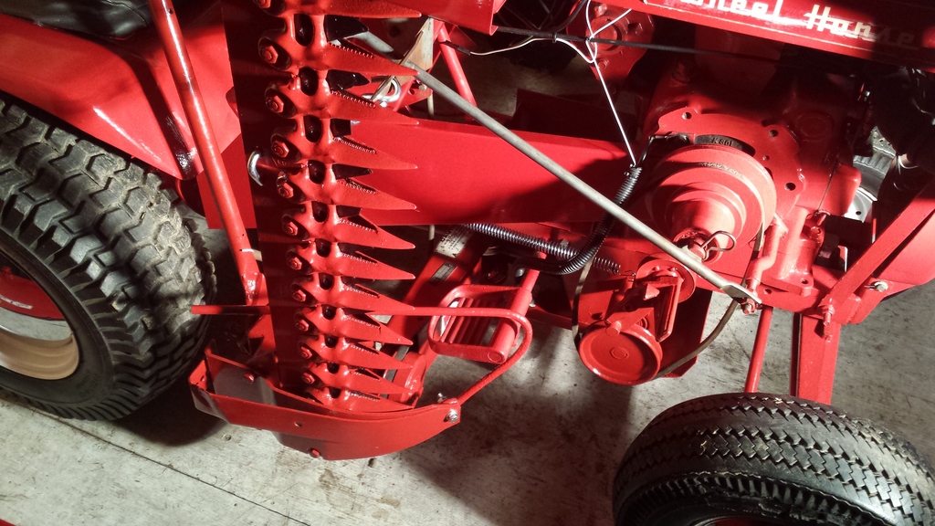

wheelhorseman 3,215 #6 Posted April 5, 2017 (edited) 11 hours ago, Thegearhead0324 said: No swath board, although not a bad thought. First off nice job on the sickle mower-- it looks nice! Ironically @Lane Ranger and I have been talking about this very thing lately. Wheel horse does not show any swath board or rod in the parts breakdown however in the picture right above the parts breakdown in the manual there is a picture of the sickle mower with a swath (rod) attached..... very odd. So I went ahead and made one for mine although I think I will make another one a little longer. Here are the pictures of the manual and of my swath rod that I made. Edited April 5, 2017 by wheelhorseman1000 2 Share this post Link to post Share on other sites
Lane Ranger 11,125 #7 Posted April 6, 2017 (edited) Thegearhead0324 : What model tractor do you have your sickle mower mounted on? And is that a 42 inch sickle? Also Lowell is being shy -but ask him about his recent sickle parts production ! Edited April 6, 2017 by Lane Ranger 2 Share this post Link to post Share on other sites
Thegearhead0324 1,265 #8 Posted April 6, 2017 (edited) Mine is model number 7 1312 7, 50 inch bar, mounted on my 1257. It fit my horse like a glove luckily for me. I was looking at swath boards online, but only saw the rod like you have and mentioned. Looking at the picture above kinda wish I kept it the original patina lol. And it's great about the sick parts production we all need them! Edited April 6, 2017 by Thegearhead0324 3 Share this post Link to post Share on other sites
Thegearhead0324 1,265 #9 Posted April 6, 2017 Actually.. kinda got me thinking about making my own swath board... hmmmmmmmmmmm. 3 Share this post Link to post Share on other sites

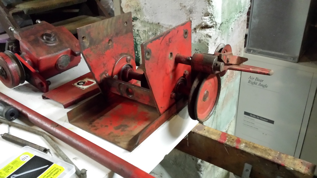

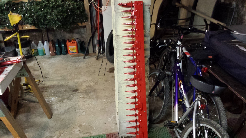

Thegearhead0324 1,265 #10 Posted April 7, 2017 Forgot to take a pic of it down. 4 2 Share this post Link to post Share on other sites

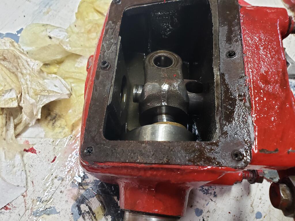

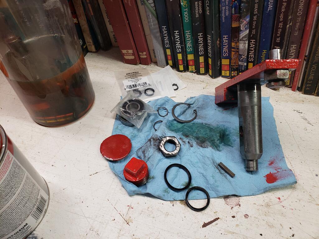

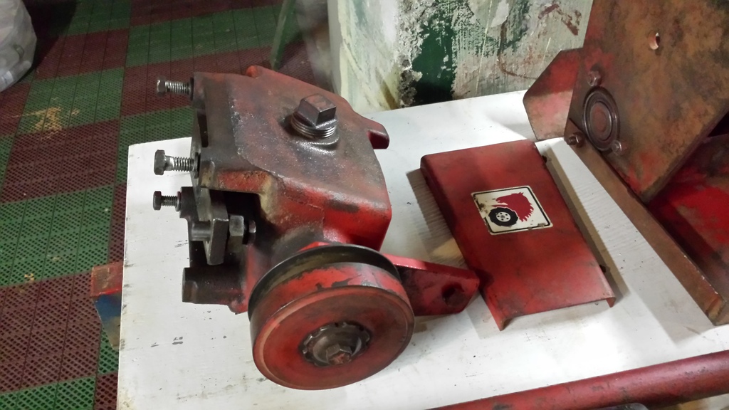

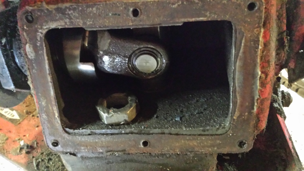

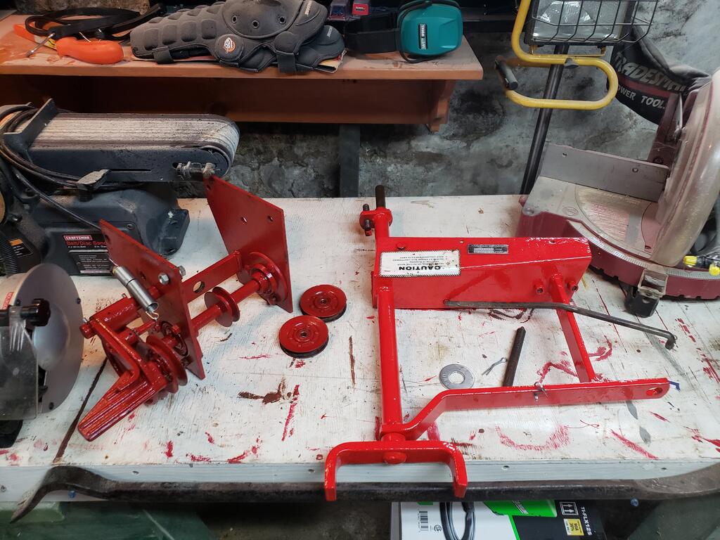

Thegearhead0324 1,265 #11 Posted January 26, 2023 Random I know, but reviving my old thread i started years ago. I eventually did make my own swath board. I also rebuilt the wobble box again few years back with new seals bearings and jam nut. 3 1 Share this post Link to post Share on other sites

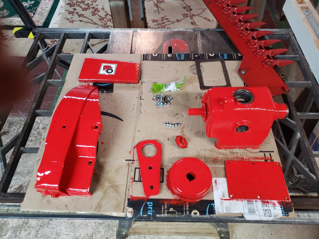

Thegearhead0324 1,265 #12 Posted January 26, 2023 Hopefully the pics I found of it all laid out helps someone when trying to rebuild theirs. Everyone on this forum has helped me all the years I've been a supporter here. Without this "supporting family," I'd have no clue on half of what I know now. Anyways, here are part numbers I came across ordering for the 1312 50" sickle bar: 100963 seal, 103118 seal, 6203 RSJ bearing, 203FF sealed bearing, 3/4x16 jam nut, #10 24 x3/8 cover bolts. 2 Share this post Link to post Share on other sites
peter lena 9,092 #13 Posted January 26, 2023 @Thegearhead0324 nice job on that ! have to ask what did you use for a lubricant / grease on all moving parts ? typically that shuttle box and related pulleys , give it up from lube failure . found freeing up and detailing attachments , pulleys / drive set ups, makes a real difference . pete Share this post Link to post Share on other sites
Thegearhead0324 1,265 #14 Posted January 26, 2023 6 minutes ago, peter lena said: @Thegearhead0324 nice job on that ! have to ask what did you use for a lubricant / grease on all moving parts ? typically that shuttle box and related pulleys , give it up from lube failure . found freeing up and detailing attachments , pulleys / drive set ups, makes a real difference . pete Fluid film is my all time favorite lube, use it on everything, even as undercoating for my truck. Besides Lucas red and green greases, fluid film is great. 1 Share this post Link to post Share on other sites

c-series don 9,445 #17 Posted January 27, 2023 The wobble box on mine leaks and I keep thinking about rebuilding it. I was thinking about loading it up with corn head grease but I’m not 100% sure that’s a good idea? 2 4 Share this post Link to post Share on other sites
Pullstart 64,592 #18 Posted March 29, 2023 Sweet thread! @Thegearhead0324 @wheelhorseman what is the purpose of a swath rod or swath board? Does it push the next row away, in preparation for laying down clean? Indicator of sorts? 1 Share this post Link to post Share on other sites
Thegearhead0324 1,265 #19 Posted March 29, 2023 (edited) Yes indeed. The swath board rakes a little bit of the cut hay away from the uncut hay. Keeps the cut hay from getting tangled on the inside end of the sickle bar on the next round. I made mine that’s on the end and painted it to match along with a decal, for the cool factor. Edited March 29, 2023 by Thegearhead0324 1 Share this post Link to post Share on other sites
wheelhorseman 3,215 #20 Posted March 29, 2023 (edited) 1 hour ago, Thegearhead0324 said: Yes indeed. The swath board rakes a little bit of the cut hay away from the uncut hay. Keeps the cut hay from getting tangled on the inside end of the sickle bar on the next round. I made mine that’s on the end and painted it to match along with a decal, for the cool factor. and the funny thing is, they do not list a swath rod in the parts manual, but it is shown on the front cover mounted on the sickle mower Edited March 29, 2023 by wheelhorseman 1 Share this post Link to post Share on other sites
