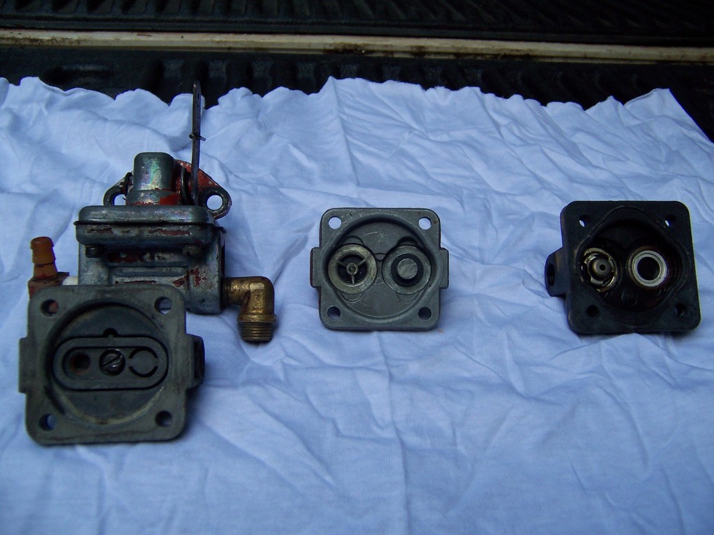

If your engine is Spec #71311 then you have a mechanical fuel pump (little square box) and it sounds like it has gone bad.  is it Plastic or metal.  Metal you can rebuild plastic you replace.
   :text-imsorry:          Have no idea what motor you are working with, based on description I figured it was one of these.

Different from pic just square brass fittings were hose hooks to pretty sure its metal  there is a plate on bottom two screws  if i can rebuild were can I get rebuild kit???
You can buy rebuild kits for the fuel pump, but a low pressure electric fuel pump can be nhad for a lot less and work better, mount it lower than the tank. Yours probably looks like these.

There are two check valves in the top plate, where the hoses connect. they will start leaking by and you don't have a prime when you try to start it, electric is the way to go. Then and mow auto on the internet sells rebuild kits or you can get a new one at NAPA if you want.
