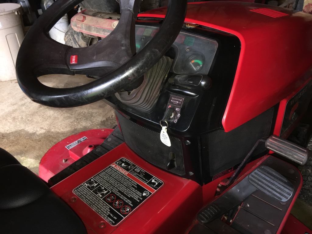

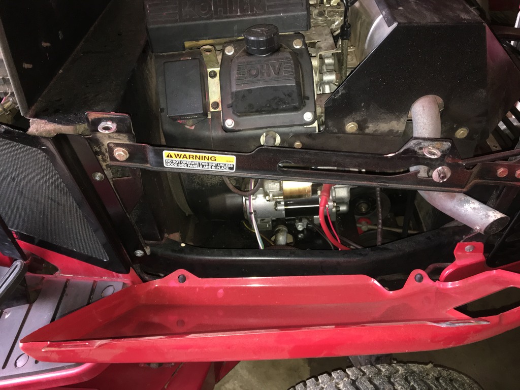

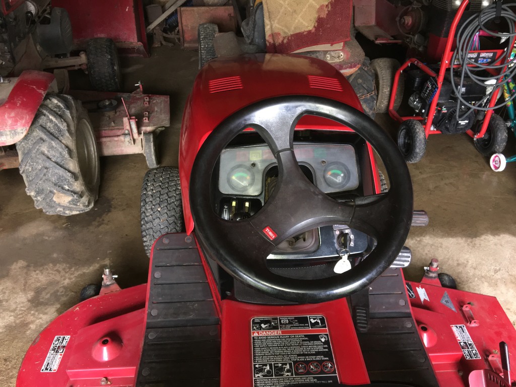

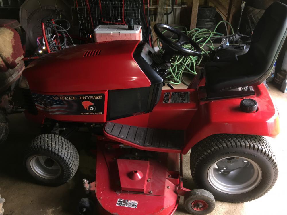

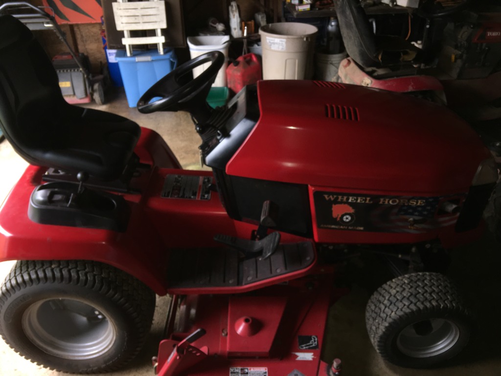

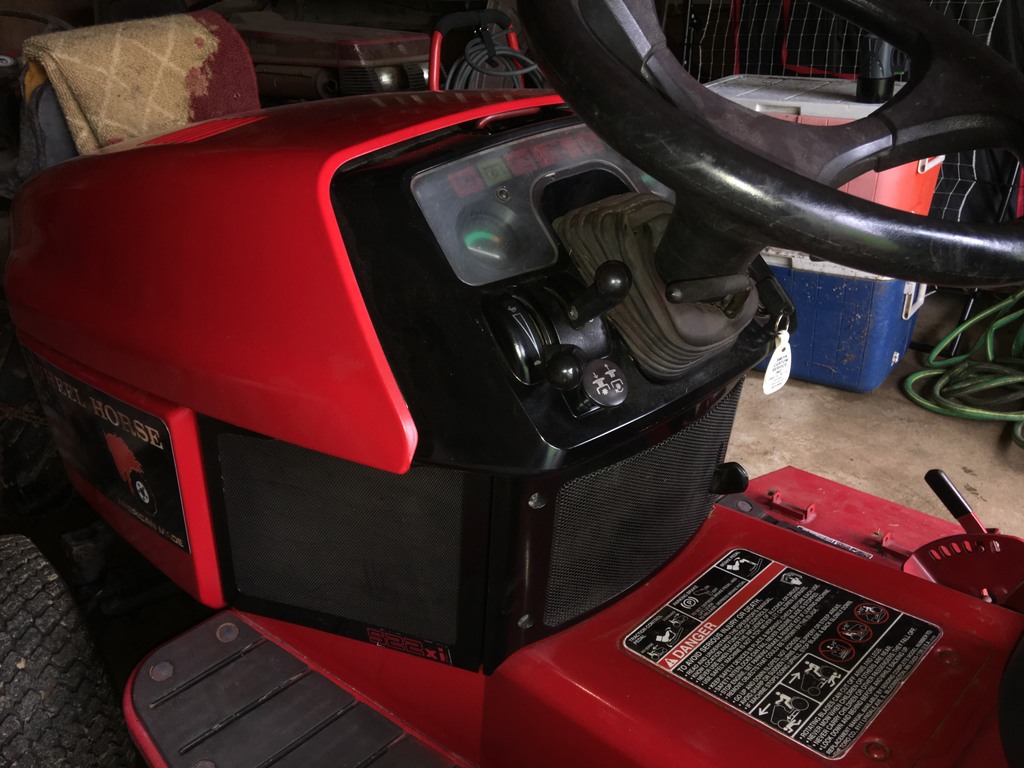

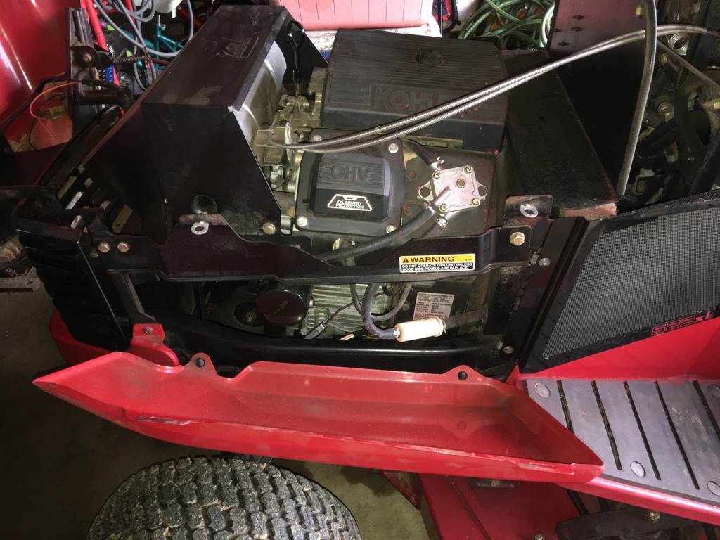

I picked up a Toro, Wheel Horse 522xi but it doesn't have a model or serial number ID tag on it anywhere?  Is there any feature or something to determine the year and other ID?  I have the engine data: Kohler mod CH22S, Spec 66545, disp 624, serial number 2813615731.  It has tilt steering, high/low hydrostatic drive and a 60" deck but the deck ID tag is missing the 2/3's of it that had it's model and serial number.  Pictures attached:

:text-welcomeconfetti:   Very clean looking tractor - someone will be able to help you shortly....lots of good info on this forum..:)
JERSEYHAWG /  Glenn
:text-welcomeconfetti:      :wh:.   I guess the person you got it from didn't know ?...Those are replacement decals sold by a vendor on this site. But sorry I can't help you identify it. Best of luck.
Glenn
Welcome to the forum.
Kohler built the 2813615731 serial number in 1998
Toro used the 66545 spec number 1998-2001.
Could be a 1998 522xi model number 73560. Use 8912345 for a serial number.
Could be a 1999 522xi model number 73561. Use 9912345 for a serial number.
Garry
WVHillbilly520H

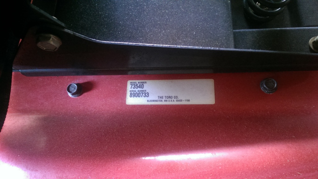

So between the seat mount and gas filler in the dip of the fender pan is normally where the model/serial tag is located, Jeff.
Don_G
Thanks everyone.  Really appreciate the responses.  Looks like the engine is the best match up for a 98 or 99.  Just changed the hydro fluid and it looks like it's been a long time between changes.  The filter actually had some rust on it.  Runs and sounds fine except my 520H runs faster in forward so I might have to check out the speed controls.  The engine doesn't seem to run as high an RPM as the 520H but I'll just have to check everything out.
WVHillbilly520H: yeah, there isn't a sticker anywhere on it.

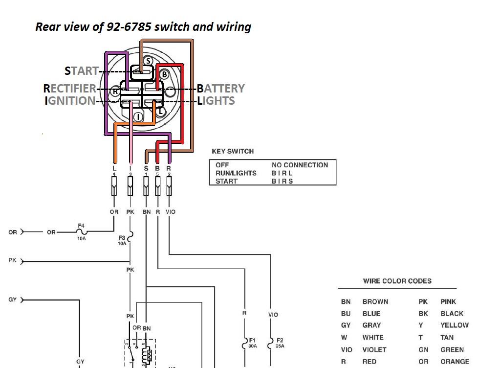

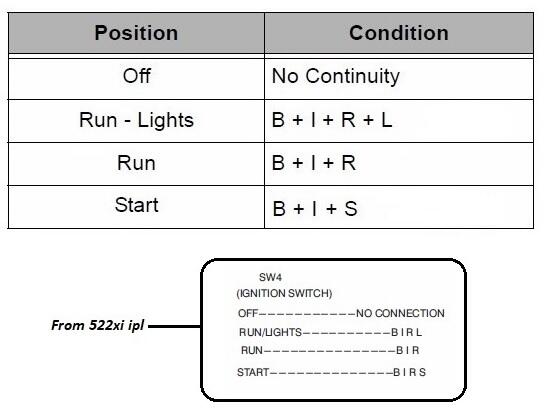

Garry I'm concerned with the config of the 92-6785 switch. The configuration letters do not match mine. Could they have just changed the terminology when they replaced the 101917 switch.
Have seen notes where some switch terminals are not properly identified but not on the 92-6785 switch. In those cases the switch function was to be compared.
Added some color to the wiring so you can compare with what you have. The wiring I used is for the 2002-2003 522xi.
Have noticed the switch function tables from early to late do not match for the 92-6785. If you happen to discover which is correct would like to know.
The 101917 switch was used 1970-1974.
The 92-6785 switch shows up 1994 and later.
Garry
