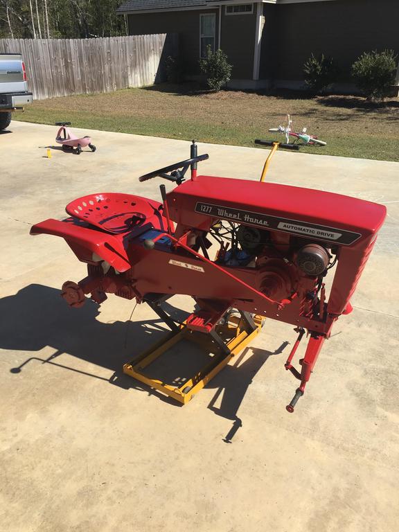

I am currently towards the end of a 1276 restoration project, I just got everything back together and sent power to the transmission for the first time. Without the pump on and the gear in neutral, I can spin the axels by hand, one goes one way, the other, the other way, giving me indication that I don't have a differential problem. When I put power to it, everything appears to work as advertised, except when in gear I can stop the Axel from spinning with my hand, little to no resistance. I do have a bit of a rigging problem from worn linkage, but I can move the cam by hand to get it fully in gear. The tow gear in completely closed. Just flushed and filled with fluid. I have not changed the filter.
Any idea on why there seems to be no power in the axels??

My guess would be that you opened the "Tow Valve" at some point and have not re-closed it.

After reading through these forums, the first thing I checked was the Tow Valve. It was completely closed, I then opened it and reclosed it to verify. No joy.

Did it work OK before you flushed it?

When you grab the one axle by hand, does the other axle speed up ?   If 'yes', then I think that's the way the differential is supposed to work.  It is not a 'limited slip' differential on the 1276.  If you can stop both axles by hand at the same time, then you have some other problem.   I have a 1076, but have not taken the trans apart, so someone more experienced might correct me.

So, I think you are saying this was not a working transmission when you got it and a flush and refill did not fix it.
Can we assume the input pulley key is OK and the pulley is not slipping on the input shaft.
What was in the unit when you drained it...oil or ATF?
What did you fill it with?

Jim is on target here.  From your narrative it is unclear if you tried stopping both axles simultaneously or just held on to one....
Sarge
As long as the tires/wheels aren't loaded with weight - it should be pretty easy to stop one wheel on that trans model - it's an open differential and the early bevel gear design , like used on cars/trucks . Specifically , it's a simple 2-pinion of sorts and uses some pretty heavy bevel gears . In all the years I've had my 1277 , not one problem with that differential and I've pushed it well past reasonable limits - broken the frame mounting plate three times now with heavily loaded tires , lol . Biggest no-no with that style differential is to allow one tire to spin at high speed , then suddenly stop it on bare pavement or something - in a car , that results in an exploded diff gear in a hurry . Learned that lesson the hard way in my first car but the old Dodge was an easy fix .
The biggest thing you need to test is the strength of the Sundstrand pump and hydro motor that drives the transmission gears - when it's up to full hot temperature it should still easily spin the tires if it's in good shape . Don't be afraid to flush a couple rounds of oil through the trans along with a new filter each time to get any sludge out and dirt - keep it dead clean or trouble will result . Hopefully the intake screen isn't plugged or broken off - that spells death for some of the pump parts and @daveoman1966 has done some nice detailed posts on that model as to rebuilding the pump . It should be using regular ATF fluid , but some were changed later to motor oil so pay attention to what was in it , color and odor - ATF has a very distinct odor and easily detected , even when very old . The biggest issue with the Sundstrand was how previous owners took care of them , or lack thereof ...most never got their yearly oil change as specified in the manual .

I got the wheels on today and fired her up. She ran flawlessly for about 15 minutes. The transmission issue I am having just seems to be a simple rigging problem as the cam seems to be warn. But none the less the transmission is strong as a bull!
