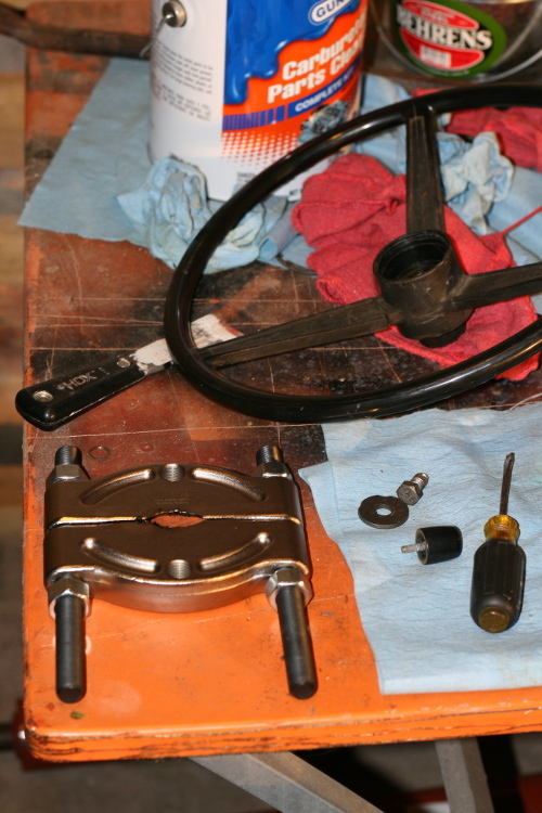

Thanks for the suggestion to use a bearing splitter to take the steering wheel off, whoever that was. Like Butter.

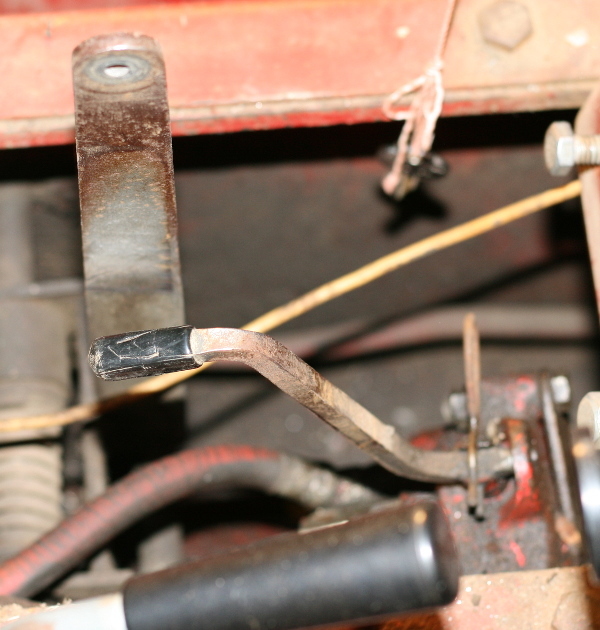

Check out my weird hydraulic lifter lever. What is the real one supposed to look like and where can I get/make one?
Strange, that seems to be the correct part, at least for a 1971 GT-14. I wonder why it does work right, or why it doesn't go down far enough for the float detent... must investigate....
The picture in the owners manual shows it with a round knob on it.....
oldredrider
If I remember correctly,  only the '69 had the ball on the lever. Also, your spool valve may have been replaced at one time with one that doesn't have the float funtion...like mine. I have the correct one on the shelf if you're interested.
FatJackDurham
I think this is the correct one. It looks like the diagrams in all respects, and when I removed the center console panel, the shifter goes into float just fine. It's just that when the panel is on it doesn't go far enough, like the lever is too loose, or bent or something.
I'll figure it out. It probably just needs to be loved into place.....
evanloock
Lever is correct.  May need to adjust float detent tension which is done with the nut near the bottom of the valve.
