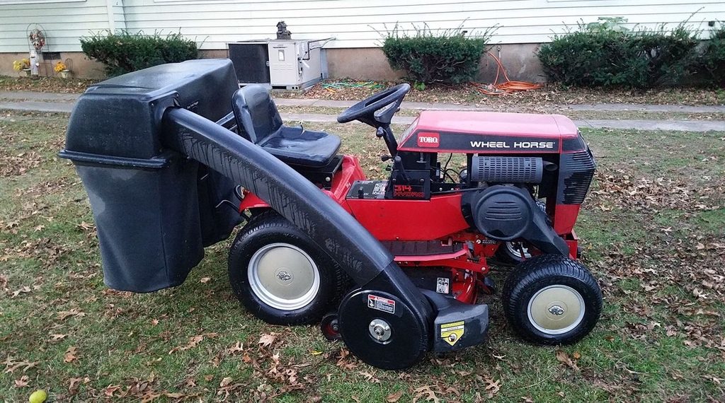

I have only owned a few weeks and have not really put it through the wringer yet. I changed all fluids and filters, and the spark plug and drained the fuel and replaced with fresh plus a bit of Lucas. Got the hydro topped off today (they take forever to fill) and decided to try out the bagger system on some leaves. Overall I'm impressed with how quickly I got one bag half full (about 10 minutes) but I noticed that it was very slow going up a very moderate incline and also noticed that the hydro was squalling while raising and lowering the deck and when engaging the PTO - surely this isn't normal operation right? less than 500 hours, appears to have been very well maintained and the engine sounds fantastic otherwise. Any ideas? I had mentioned in a previous post that it seems very slow in forward gear - it seems like almost the same speed as reverse gear. Thanks in advance guys! I know you wont let me down.

How does the belt look?

the belt that runs the bagger attachment is not good - its split pretty good in a couple spots - I was going to just change it but thought I would see how long it would last me. Would that really cause all that noise? It sounds more like its coming from the hydro itself but I could be wrong

Sorry I meant the hydro drive belt,  if it is slipping there could be an issue
Ed Kennell
Yeah, let's hope it is not in the hydro.     Some possibilities that would cause noise and slow speed are,  Llike Adam said, the drive belt. the idler pulley, the key in the hydro drive pulley.
Pull the belt guard off and check these things .   The motion cam could also cause the slow  speed problem, but not the noise.  Do you have the noise when the PTO is not engaged?

I ran it again and its worse - not so much when engaging the PTO - just when going forward and reverse with nothing engaged - Ill try to check those things in a bit. What exactly am I looking for? This time around it barely went forward at all. Really hoping I didn't get taken to the cleaners on this one

I did notice that the hydro drive belt seems loose. Does it only tighten up when the drive is engaged? And wouldn't I need to pull the back right wheel off to get a look at the pulley? Sorry for all the questions. I have zero experience with these

To test the hydro, I would chain the tractor hitch to a tree.   Remove the belt guard.  Start the engine and engage the hydro.    Then slowly move the motion lever forward.  A good working tractor will spin the tires.    If this doesn't happen,  there are many reasons.  1.  The belt may be slipping on the PTO or hydro drive pulley.  2. The belt may be turning the hydro pulley but the pulley is slipping on the shaft due to a sheared key.  Look at the center of the pulley and make sure they are spinning at the same RPM. 3.  hydro axles may be turning, bot one of them may be slipping in the hub due to a sheared key.  Look at the center of each hub and make sure one of them is not spinning in the hub.  Check both of them as only one needs to be sheared.
If the tractor does spin the tires, but at a slow speed, there is probably a problem with the motion control lever linkage and / or cam.
If the hydro input shaft is turning at the correct RPM and neither axle is turning,  there is probably a problem inside the hydro.

Ok, bear with me here guys. I'm still learning. What exactly is the "cold start clutch" or as the manual calls it, the "cold start lever?" I put it in the down position and the tractor ran fine. Does this lever engage the hydro? If that's the case why would it run at all when in the up position (de-clutch)? Also, I tried the hydro test hooked up to a tree. Only one tire spun. Does this indicate a possible problem? Would a strong hydro spin both back tires? I know these are dumb questions but I'm willing to ask them. Maybe the next newbie won't make the same goofs I have.

Pushing the lever down engaged the hydopump by pushing an idler pulley against the belt tightening it. Pulling it up takes the idler pulley away from the belt and it should stop turning the pump.  Do you have the belt guard  mounted?  There are guide pins on the engine that help the belt disengage they may need adjusting if the tractor will move when the lever is pulled up.
Spinning only one wheel is normal you have an open differential.

Ok, I put it in the down position and the tractor ran fine. Does this lever engage the hydro?
Great, this is good news.  A much better solution than rebuilding the transmission.  :rolleyes:  Yes, like Paul said, this lever releases  the idler pulley so a spring can pull it against the belt to tighten it against the engine and transmission pulleys engaging the transmission.
I am surprised there is no decal adjacent to the lever with instructions on how to engage the transmission.
