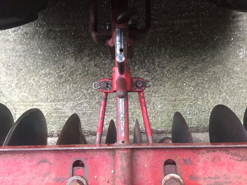

farmer 1,075 #4 Posted March 23, 2017 Pretty sure it's cast, it slides on the towing bar and should have two rods linking to the disc gang (one for each gang). Share this post Link to post Share on other sites
can whlvr 993 #5 Posted March 23, 2017 thanks farmer,i needed that pic for that part,mine doesn't have one at all,and its the other end of the rods where the eye is broken,on one of the towers or what ever its called 1 Share this post Link to post Share on other sites
