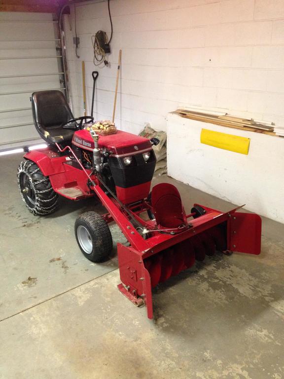

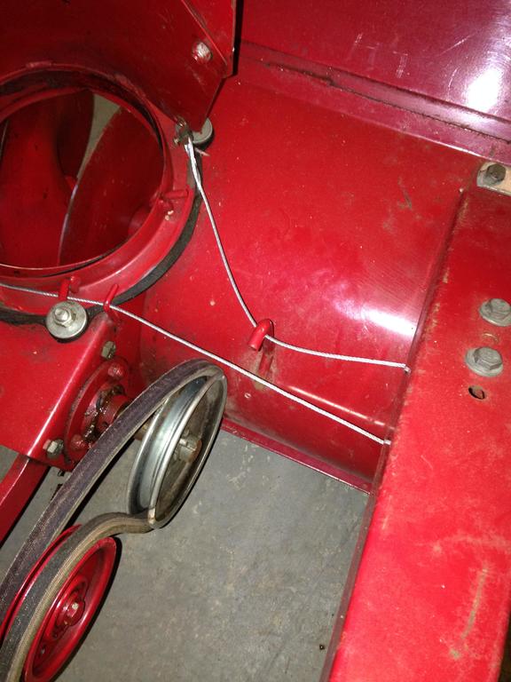

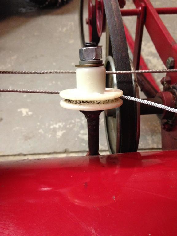

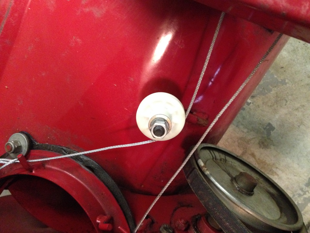

Small snowblower mod
JERSEYHAWG /  Glenn
Nice idea on the modification.
Glenn
857 horse
Looks pretty Laget to me,,,,,,,I like it !!!!!

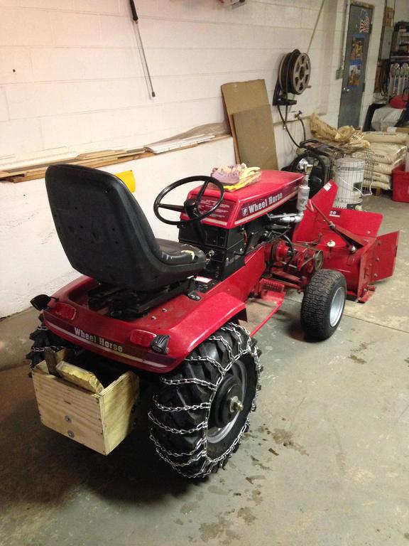

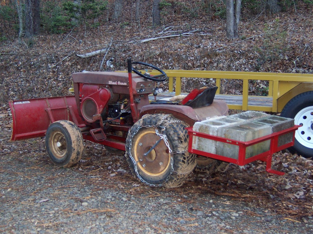

 Any idea how much weight is ok on the rear hitch?
We have had this conversation several times here, no conclusive answers. I have a 2" hitch receiver bolted to the rear end and hang a couple hundred pounds off it.

Loaded tires, outside wheel weights, inside wheel weights, hitch weight, transmission damage, axle bearing damage.....Do a search and  you will find TON of opinions.
IMO,  do it all.
  • Like 6
roadapples
@aHorseofCourse The Wheel Horse manual for installing my Ark loader says with wheel weights you can put 250lbs in ballast box. 350lbs without wheel weights. Any more could harm transaxle. That is from Wheel Horse themselves....by the way good idea on the blower..:handgestures-thumbupright:
Edited by roadapples
  • Like 6
Ed Kennell
Looks like I'm right on the edge Jay.   :wacko:

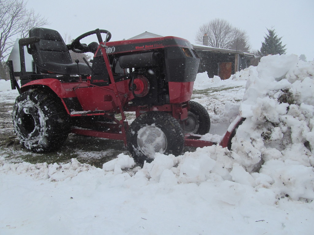

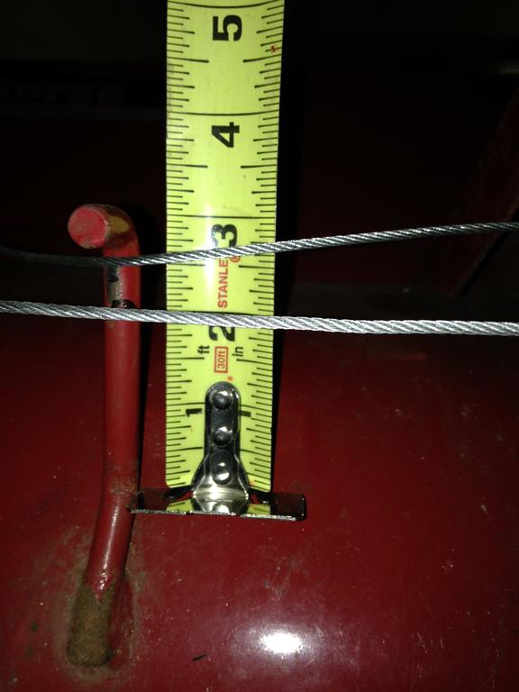

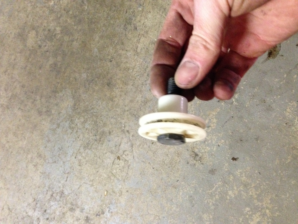

Thanks guys.  I hope everyone steals the idea as it seems to work really well.  I was afraid the cable might want to jump off the pulley but I used it all day in the ice storm and didn't have one problem.  I'm thinking of getting one of the hitches the vendor on here sells and making a bigger weight box.  That seems to spread the weight out more than on the factory tow point.  Will the single stage blower fit with a forward swept axle?  Thinking of doing the conversion but if my attachments won't fit I might not.

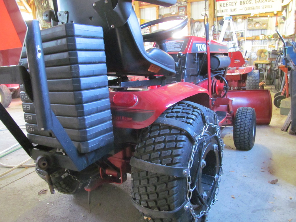

How well do those rubber chains work?  My metal ones are scuffing up my driveway
Ed Kennell
I bought this 312 with the rubbers already on it and I almost took them off as I have always 2 link Vee bar steel hooks on my snow movers.
Luckily we got a snow and I had an occasion to try the rubbers a few years back.  I was amazed at the traction especially on paved driveways.
With the steel hooks and blower on the 520, I had trouble getting up my steep driveway with the blower raised and  no snow on it.
With this 312, I can plow up and down with no concern even if a wheel would slip.

Several years ago, after the wife complained about the driveway marks on the asphalt,  I invested in the rubber chains. Cost $130, if I remember correctly. Resealing the driveway cost around $275 every couple of years.  Seemed like a "no brainer" to me.
Rubber chains work great for traction, even on dirt.  I will never go back to metal chains, given my experience.

I think that they would wear out real fast with just the area at each lug carrying the load.
Ed Kennell
I agree with Lynn.  In fact I believe all chains, steel and rubber,  last longer and are more effective on turfs where the full link length is making contact with the tire.
One other point, if the wheel spins, I believe  the rubber straps may actually twist into the snow creating a scoop similar to the cut bar on a pulling tire.

Yes very nice idea on the chute rotator & will steal as well. Stock on mine usually work just ok most times. A  roller for slide by closet & patio doors is common and can be had in metal with ball bearings.

The rubber chains are installed tightly with almost no air in the tire.  Then the tire is inflated to normal pressure.  Even with them being tight, the rubber cross straps tilt a bit and grab rather well.  I think they perform nearly as well as steel chains on a straight pull.   If you have a situation where a tractor can slide sideways, the rubber straps seem to actually make that worse.  I have taken a 180 on a short, steep portion of my driveway and now use more caution there.  One other negative is the rough ride, I believe another member is going to inquire about doubling up the number of straps.

The rubber tire chains, in my opinion, ride about three times worse than steel chains.  Steel chains can flex the tire tread a bit but the large rubber straps cannot.
