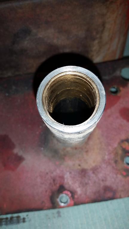

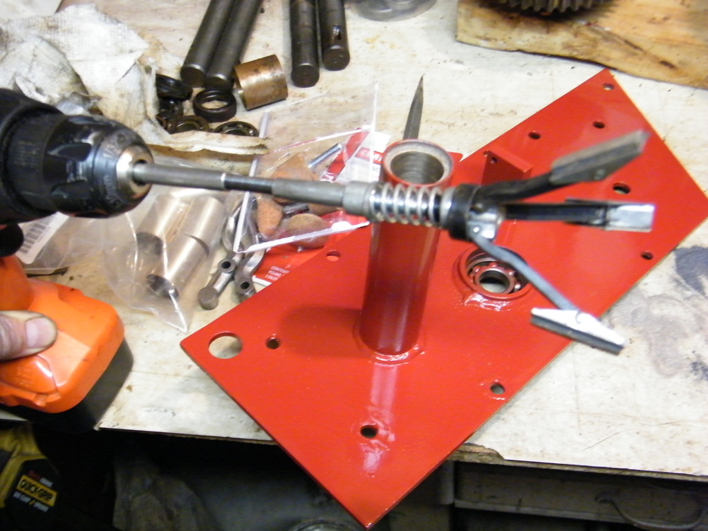

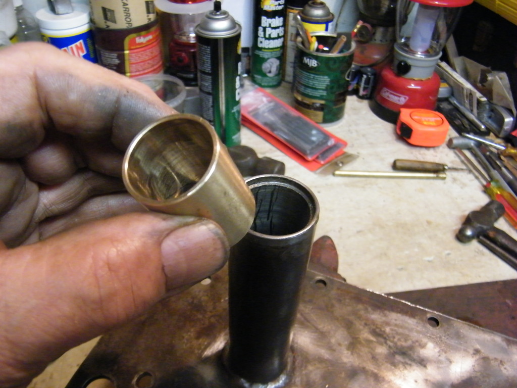

if you are replacing the bronze bushings in the axle tubes, you will likely have to hone them. I am rebuilding a 5010 and recently had to do that in order to get the axle shafts to fit. I used a hone for brake cylinders and that worked great. Read Stevasaurus thread on rebuilding these transmissions for all the info you need.

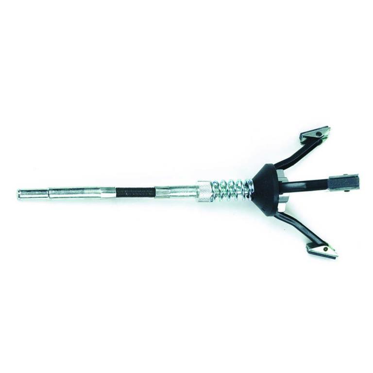

Slim, I read those threads back a year ago or so and am aware of the need for a hone. But, I'm curious as to what grit stones would be recommended? Looks like most brake hones from the auto parts store are going to come with 240.. This seems a bit rough to me... but then again I've never honed bronze before. Any thoughts are appreciated.

I dont think you have a lot of choices unfortunately. The fact that my honing tool even fit was good enough for me. I did not notice a excessive amount of material being removed during the process. It took me a good 1/2 hour to get them where the axle shafts fit. Maybe Stevasaurus will chime in since he did the thread that i read for my rebuild. I think you will be fine with a brake cylinder hone since they are more for finishing than boring. If you know a machine shop, that would be an option.
Racinbob
A brake cylinder is the way to go for me. It does take a while but the end results are great

I'm sure honing them will do the trick! But I can't help but be curious to know if the hone leaves the bearing ID surface rougher than required, causing wear on the axle. But, then again it's not like it will be turning 10,000 rpms. And the tolerances on this trans aren't too precise.
I heard that a mystical chart exists that will tell you what size OD and ID bearings to use so that you can achieve a perfect fit. Once pressed in the ID will tighten to the desired measurement, thus eliminating the need for a ream or hone. But of course I discovered this after I ordered the bearings!

Racinbob knows...You wont find rhe perfect fit John but any brake cylinder hone available at one of the popular auction sites work......most are 220 grit and will take abit with a cordless drill motor  but just hone away till you get a snug fit & rinse the the stones often. They do get plugged  with grit. They will be smoother than a baby's bottom when done. Flip your axles if they are rough, I would tell you how but @Racinbob might sue me for patent infringement! :ychain:

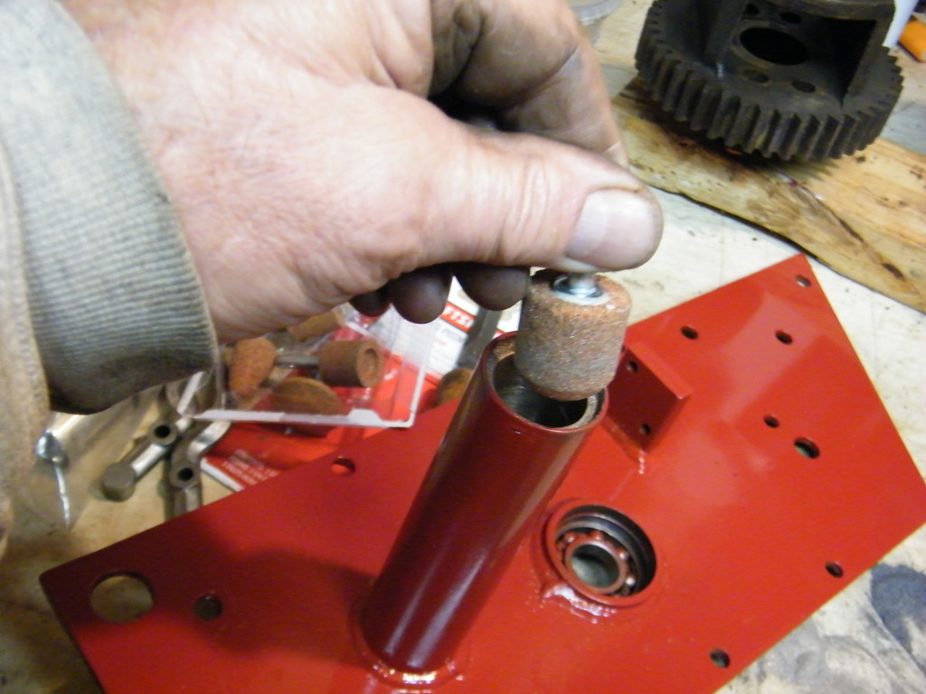

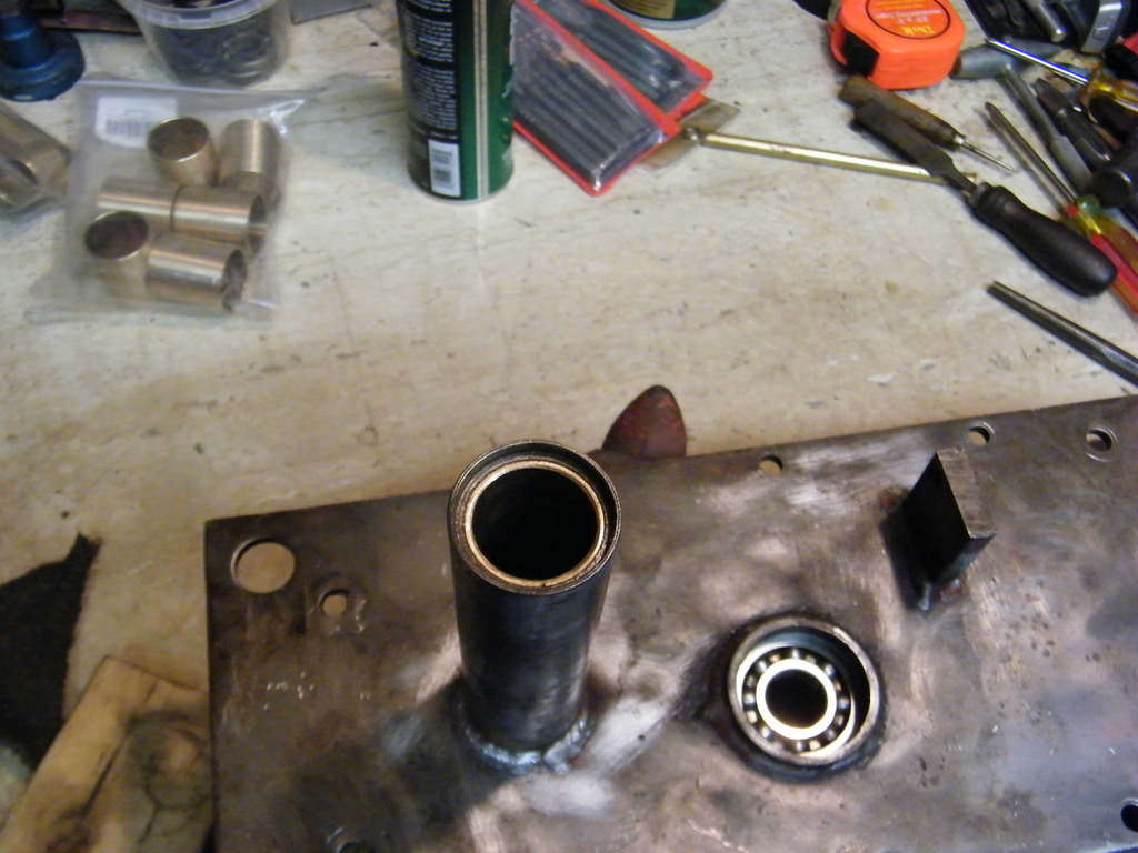

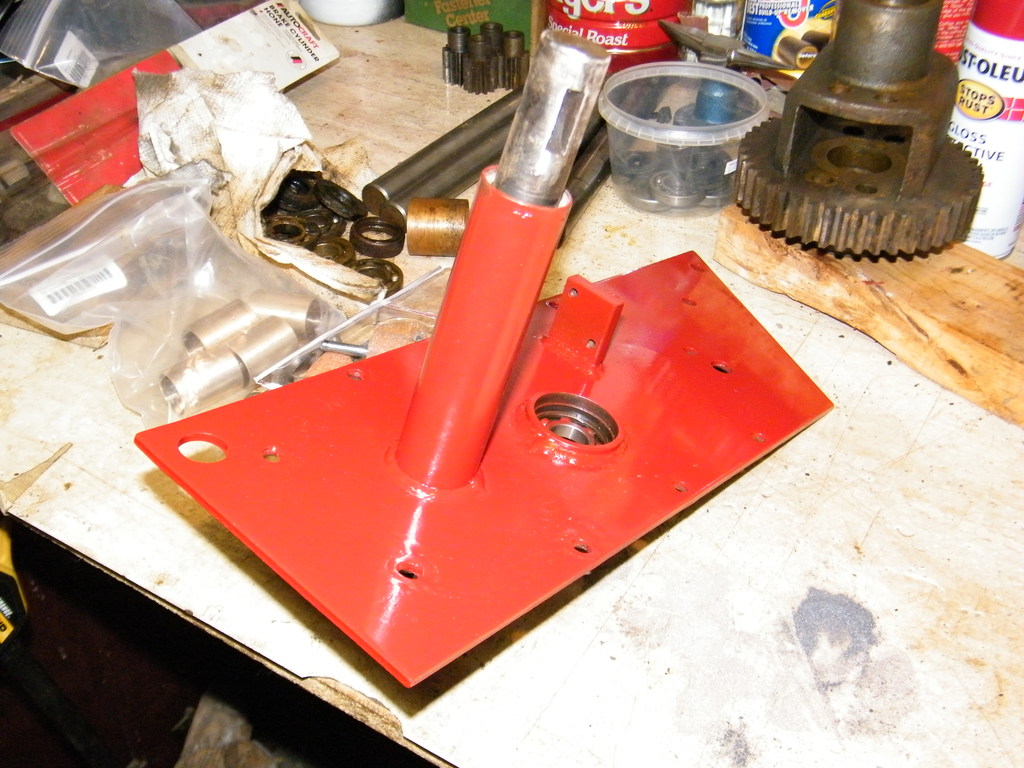

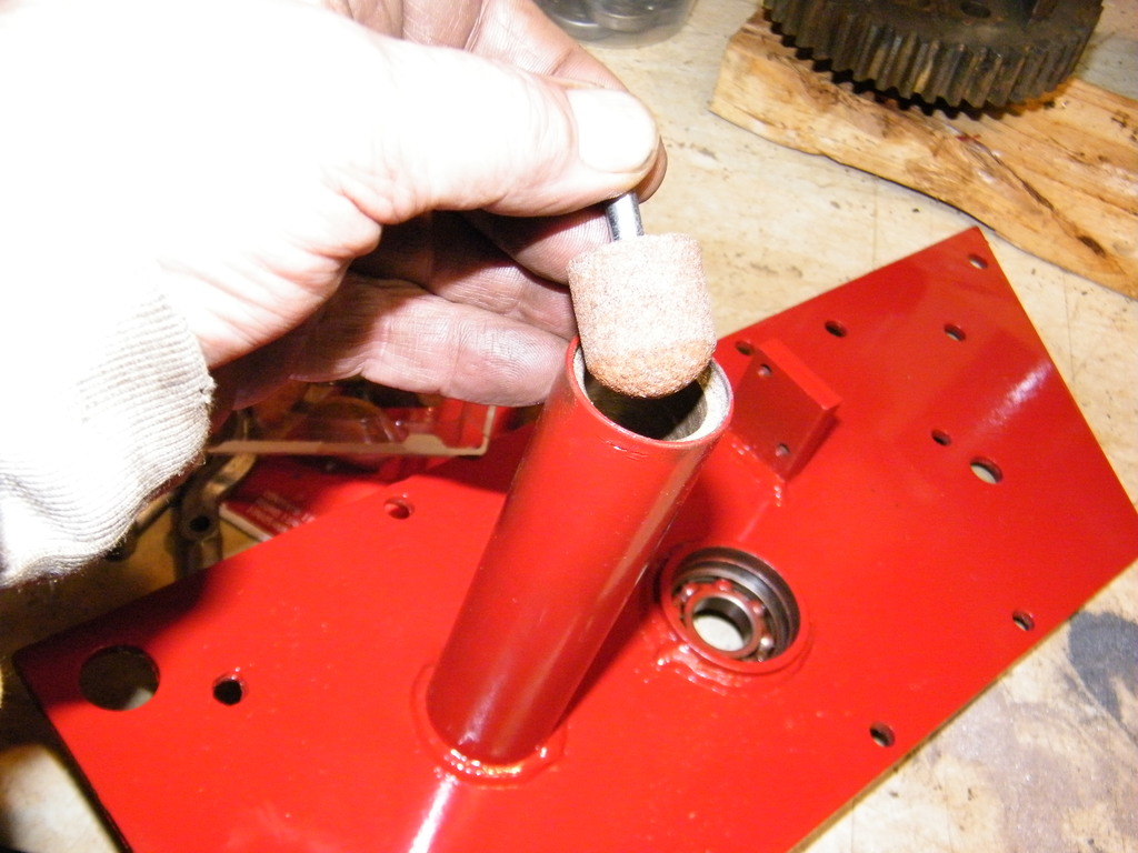

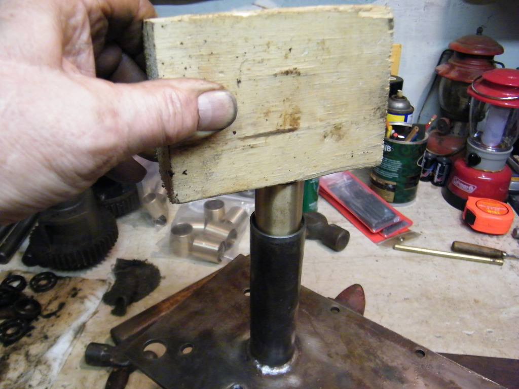

These 3 piece transmissions are fairly sloppy.  For that reason, I usually take some rougher sand paper and bend it around my finger so it fits in the axle tube.  Standing there for 1/2 hour with a brake hone is just not in my attention span.  I'll even use a 7/8" grinding thingy for a drill to speed up the process.  I finish with the hone to smooth everything back.  I stop a lot of times to check the fit with the axle, and work the area that is still tight.  Reaming with a 1" reamer would be the ultimate, but even with that you may want to open the hole a little more because of what happened to Bob.  I went through one that Stevebo rebuilt where the axles were binding and had to hone a little more slop in to the bronze.  Don't be afraid to make it a good loose fit...if it is too tight you will not know until you finish bolting it all together...and then you have to take it completely apart to fix it.  :)  I use the grinding bit on a vari-speed drill, and hone.
2008_0331LANE20001.thumb.JPG.9c47f401cda3fdbc35bd59f3b6344671.JPG2008_0331LANE20002.thumb.JPG.9b558380f61b673e3445b533c2f16db4.JPG2008_0331LANE20003.thumb.JPG.fc70a3d531d715696ba50b2715bce063.JPG2008_0331LANE20004.thumb.JPG.7790a1618e1a35372ddf3e417afffcf9.JPG2008_0331LANE20005.thumb.JPG.590a0791ac04c2d2e22a5229d08bd5f6.JPG
