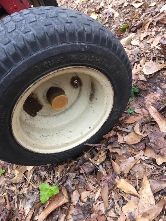

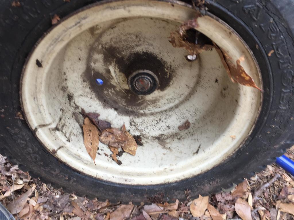

i am trying to get this model functionally working and the front wheel came off.  Does anyone know the size of the eclip for the front wheel and where to get a dust cover?  i thought the manual said it was a half inch but apparently i was wrong.  i assumed tractor supply would know and that was the second assumption i made.
Take the E clip off of the other side and the dust cap too if it's there. Take them to a Napa store or a good hardware store to match them up

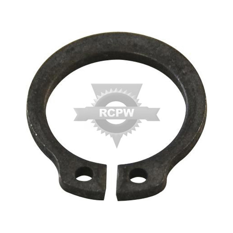

they are 3/4" e clips
The clip will be 3/4" as they are sized by the shaft size. Actual ID will be smaller.
They are a stamped ring so one side has rounded edges and the other side has sharp edges. In this case install with the rounded side against the wheel. With the groove in the axle cleaned up the sharp edge has more holding ability to keep the wheel on.
One of the vendors produces good replacement items

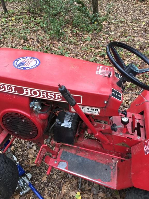

so the owners manual listed in hand 78 so. i assumed that but here are pictures if this helps for clarification
Are you saying you have a 1978 manual for a 1977 tractor? Can see the ID plate behind the lift lever. What is on it?
Garry
newtowheelsc
It's a 77 in the paper work i was left it was. handwritten 78 but it's defiantly a 77.  so back to the eclip i assume
