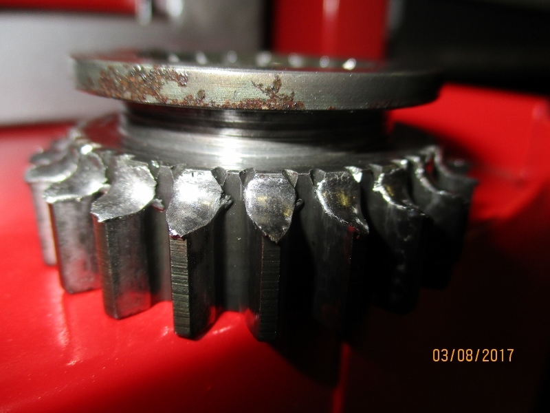

This is what happens without the belt guard ...
OUCH!!
Racinbob
Please listen to what the guys have told you. The drive belt MUST come to a COMPLETE stop before you shift. That it what the belt guard does for you. The gear shown looks like the 3rd/2nd gear and the damage shown was done by grinding it into 2nd gear. Look at the other side and you'll see the inner teeth (or what's left of them) that mesh with the input gear in 3rd. I can't show you a picture because the computer I have it on is 1000 miles away. That is by far the #1 cause of these transmissions slipping out of 3rd gear. It's a common problem and always caused by grinding the gears. Except for the addition of the hi/low ranges the newer transmissions aren't much different than the older ones. Both are very tough but grinding is abusing and abusing ruins things no matter how tough. :)

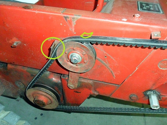

   When I built my custom low rider, I did not install a belt guard or tabs at the drive pulley, bit I did install several  support pins below the bottom of the belt and I  have the idler pulley belt keeper adjusted so it pinches the belt slightly  when the clutch is depressed.    It works great.    :twocents-02cents:
Needs to be at the top so it will grab the belt as it pivots forward, not like the one that is circled.
Ed Kennell
Exactly Richard.    I'm guessing the best position will be about midway between your two marks.   Best is to block the clutch fully depressed, then adjust the belt keeper so it pinches the belt in front of the pulley.   Then release the clutch and make sure it does not contact the belt as the one in your picture.
It should be noted that the belt has to be the correct length.  If it is too long, the keeper will contact the belt  at each end of the clutch stroke.
