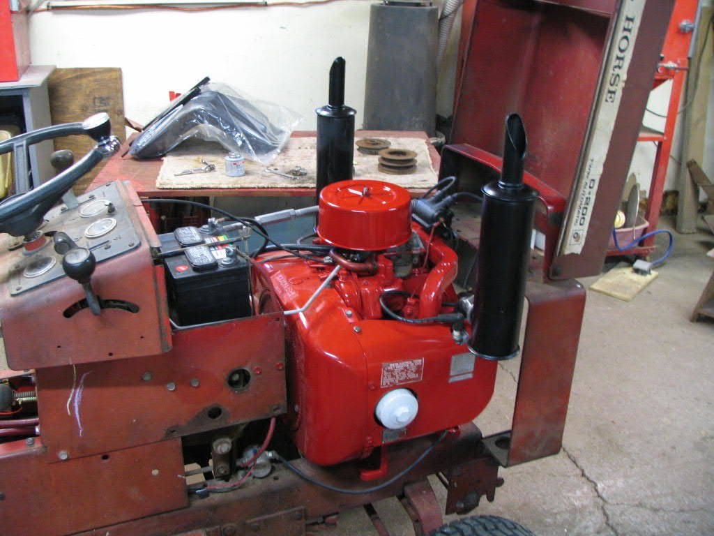

Dont think there are any sources that will have a factory type muffler... most of us have to fabricate a replacement - and they can vary quite a bit!:lol:
My first try at replacing them was on my D-180 and I went with a stock appearance using 2 mufflers that was similar to original and cut & welded them into fitting - while they turned out pretty well and sound good it was quite a project!! and I didnt want to do that again. So it came time to do something for the D-200 and I went for stacks -- that turned out much better!!
Sarge
I'm going that route soon as the weather turns , my D-180's mufflers are both rotting out and starting to burn the paint off the grill , not to mention they sound as bad as they look...
How did you route the piping to make them land at the point they are sitting ? Almost looks as if the outlets that are bolted to the engine could be swapped from side to side and make it easier to avoid the grill and hood...?
