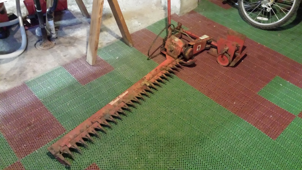

Hi all. Very proud to say I made it 6 hours round trip to pick up a sickle mower that's all original. Will post pics later on. Model number is 7 1312 7. Can't wait to start redoing it.

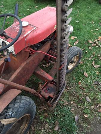

:scratchead: Is this the one?

Yea... especially in the same state. I saw one mounted on another tractor but it was in Ohio and wasn't driving that far. A gentleman saw my want ad 3 hours away and was nice enough to want to let it go. He also has a bunch more tractor parts, has a deck for parts, has alot of tractors and parts besides WH. Him and his wife were very friendly and very good people. Had to bring my daughter cuz she was sick so unfortunately it was a short visit. It was a good trip, good people, and good purchase. Can't ask for more.

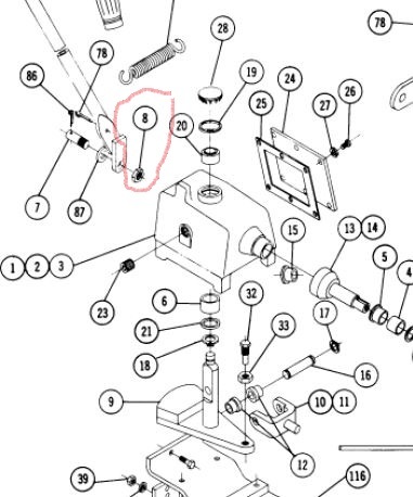

Found this before work this morning... don't know how or why it's in there... but nothing is damaged from it thankfully.
The nut goes on the end of the pivot pin that bolts on the opposite end of the pulley, inside the wobble box

Hmm... I looked all over, even in the diagrams and can't find where the nut goes.
Thegearhead0324
I looked at both the 42" exploded diagram and the 50" diagram, is there a way to point it out?
Shynon
Item # 7 is the 3/4" pivot pin and #8  is the nut inside the wobble box.

Ohh... you're talking about the handle pivot pin. I just looked and it was hard to tell because the pin is threaded so far out that it's just a hole looking from inside the box lol. Thank you for helping me clear that up.

Your welcome.....Just in case you don't have it already this is for the 50" but should be close.
Thegearhead0324
I got it thank you for pointing out the nut and location of it guys. I would have been clueless putting it back together all over a nut.

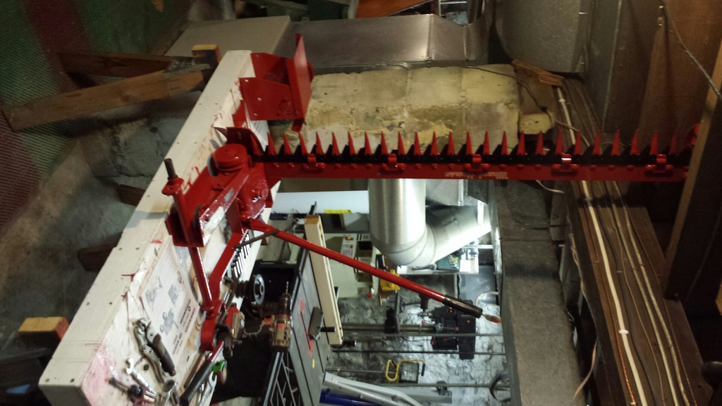

Unfortunately no pictures yet.... but I got it in pieces. Sharpened and cleaned the blades, took all the pieces off the bar to clean, cleaned all the grease, grass, and grime off the wobble box and handle. Just gotta clean few more parts then time for primer.
Thegearhead0324
Got most of it primered. Big improvement from dirty grassy rusty parts to clean and presentable metal. Fixed 2 stuck pulleys, straightened out a few bent pieces of metal, and hammered down 2 loose blades. Can't wait for paint.

Thank you yea still working on it hopefully in a couple days it'll be mounted and tweeked to working order. Can't wait I'm excited.
