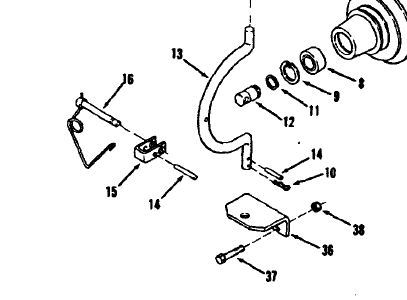

I'm looking to install a locking pin on my PTO. P/N 105850 item number 16. I bought a 1/4 one that fits in the hole, but the head drags on the end of the PTO. This is the smallest I could find. Does anyone have the numbers for this pin or a part number and place to get it? If possible a place I can go in to not online. I can not wait.

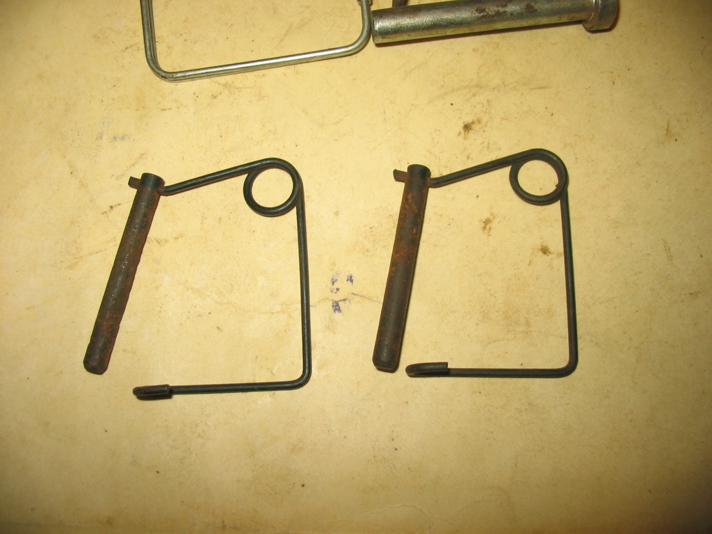

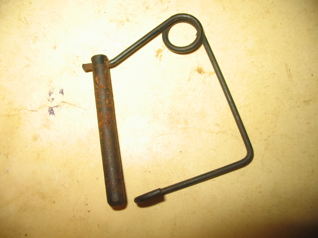

I have TWO of the # 16 pins you look for  these are both OEM..  Send me an email for details .
my email address is:
daveoman@windstream.net
obone
Huh, I see the issue now. Mine has a head on it yours does not. Even the drawling I posted shows a head. Very interesting. Thanks for the picture.
Double check your bearing #8 stub# 12 and retaining ring # 9 for slop and a wallowed hole in the stub also. If worn the stub will "Move" back and forth and may draw the hole closer to the bell making the pin contact the edge. I had 2 of these do this.
I added 2 pieces of plastic tubing to the pin on each side to keep the pin head away from the casting. If I remember correctly is was the gray 3/8" OD tubing used as supply lines to a deck faucet.
