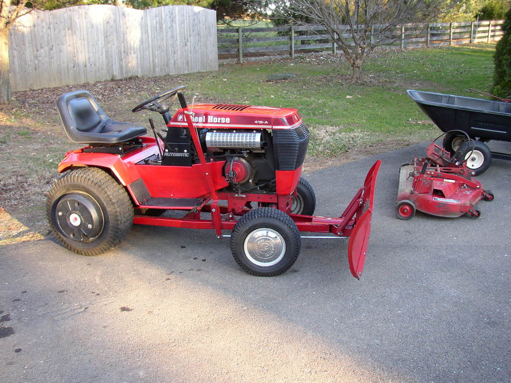

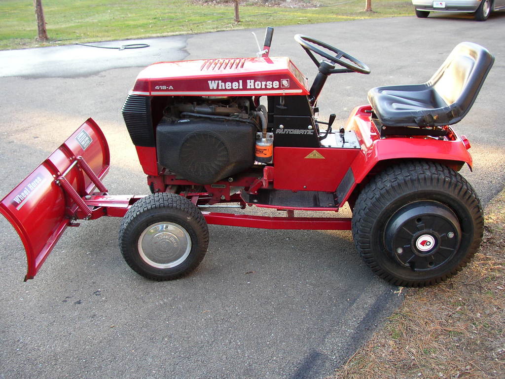

SPINJIM 1,981 #1 Posted February 19, 2017 Seems like the warm weather (70 degrees here in PA) has brought out some WH from the sheds. I've been watching a 418-A on CL for about a month now, but the seller was asking way too much. This weekend, I went to see it because the weather was good. I made him a reasonable offer on, much lower than he was asking. He said he'd consider it, then phoned me a few hours after I got home, and accepted my offer. Includes a nice 418-A with 680 hours, a 48" plow, weights & chains, 4 hub caps, a 48" rear-discharge deck, and a Craftsman garden cart for $800. The 418A came with owner's manual, sales brochure, and service records. It only needs some adjustments, no repairs. PO was an elderly gentleman who has his grandson cut his grass for him now (with a newer, yellow mower). I also noticed a rusty old B-100 with four flat tires sitting nearby, and they said I could have it for another $50. It will probably be just a 'parts tractor', but has some parts I need. Seems like people are taking advantage of the good weather to clean out their garages and barns, so there are deals to be found. A friend gave me a 1968 WH snow thrower just to get it out of his shed. 18 Share this post Link to post Share on other sites
Wishin4a416 2,191 #2 Posted February 19, 2017 Nice haul. Tractor looks to be well taken care of. And a nice parts tractor. The deck is a 42''. Good Luck 1 Share this post Link to post Share on other sites

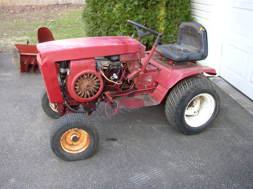

SPINJIM 1,981 #11 Posted February 20, 2017 Thanks everyone. The B100 isn't as nice as it looks in the picture. Trans looks bad. PO's grandson says the engine ran a month ago, but me thinks he speaks with forked tongue. I'll try it tomorrow. I've been wanting a good 2-cylinder WH for years, but didn't want to get into an Onan or spend the $ for a 520. The 418A with Kohler Magnum is perfect for me. 2 Share this post Link to post Share on other sites
shallowwatersailor 3,213 #12 Posted February 20, 2017 I 9 hours ago, SPINJIM said: I've been wanting a good 2-cylinder WH for years, but didn't want to get into an Onan or spend the $ for a 520. The 418A with Kohler Magnum is perfect for me. I saw that tractor on CL as well and agree that it was too much $$. What is the orange item on the left side at the rear of the engine? Is that a fuel filter? Share this post Link to post Share on other sites
T-Mo-(Moderator) 4,513 #13 Posted February 20, 2017 Nice haul, and that B-100 looks like it's in better cosmetic shape than the B-100 Automatic I picked up at the first of the year. Too bad you weren't closer and I would take that B off your hands. 1 Share this post Link to post Share on other sites
SPINJIM 1,981 #14 Posted February 20, 2017 47 minutes ago, shallowwatersailor said: I saw that tractor on CL as well and agree that it was too much $$. What is the orange item on the left side at the rear of the engine? Is that a fuel filter? The orange is an oil filter. I think it was a dealer add on, or a factory option. I guess it works off of the internal oil pump. I think the Kohler M18 had a port in the side of the block where the filter hoses could be attached. Some experts here might correct me. Jim Share this post Link to post Share on other sites
ericj 1,578 #15 Posted February 20, 2017 I know cub cadet's offered a remote oil filter, not sure if wheel horse ever did, but who know, never say never eric j Share this post Link to post Share on other sites
SPINJIM 1,981 #16 Posted February 20, 2017 (edited) 45 minutes ago, T-Mo said: Nice haul, and that B-100 looks like it's in better cosmetic shape than the B-100 Automatic I picked up at the first of the year. Too bad you weren't closer and I would take that B off your hands. If I can get the engine to run, I might sell it as a complete unit. I hate to part out a WH. All 4 tires are shot, so I'd have to find some used ones to put on. Hydro trans linkage is broken, so I don't know what the trans internals are like. I'll start with the engine today. Jim Edited February 20, 2017 by SPINJIM 1 Share this post Link to post Share on other sites
pfrederi 17,947 #17 Posted February 20, 2017 If you get a chance could you take a couple pictures of the oil filter set up. I do not know why WH didn't spec the filter (especially on the 418C commercial use version) other companies did. I would like to rig up something like it on my 418A Share this post Link to post Share on other sites
shallowwatersailor 3,213 #18 Posted February 20, 2017 1 hour ago, SPINJIM said: The orange is an oil filter. I think it was a dealer add on, or a factory option. I guess it works off of the internal oil pump. I think the Kohler M18 had a port in the side of the block where the filter hoses could be attached. Some experts here might correct me. Jim Jim, thanks for the reply. I should have blown up that area of the picture to see the Fram name. I'll need to check that out as well. I wonder what the PSI of the pump is so as to not use too restrictive a filter. Good to know for my 417A. Share this post Link to post Share on other sites
SPINJIM 1,981 #19 Posted February 20, 2017 14 minutes ago, shallowwatersailor said: Jim, thanks for the reply. I should have blown up that area of the picture to see the Fram name. I'll need to check that out as well. I wonder what the PSI of the pump is so as to not use too restrictive a filter. Good to know for my 417A. I was thinking about that also. I even considered removing the filter to make sure I have good oil pressure to the crank shaft. As long as I replace the oil frequently, I shouldn't need a filter. Any one have experience with a filter on Kohler twins ??? 1 Share this post Link to post Share on other sites
T-Mo-(Moderator) 4,513 #20 Posted February 20, 2017 1 hour ago, SPINJIM said: If I can get the engine to run, I might sell it as a complete unit. I hate to part out a WH. All 4 tires are shot, so I'd have to find some used ones to put on. Hydro trans linkage is broken, so I don't know what the trans internals are like. I'll start with the engine today. Jim My B-100 Automatic doesn't have the seat nor the seat springs, and the hood has been butchered a bit. I see some good parts on your B that are better than mine, or missing on mine. Both of ours being hydros is either a coincidence or an omen. Share this post Link to post Share on other sites

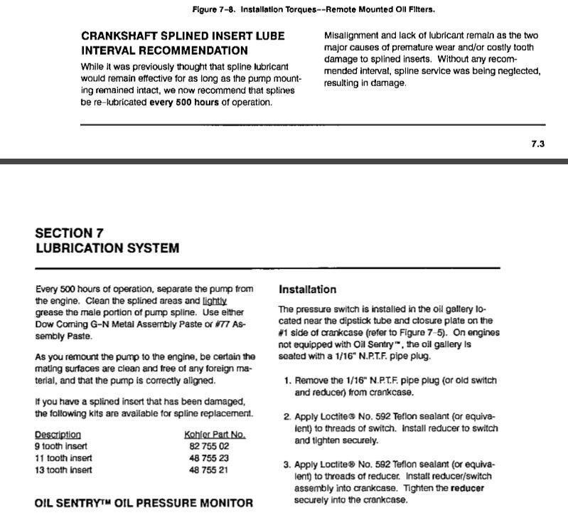

pfrederi 17,947 #21 Posted February 20, 2017 (edited) 10 minutes ago, SPINJIM said: I was thinking about that also. I even considered removing the filter to make sure I have good oil pressure to the crank shaft. As long as I replace the oil frequently, I shouldn't need a filter. Any one have experience with a filter on Kohler twins ??? Service manual says in good condition under normal operation pressure can be as high as 50psi. The warning switch is supposed to trigger between 2-5 psi. I also noticed that you are supposed to remove the pump and lubricate the spline shaft. This was an add-on maintenance requirement after they suffered too many premature failures. I have never done it ...guess i better this spring.. One other interesting note...all standard motors came with filters. Speced motors may or may not have them based on the wishes of the company ordering them. Edited February 20, 2017 by pfrederi 1 Share this post Link to post Share on other sites
SPINJIM 1,981 #22 Posted February 20, 2017 3 minutes ago, pfrederi said: Service manual says in good condition udder normal operation pressure can be as high as 50psi. The warning switch is supposed to trigger between 2-5 psi. I also noticed that you are supposed to remove the pump and lubricate the spline shaft. This was an addon maintenance requirement after they suffered too many premature failures. I have never done it ...guess i better this spring.. One other interesting note...all standard motors came with filters. Speced motors may or may not have them based on the company ordering them wishes. I tried to find info on the oil pump, and got the impression that it was internal, and that you had to split the block to get to it. I'm still learning about the twin engines. Is the pump accessible for service ? I guess I need more info since I have a 417 and a 418 now. Thanks, Jim Share this post Link to post Share on other sites
pfrederi 17,947 #23 Posted February 20, 2017 Some things you can do externally but this shaft lube may require splitting the case. That is an awful lot of work to do every 500 hours. 2 Share this post Link to post Share on other sites

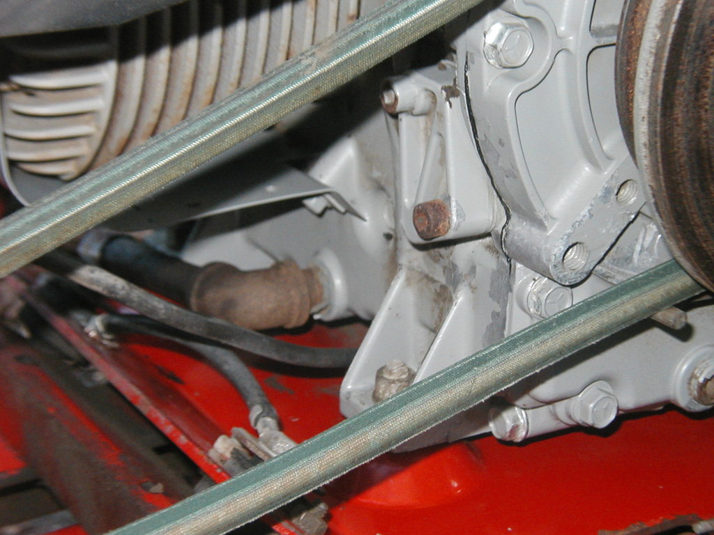

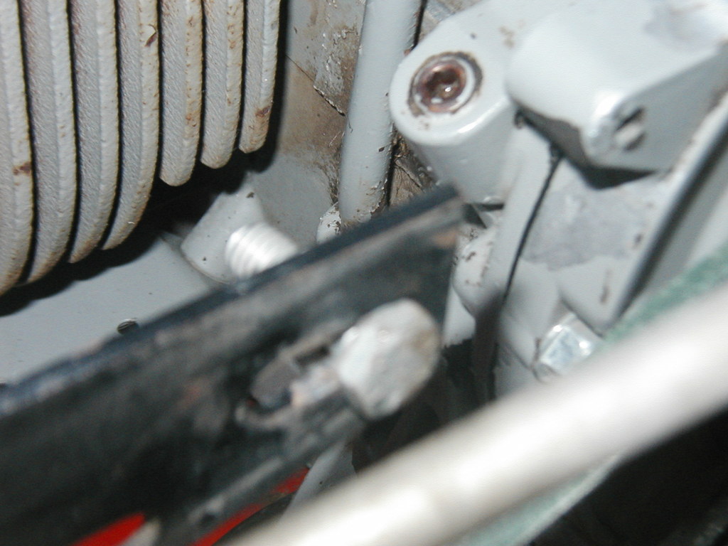

JackC 617 #25 Posted February 20, 2017 (edited) The orange is an oil filter. I think it was a dealer add on, or a factory option. I guess it works off of the internal oil pump. I think the Kohler M18 had a port in the side of the block where the filter hoses could be attached. Some experts here might correct me. Jim The Series II engines have a port on the PTO side of the engine to add an oil filter base and oil filter or remote base and remote oil filter. The PTO side is not a good place for an oil filter on the Wheel Horse tractors so the remote is the way to go. Here is a pic of the cover over the port. You can replace the cover with the remote unit and pipe the filter to a convenient location. There is also a port just above for an oil pressure gauge. Oil pressure should range between 25-50 lbs. Edited February 20, 2017 by JackC 4 Share this post Link to post Share on other sites
