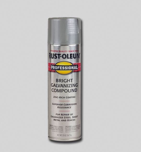

ACman 7,741 #4 Posted February 17, 2017 (edited) There's cold galvanize spray cans . Had to use this on cell towers after we ground down a spot to solder on a ground strap . The stuff we used was dull looking , but I found this from Rust-Oleum . Hope this helps . Edited February 17, 2017 by ACman 2 Share this post Link to post Share on other sites

wallfish 20,508 #10 Posted February 18, 2017 16 hours ago, ACman said: There's cold galvanize spray cans . Had to use this on cell towers after we ground down a spot to solder on a ground strap That commercial stuff with the no frills label they used to get was some really good stuff. It had to hold up for years out on those towers. I miss doing tower work, Loved being up that high but not so much the climb to get up there. The highest job we worked on was around 550 ft. Too bad I got old. 3 Share this post Link to post Share on other sites

Duramax7man7 506 #24 Posted February 24, 2017 Okay, so Zinc will protect a bit so I'm fine with... BUT, I don't know if I'm fine with the color of this Cold Galvanizing Compound... It's basically grey... What do you guys think? I was wanting to clean up and galvanize the angle adjust handle, lock wire and angle adjust movement bar as well... Check it out and let me know what you all think. Share this post Link to post Share on other sites
Sarge 3,473 #25 Posted February 26, 2017 It looks fine albeit a bit dull looking from the spray can stuff . Good galvanizing is applied under fairly high heat in a dip/spray process so it's nearly impossible to reproduce at home . I've never had much luck with the cold bonding stuff - it still rusts over time and scratches off pretty easily . Look around on the net for Spray On S00738 - the stuff is not easy to find and you really have to pay attention to the instructions , especially that part about turning the can upside down and clearing valve immediately after using - it will very easily plug up the nozzle and pickup tube , rendering the can useless . That , and shake it constantly as it does have small particles of 316SS suspended in it and will leave a somewhat rough finish . Once cured , you almost can't grind the stuff off - toughest paint I've found yet and has been on my welding table now since '09 , conducts electricity quite well to the work piece and I have yet to burn any off , even at high amperage tig work on aluminum (rated to 400*F) . http://www.shopjfi.com/16oz-sprayon-stainless-steel-steel-coating.html On previously blasted zinc coatings parts I've done and used this coating it's held up very well . I'd check and see if the cold galvanzing finish will get along with the SS paint and use that as a top coat and allow the zinc coating to act as a primer to prevent rust . All the linkage parts and such I've done with it over time have sown a bit of rust through the finish but that was with zero primer underneath - so might want to try to use the zinc as a base...Sprayon also makes a pretty good zinc cold coating as well , it's just tough to find someone that carries it without having to buy case quantities . Sarge 1 Share this post Link to post Share on other sites
