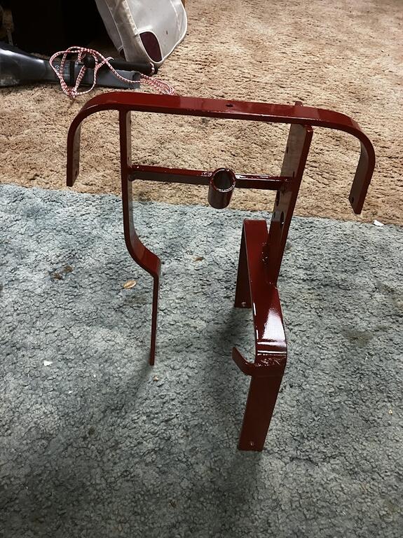

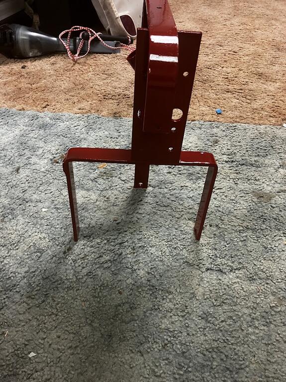

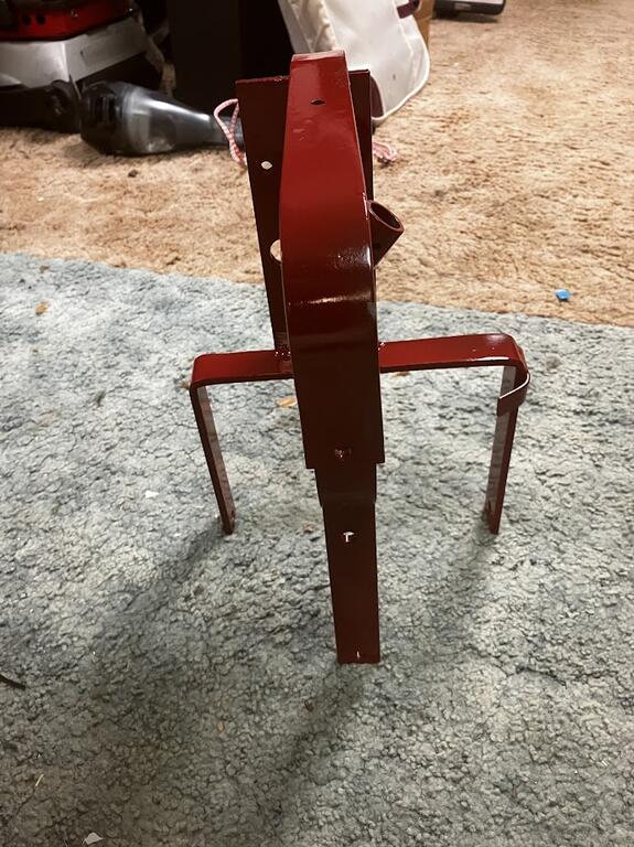

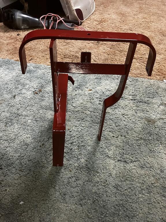

@T-Mo Here the 551 Hood /stand drawing to help you along.
The 1/4 x 1-3/4 x 8-5/8 Flat Bar welds to the left side of the frame. it sits 1/2' inward and mounts directly against the round foot rest bar.
The 1/4 x 1-1/4 x 1-3/4 (2 required) They mount with an edge directly inline with the outer edge of the right side of the frame. One welds directly against the right round foot rest bar.  The other one welds to the frame  8-3/4 from the right foot rest bar.  This should result in the 2 tab having a 9" wide outside to outside dimension.  The hoods stand mounts to the outside of these 2 tabs.
The battery holder bar installs with 2 long 1/4" bolts that extend back to the 1/4" holes in the left side hood stand frame mount bar.
