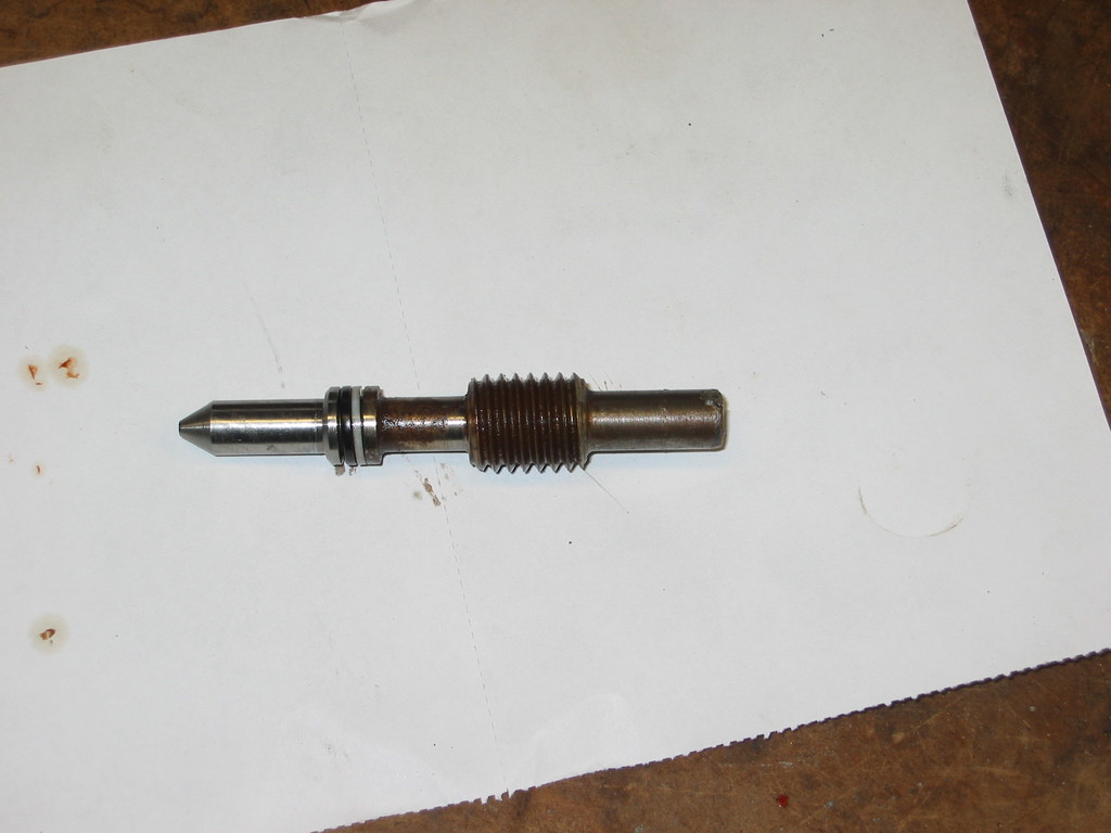

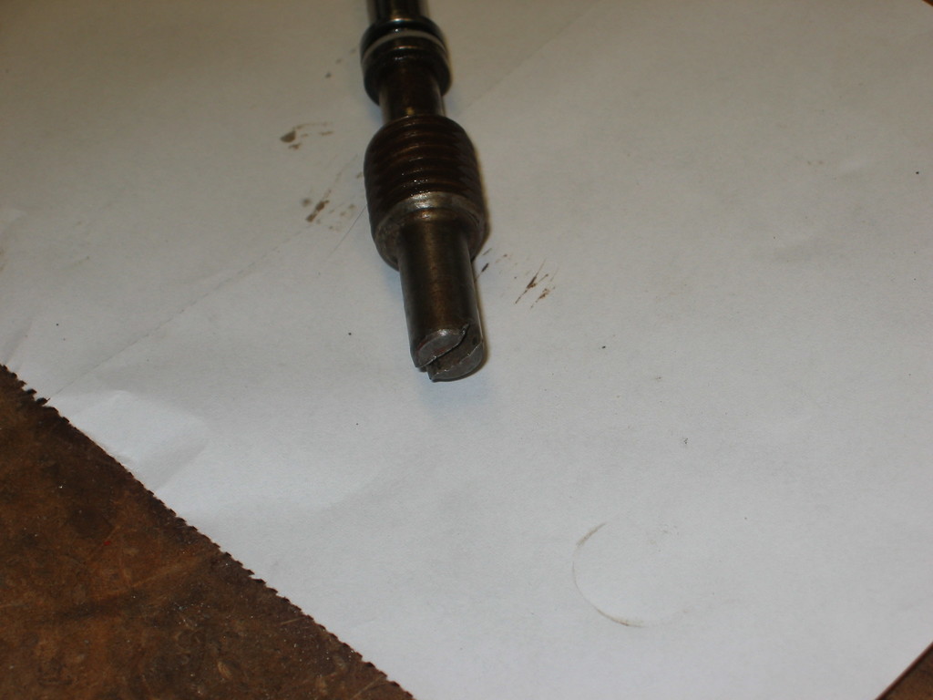

Iron Wheel Horse 9 #15 Posted February 13, 2017 Here is a picture I do understand the seat thing, Maybe a piece a tiny tiny of the end of the seat broke,very point I used oil , wd40 and still needed to use vise grips to turn It should be simply , but am I the only one that simple always turns into a complete rebuilt , Chuck Share this post Link to post Share on other sites

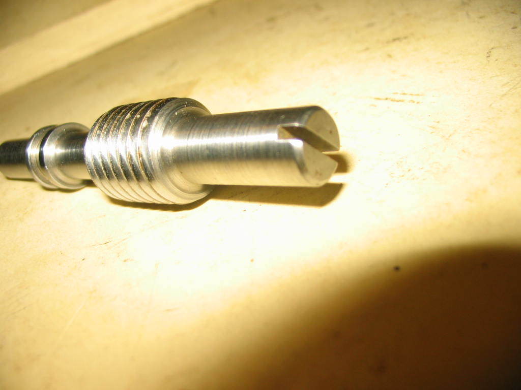

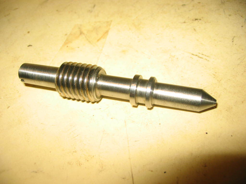

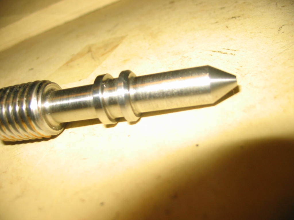

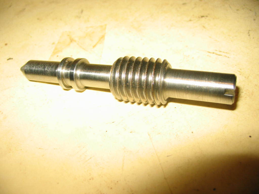

pfrederi 18,086 #18 Posted February 13, 2017 (edited) This is what your tow valve looks like. What I do not understand is how your tractor could operate if you had opened the valve one whole turn. Those are coarse threads one turn moves that point a lot As to ;leakage if it has not run in awhile you shouldn't get a whole lot of fluid spillage maybe a cup or two Edited February 13, 2017 by pfrederi 1 Share this post Link to post Share on other sites
Iron Wheel Horse 9 #19 Posted February 13, 2017 (edited) pfrederi You really went all out THANK YOU ! I would not mind getting that part new as I chewed up the shoulder on mine. When I did turn this out and it was many moons ago and left as is because i just though this simple thing may not be so simple. One thing comes to mind but with barrier of fluid would not seem so steel seated against aluminum and the hole has been clog with corrosion deterioration, farer fetch ,or other junk. Maybe when I get a chance I should take out valve and use a vacuum and then blow some air after getting fluid level lowered,I don't know . Need brain stormers on this one. Now looking at the pic I took I may of taken all the way out and then put anti seize on it looks silvery in color. I don't remember fluid flowing out ,I would of remember that which may show the sign of a plugged up hole / venturi if that is what you call it. Edited February 13, 2017 by Iron Wheel Horse 2 Share this post Link to post Share on other sites
