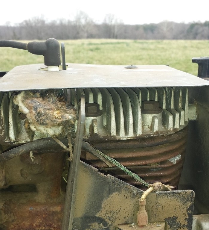

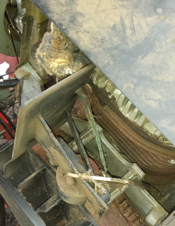

So I had a chance to dig in a little bit this morning. I tested the PTO, Seat, and Clutch pedal switches and they are all functioning correctly. All connections are tight, and I have cleaned them the best I could. I didn't check either of the relays yet, but wanted to post some pics of one thing I uncovered that may be contributing to the problem. I decided it would be a good time to clean as much of the engine as I could and when I pulled off the flywheel cover, I found a tenant that had been toasted. He had a chance to chew through about 90% of the spark plug wire and just through the insulation on the starter wire before he expired. Before I look at the relays, is it possible that this is causing the no power at ignition?

Me thinks you found the culprit.
New wires and recheck all the connections.
Image result for bingo images            :handgestures-thumbupright:
RusTia
I guess I feel a little better then. I was afraid that the ignition coil being at the end of the circuit would not explain why there was no power to the starter. Once I replace some parts, I will report back.

The critter damage shown will not cause a no crank condition. You need a volt meter to start with. A test light will work but wont show voltage. Start with ignition switch to make sure you have 12v in start position. If that's good move to the clutch switch. Make sure you have 12v in and out with clutch depressed. If good move to the PTO switch, 12v in and out with PTO disengaged. If good move to starter solenoid. 12v on small terminal. If that's good see if you have 12v one both sides of the large terminal. All these test are done with key in the start position. If any of the test fail then stop and repair before you go any farther.
