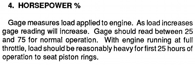

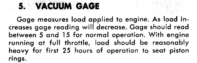

It is engine vacuum but the operator's manuals seem to differ in their description and appear to contradict each other unless they are calibrated opposite to each other.
#5 is 1988 and #4 is 1993-96. Hopefully an owner can tell us which is correct.
Engine vacuum is taken from a port after the throttle plate. Higher is better.
Sometimes a vacuum gauge gets it's signal from the air cleaner ahead on the throttle plate to indicate the condition of the air filter. Lower is better.

They both are correct, #5 standard vacuum gauge when you open the throttle the vacuum drops as rpms rise then on the newer models #4 it's obviously calibrated different to show amount of hp being used ,as for me normal WOT while mowing normally reading steady at 75% +/- but heavy tall grass and deep snow blowing near 100% when the governor opens up and at idle needle fluctuates around 25% +/-, just my experiences with my 520s and tuning carbs with a standard vacuum gauge also the stand alone vacuum gauge can give you an idea on ring/valve seal/condition throughout the rpm range, Jeff.
