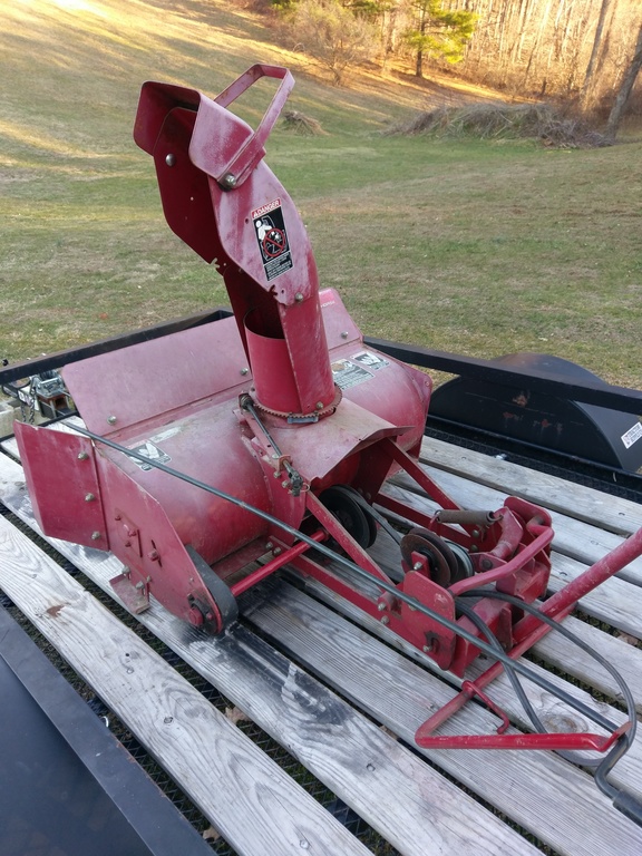

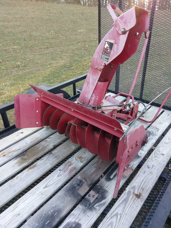

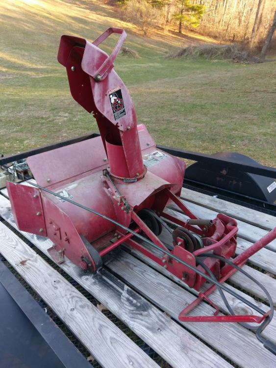

Found an Xi single stage snow thrower still attached to a 520xi for sale as a package, contacted the owner asked if he would separate and sell and sure enough I brought home a "gently" 3 or 4 season used single, paint faded from setting out under roof only but looks solid and sounded quiet when engaged, PO left it attached to his tractor drove it up on my trailer unhitched and backed away couldn't have been easier on my back, Jeff.

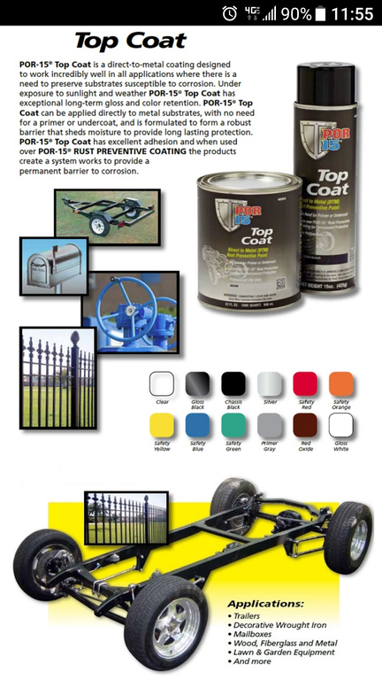

WVHillbilly520H
And colors too...
bmsgaffer
I was looking at that, but they still mention using a base coat of regular POR-15 for a "permanent barrier to corrosion".
I was always curious to see how far off "safety red" is from WH red. Im guessing pretty far off.
