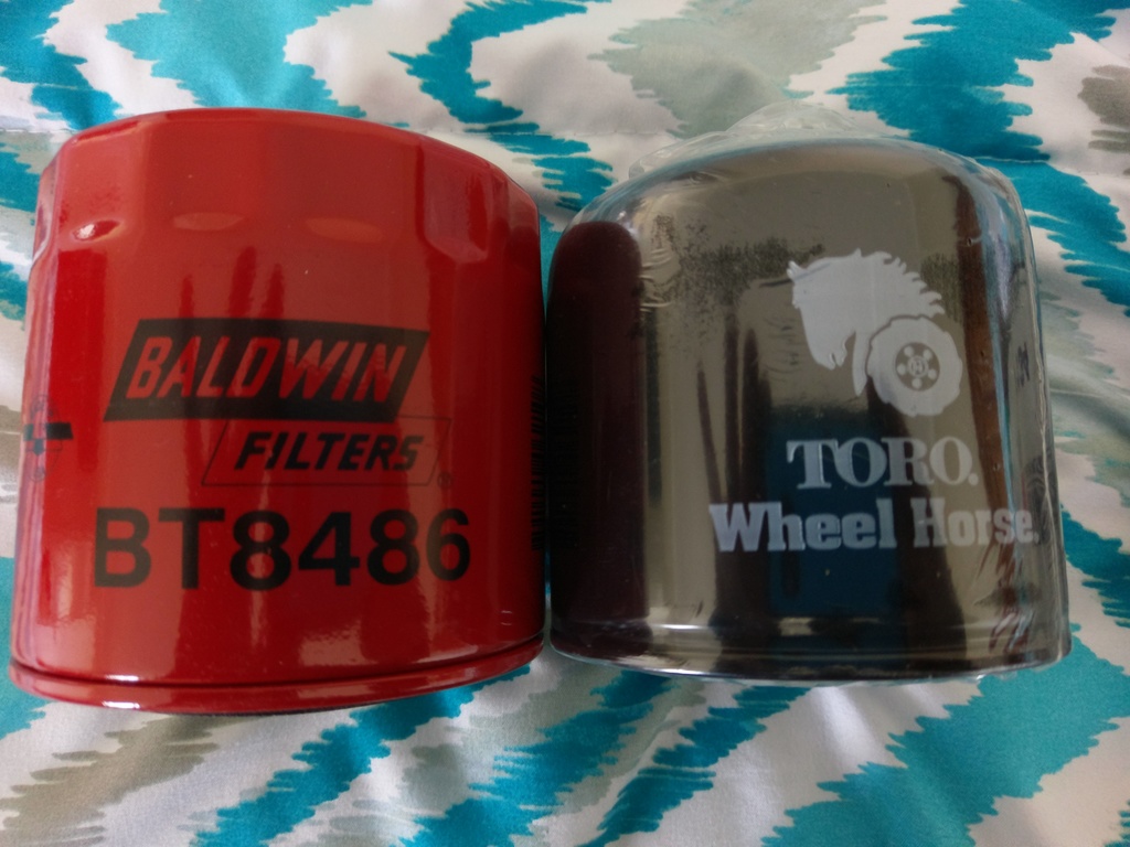

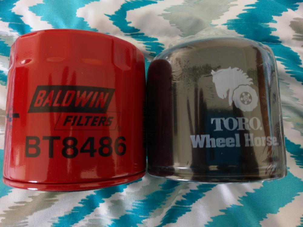

Yep Toro 79-5270 and FYI  Baldwin BT8486 will work too, Jeff.

I compared the wix and toro filters during the change. The wix had bigger inlet ports but less of them than the toro. Gasket diameter was smaller than the toro but the wix filter was longer. I doubt any of that matters, however, I hear tell the toro filter has a 10 micron filter rating whilst the wix is around 20. That info is worth considering.  GPM or flow rate is affected by the quality of the filter media as well so if the charge pump is working harder to push oil through the filter, you will get more whining. Might also consider taking a look at your strainer as well. Those get clogged up and pumps get angry about it quick.
I called toro today because this is bugging me.  The guy I talked to had no clue who made the filters for them. Not only that, he couldn't even give me the specs on it...and thats after he put me on hold for 5 minutes while he tried to figure it out.  As a topper, he told me "if you have access to the internet, you could GOOGLE it and try to find out more info".  Really dude?!  He then suggested I call a local authorized toro dealer....haha, sure.

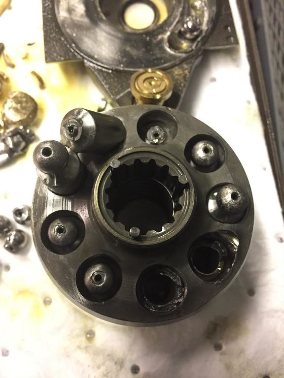

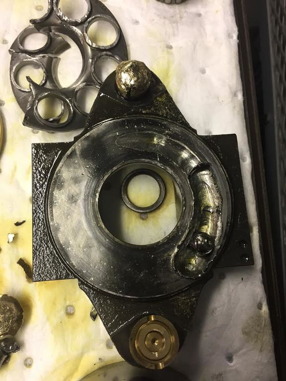

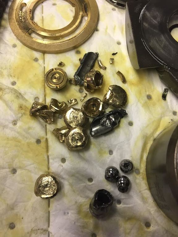

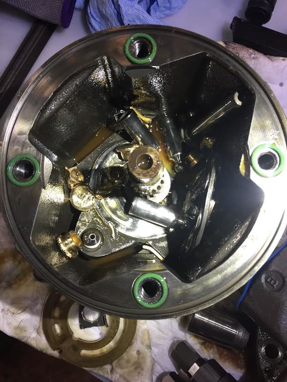

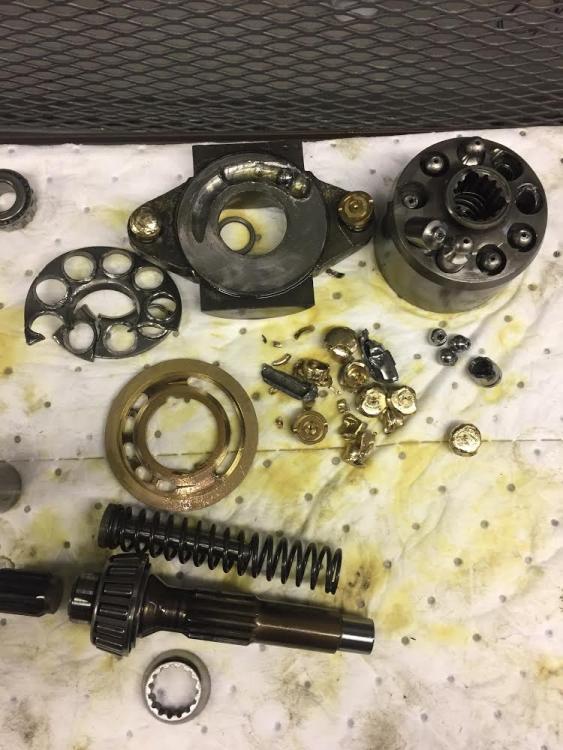

Contamination is nothing to play with when dealing with variable or fixed displacement/piston pumps.  This 13 gpm pump I replaced last week blew up simply because it got some water in the system from a leaking heat exchanger.  WATER.  I may have to cut open both filters and compare for peace of mind.

Sarge
I think the phrase "blew up" is a bit short , I'd say it's more like "committed suicide"...wow . Definitely not rebuilding that one , even with a welder...
