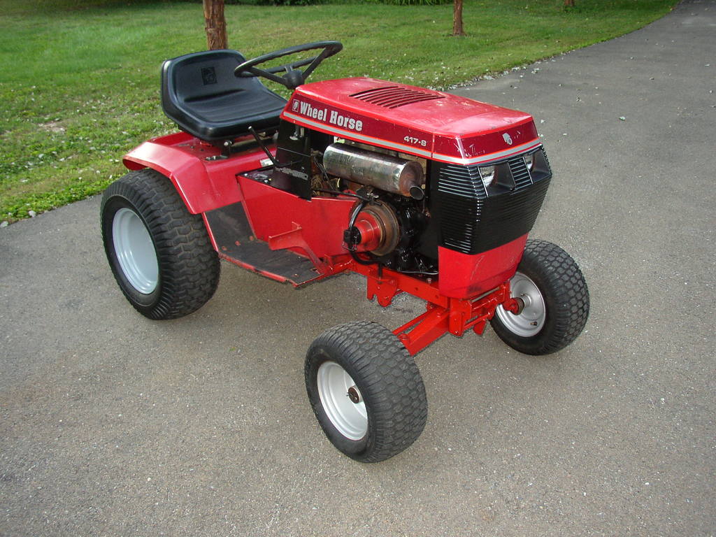

The 417-8 is an excellent tractor.   I bought one last summer, and it is one of my favorites.   I put a snow blower on it, and look forward to using it if we ever get a decent snow.     The 417 was made in 1985 and 86.    Most of the 86s had an electric lift, which is useful for a plow blade or snowblower.   The 86s had a louvered hood, and the 85s did not.    The Kohler 17 twins were the Series II, with better oil circulation.    It's a good smooth running engine.
The price depends on hours on it, and how well it was maintained.   I paid $600 for mine with 490 hours on it, but had to put a lot of work and paint, and a little money into it to get it running right.   Wiring was a mess, and kill switches missing.
Go for it if it's in good shape at a reasonable price.
