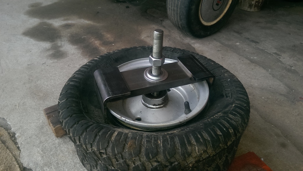

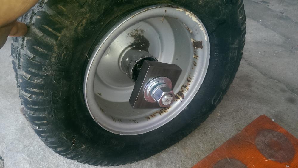

WVHillbilly520H 10,376 #3 Posted January 27, 2017 This is the 8" tire bead breaker I fabbed up last summer (should have made it adjustable for more diameters), and thanks for your thoughts on the HF tool,Jeff. 5 Share this post Link to post Share on other sites
