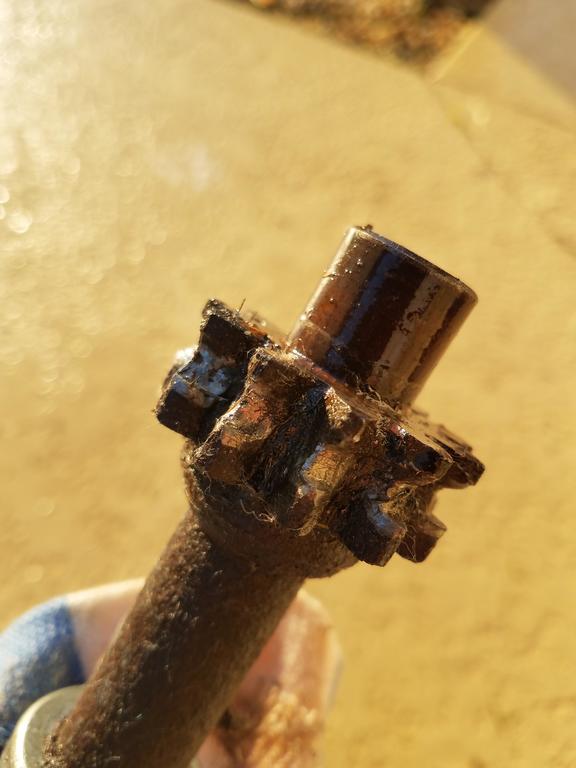

The gear at the bottom end of the shaft has worn to the point where if skips (teeth worn) so I figured I needed to replace the gear. I now understand that it comes pre pressed onto the shaft. Looks straightforward except for removing the steering wheel from the shaft:

1) Looks like the 200 series is a whole different animal than the 606 that is being posted about. From what I understand with the 200 series there is a large washer that has an off center hole (eccentric?), you loosen the bolt holding the fan gear and depending on how you orient the washer (which is under the fan gear) the teeth on the shaft end up nearer or farther from the from the teeth on the fan gear (I am not a know-it-all so if I am mistaken PLEASE correct me)
2) It needs some dental work, the teeth on the shaft gear are worn I would estimate 50% from new so matter how far back I try to locate the eccentric they dont mesh well (lots of slop) I will send a photo when I get it apart

Just in case there was any question that these gears can indeed wear out, here is what the old one looked like!
I got lucky, the roll pin came out without any drama and the steering wheel released from the shaft very easily. I am sure there is a correct way to do this but I removed the 4 nuts and bolts that hold the plastic "dashboard" which gave me just enough wiggle room to remove the shaft assembly through the bottom (removed the deck) and feed the new shaft, collar, bushing etc back from the bottom up.
Problem solved, steers as it should.

They do indeed wear out...poor design. I cut the shaft out of one, welded up the gears and welded the shaft back together. Easier for me than fighting a stuck steering wheel.
