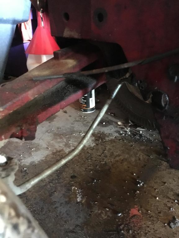

Well we just bent the "tie rod"... which was a piece of 1/8" all thread the previous owner had cobbled together.. gives me a good reason to fix the problem now
cleat
You mean 3/8" rod ?
I used that on my one 520 that has the non-swept axle.
So far it has not bent but I only use that machine for mowing and tilling.
Team70R
No its 1/4". The previous owner had no business even messing with it. I'll take a pic when I get home. It's a mangled mess
Team70R
cleat
Yes, that is bad.
I guess it sort of works.

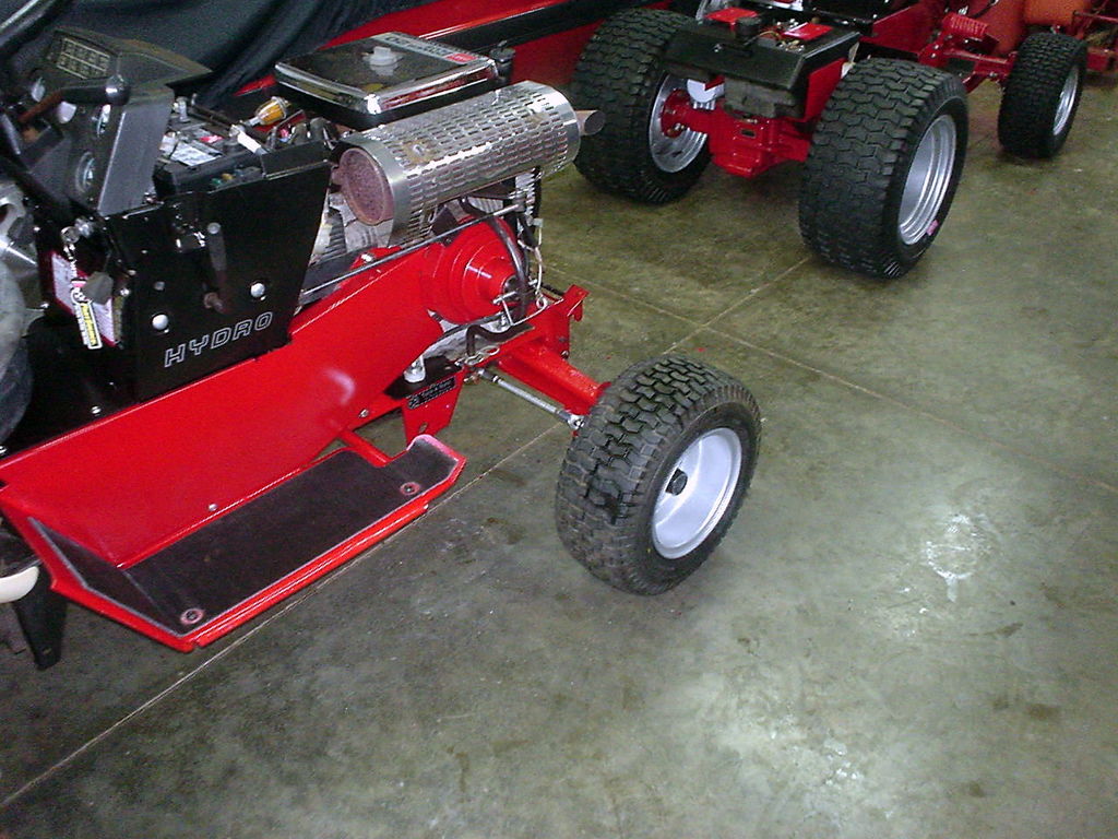

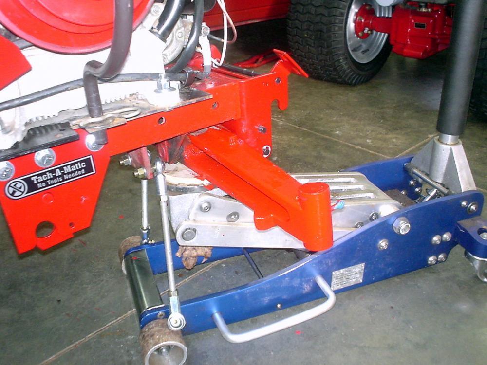

I did this. Could be made stronger but so far it works.
Hard part is finding fine thread rod.
Cleat
Team70R
I'm gonna do that! Found everything I need online for $27 plus shipping.
