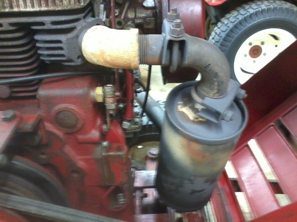

Texas Todd
I used this one.
But any muffler will do. Like this one:

rmaynard
Depending upon what year your B-100 is, the correct muffler is either a 105915, 106918, or 102258 (plus pipes and clamps). The latter two show as still being available from Toro, but expect to pay a bucket of money for them. If you are not interested in keeping the B-100 true to original, a pepper shaker style like the one shown in post #2 above is cheap, and will suffice, but will become loud after a short time.

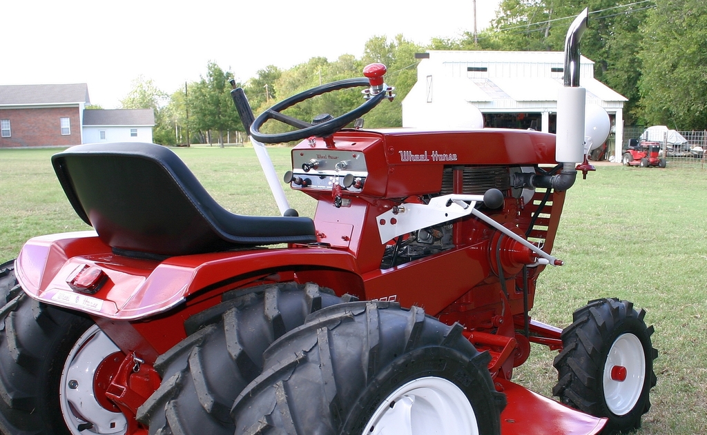

jay bee
Here is a picture of my '76 B-100 that I bought new.  This is how it came out of the factory.  I have an add in the classifieds for a reproduction of this same muffler and exhaust pipe.   Check it out and see what you think.   Jim
