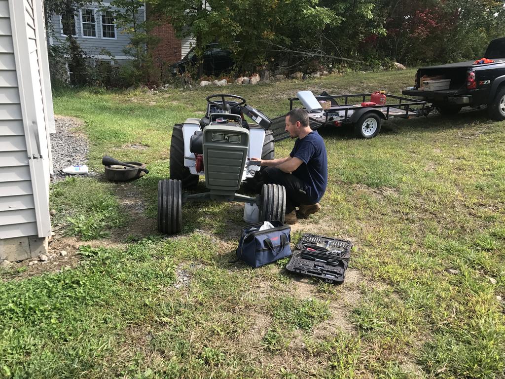

Kyle @fast88pu got the predator hooked up for me a few weeks ago. Shout out to him for his assistance!
IMG_1399.JPG.91ddbcc8371c1f997ff13a7bf04f6c7e.JPGIMG_1400.JPG.35c7efce02f449d2c1aca39c74f38678.JPG

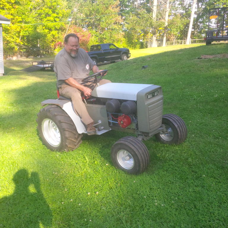

It looks and sounds so good!

Rubber selection is spot on Aldon. :handgestures-thumbupright:

Not too surprising it is fast, the rear gearing was set up for 23" tires and those look like 28" or taller.
  • Like 2
Aldon
29x12.5-15

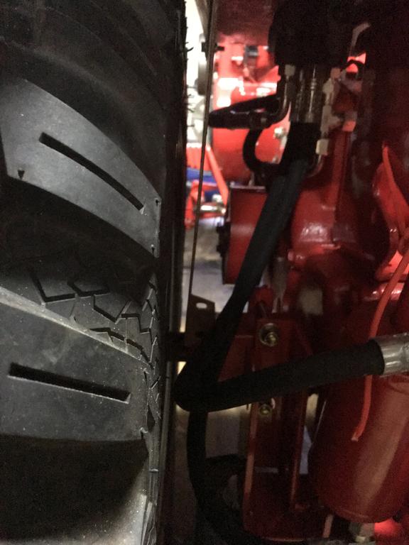

I have mine set at 3.5” of backspacing. 15”x10” wide wheels. With standard axles you would have to set the center plate almost to the edge of the wheel to clear the inner fenders or run spacers. Mine has less than an inch between the tire and inner fender panel.

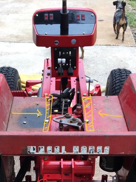

@RandyLittrell Not to hijack Aldon’s thread but The biggest problem I see with the stock axles is the Fender mounting panels. If you could  trim an inch off each side up top where they mount to the frame rails and move them both in an inch, that would move your axle mounting flange also in putting them an extra inch away from the tires. Even if you had to run an 1-1/2 to 2” spacer, you might get away from having to swap axles. It would make your seat mounting area narrower and the seat pan might hit the fenders depending on your seat. Put a spacer below the seat bracket maybe. Just thinking out loud. I don’t know as I have only swapped on the eaton. Maybe one day I’ll do an 8 speed.
