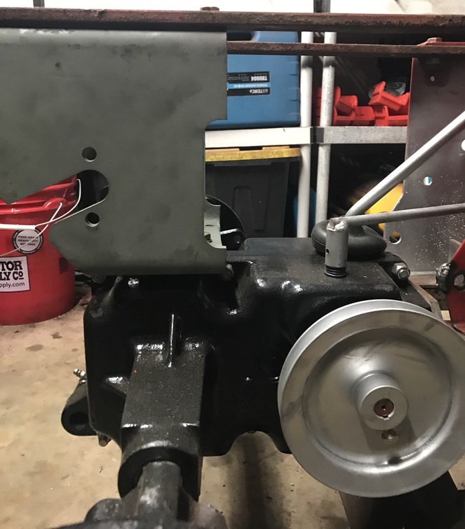

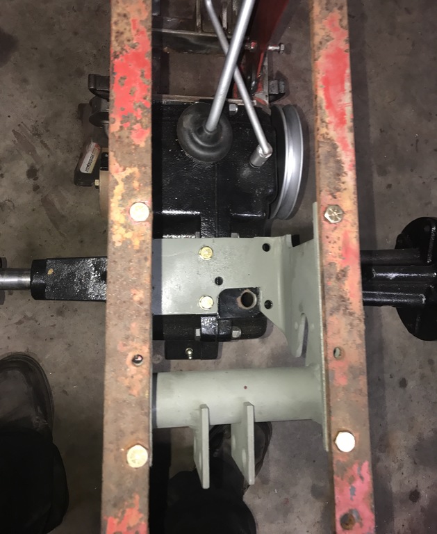

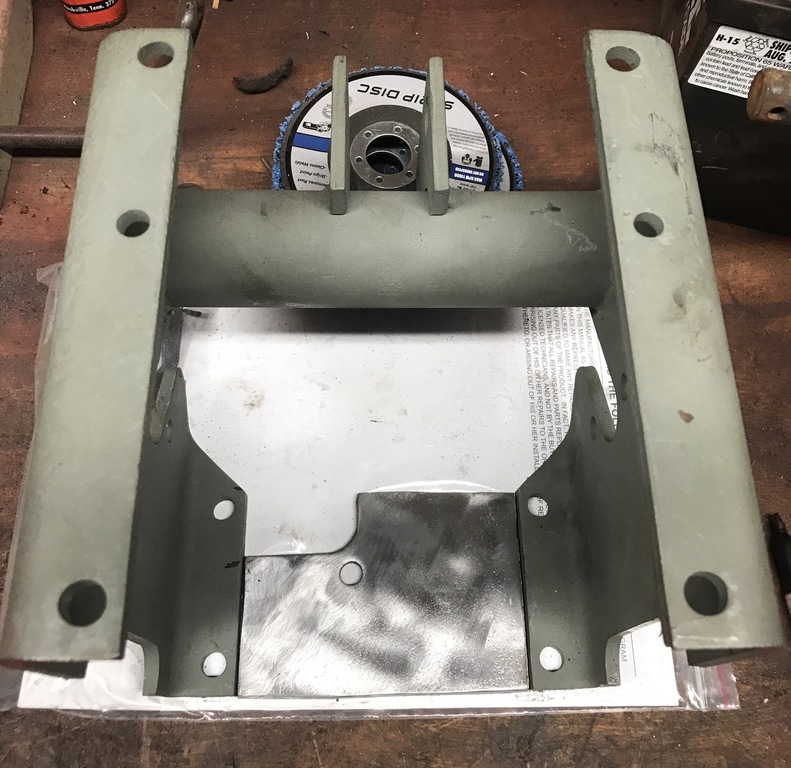

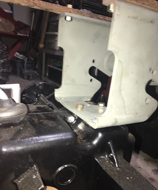

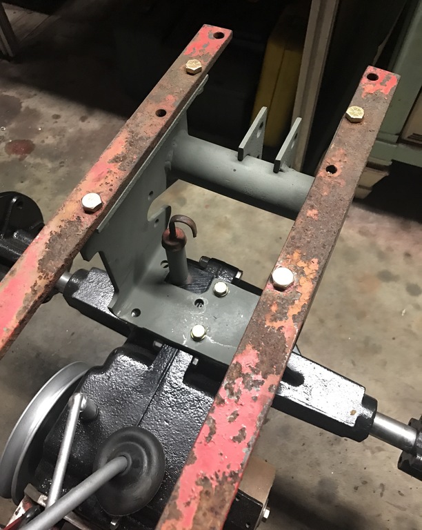

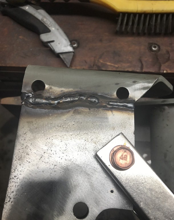

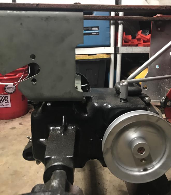

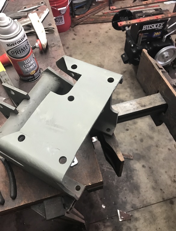

That allowed me me to dig out my welder and I made some good progress on the seat support stand. As mentioned, with the 8 speed manual, a spacer/adapter  needs to be added. As I plan to use 3 point, I wanted it as strong as the set up was on hydro. Once I got it welded, ground flat and primed I had to use a spare stand to measure out where I needed to drill two mounting holes. Pleased as punch with how it came out. PS, it's obvious my welding skills have atrophied in past 30 years. Grinder had its work cut out for it :-)IMG_0287.thumb.JPG.274bcf471418996ea6ae5d0793687f08.JPGIMG_0297.thumb.JPG.1dddb2e8a21b35e82f31fe0a30fff058.JPGIMG_0299.thumb.JPG.f8c1081a7a2d622868717384320535f1.JPGIMG_0308.thumb.JPG.4ef7afa259d833fafece99d41bb207d2.JPGIMG_0309.thumb.JPG.7db678476d99bb9d17280990a4e1a1e8.JPGIMG_0311.thumb.JPG.dc3f9ec9aa610357fe03119c394943ce.JPG

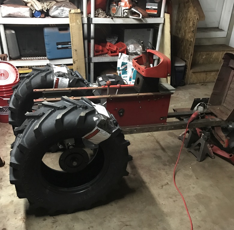

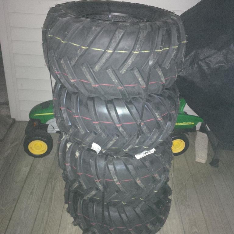

Since winter seems to want to linger a lot longer than I'd like, I'm back to preparing everything so I can proceed at a quicker clip once the weather turns for the better. Came home last night to my new rear tires. Rim blanks and Front Vredstein's are on the way too.
  • Like 8

HorseHead1089
What size are thoes monster rear tires? Looks very good!
  • Like 1
19richie66
Gonna look mean Aldon!
  • Like 1
WHX??
Yes tire size?.....look to be tru-powers?? . My tire ship came in today as well!...23×8.5x12
  • Like 3

Tru-Powers 29x12.5-15
Miller tire blank rims 15-10's are on their way.
i could have cut centers out of the GT14 rim but went with d-series Hubs. The 6 hole new rim centers are also coming from miller tire. They are massive and hopefully will fit without too much surgery.

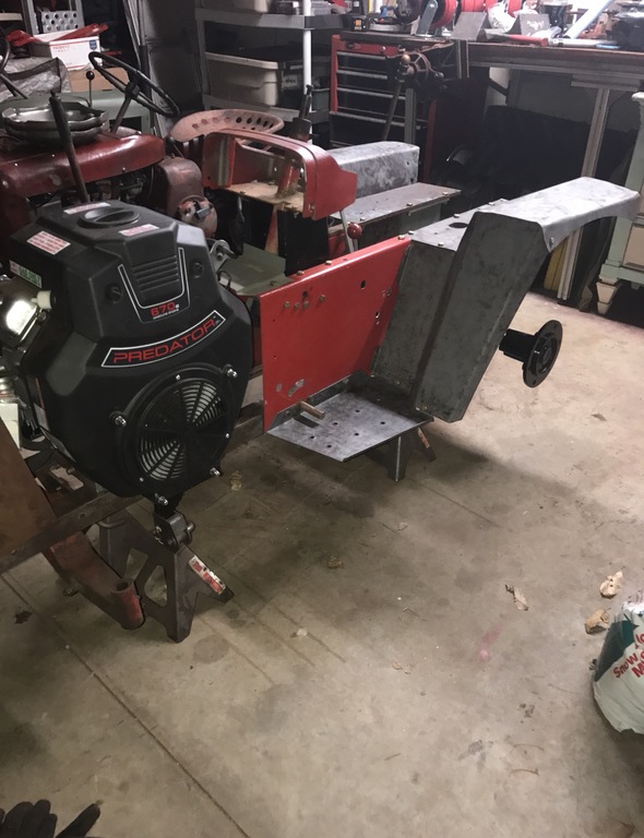

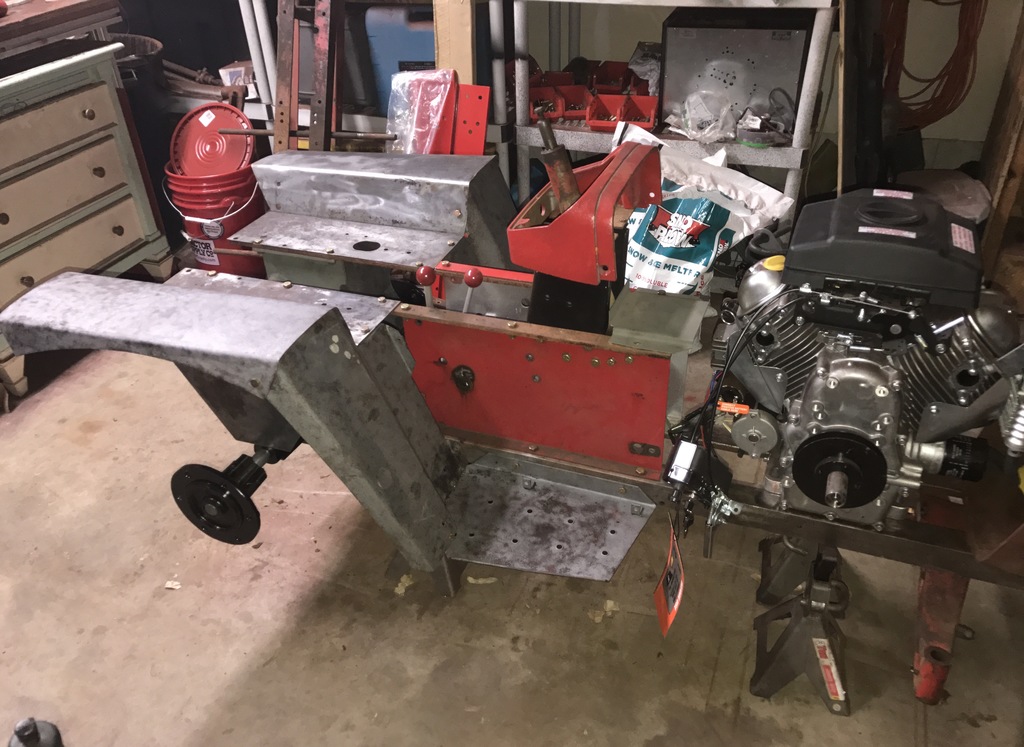

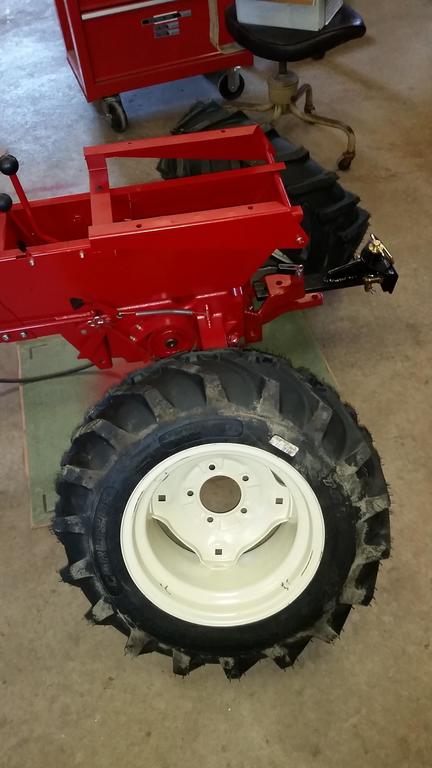

Weather finally getting to point I can get some work done. Problem is I have way too many irons in the fire. I managed to get the fenders and foot treadplates sandblasted and mocked up. Now I can try and determine backspacing and weld up the new centers onto the rim blanks.
