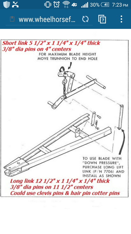

Are There different lengths of down pressure bars for the plow/dozer blade?
stevasaurus
Yes...at least 2 different lengths...maybe 3.  :)
elcamino/wheelhorse
I know there are 2 lengths  short link 5 1/2" x 1 1/4 x 1/4 inch thick. 3/8 " diameter pins on 4 inch centers.
long link 12 1/2 x 1 1/4 x 1/4inch thick  3/8 " diameter pins pn 11 1/2 " centers.
I wonder if there is a 3rd length , I made the long link to above specs and it still does not lift the blade high enough. I have checked the attachment points 2 or 3 times to insure that I have the blade mounted correctly. The blade is mounted on a 416-8.

Short link for float on the mower lift arm, long link for down pressure on rockshaft, then there's the mid grader blade links of different lengths, the the xi series has a floating and down pressure link that's different also,Jeff.

@WVHillbilly520HI have a question the long link goes in the hole for the mower trunnion ? It would seem to me that it would goes in the 3 rd hole ( the one closest the end)for maximum blade lift.
Duramax7man7
Yes. That is what it says. "For maximum blade lift height move the trunnion to end hole". It shows an arrow that points From the 1st hole To the 3rd hole.

Why does the oval hole have to be used for the down pressure bar???
Sarge
Oval hole is intended to give the blade a bit of float and limit down pressure - helps avoid damaging parts . Just remember , any time you are forcing the blade to the ground be prepared for it to grab something , hard...I've seen people launched over the hood when being too aggressive and using too much speed . The trip springs will help , but the faster you go the less chance they can work to prevent a damaging sudden stop when hitting something solid , like concrete and such..

Gotcha. Okay thsnks for the reply. Looks like I better amke thst hole then on my extension kit.
Duramax7man7
I went ahead and made myself one of these... Couldn't find any 1/4" x 1.25". So I used 1/4" x 1.5"
