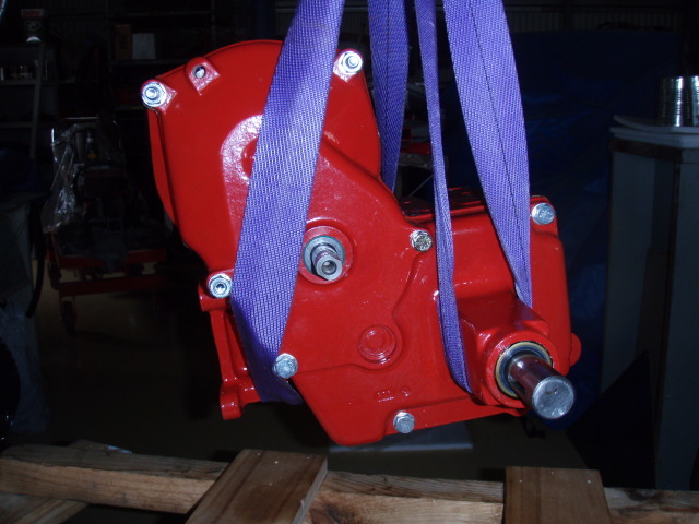

   This information appears that it should be correct, but I sure would like to look at a manual before you take all this to the bank.  :think:  If you can't find a Model #...a few pictures of the trans axle and pump would help.
ti-jean
Hi my trans axle ar same as this one the how sold me that tractor he change for a Eaton 1100 instead of ... I dont know loll but for sure it's same as the pics

Thanks....the above information will work for your transmission.  :handgestures-thumbupright:
