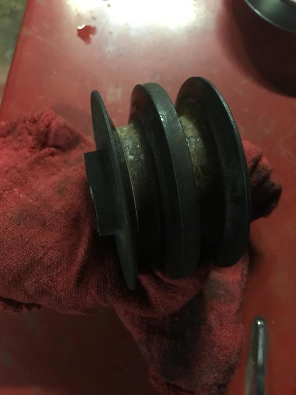

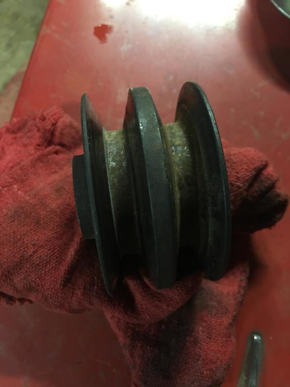

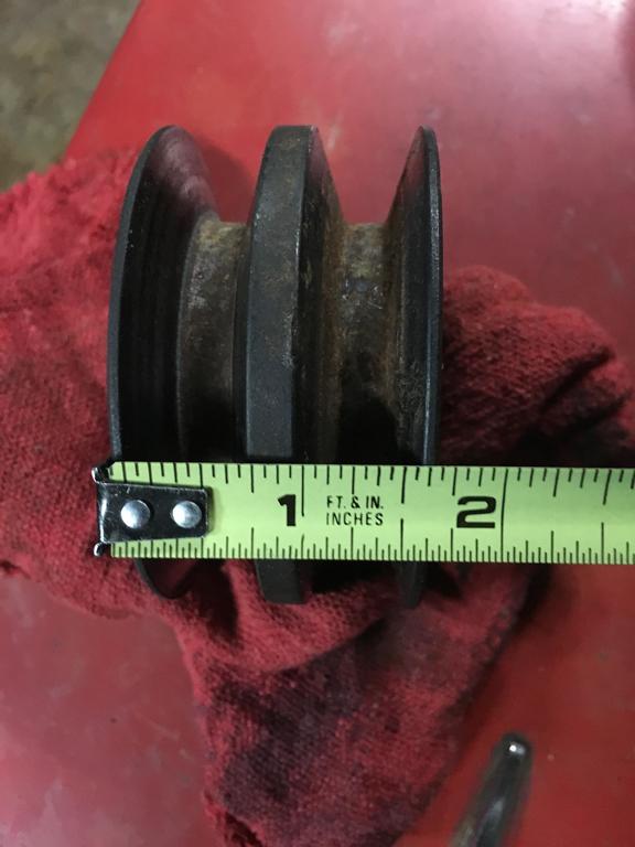

By Team70R
Finished the Honda swap on my 606 and finally got new tires on it! Went for a test drive and it's all revs and no speed! The Honda pulley is a little bigger than the factory Tecumseh pulley so I thought it would be faster! What the heck is going on?! Belt isn't slipping because it'll spin the tires in every gear when I hooked it to my jeep
