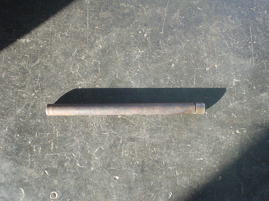

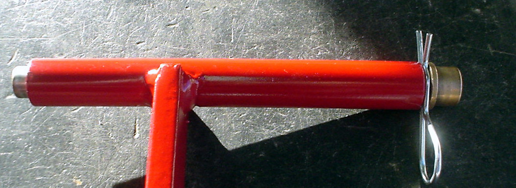

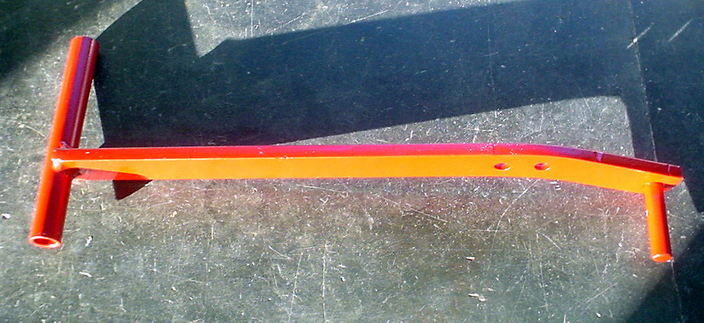

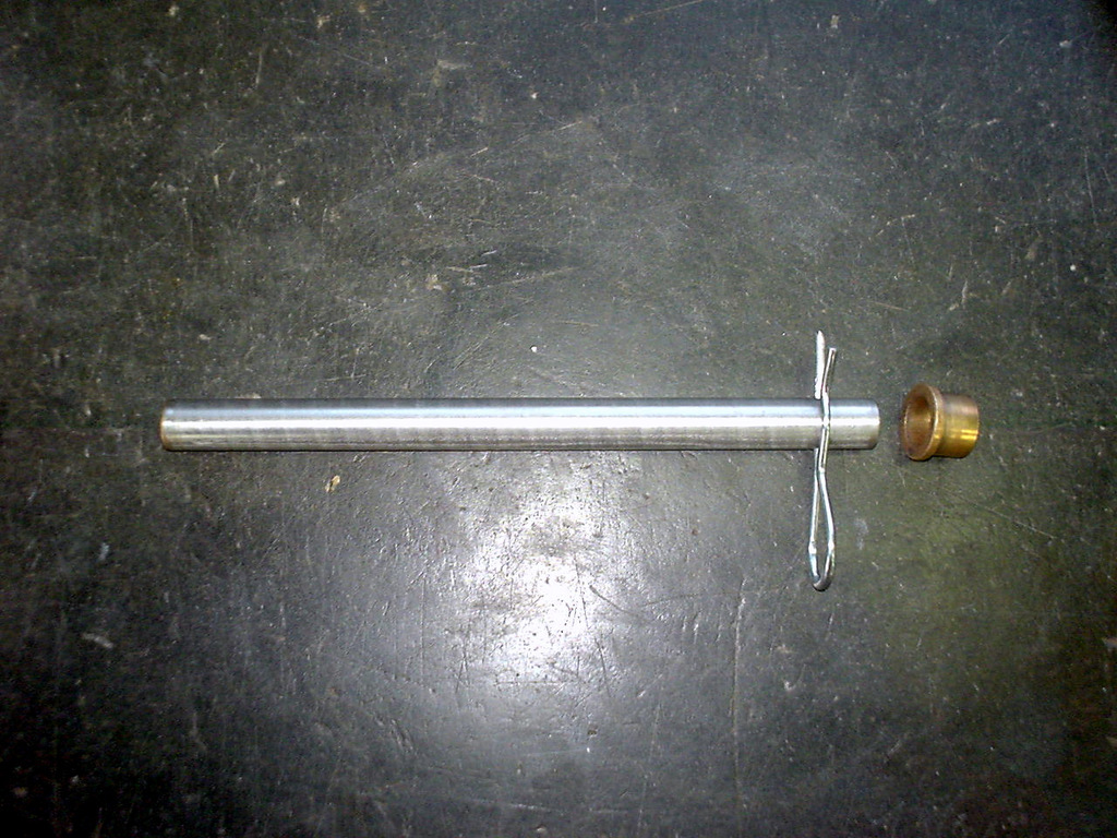

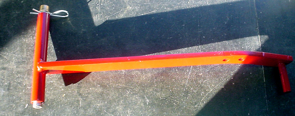

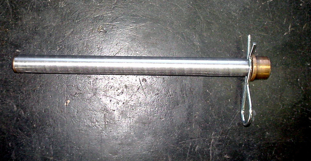

cleat
Wheel Horse offered more heavy duty T bars in the later models.
I have upgraded all of mine to this style.

cleat
They are factory Toro parts.
I have got at least one from ebay. (I don't see any right now) just search wheel horse 520 lift.
The pin tends to be worn so I make my own as seen in the pictures.
Factory uses an E clip but I can't cut the slot for those so I just drill and use a pin instead.
Wheel horse heavy duty lift bar pin dimensions.pdf
The brass bushing is available from toro or just order one from your local bearing supply (just take in your old one, they will match up a new one).
