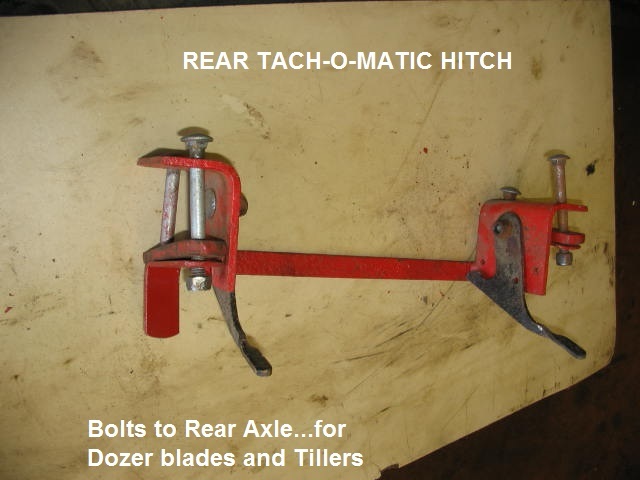

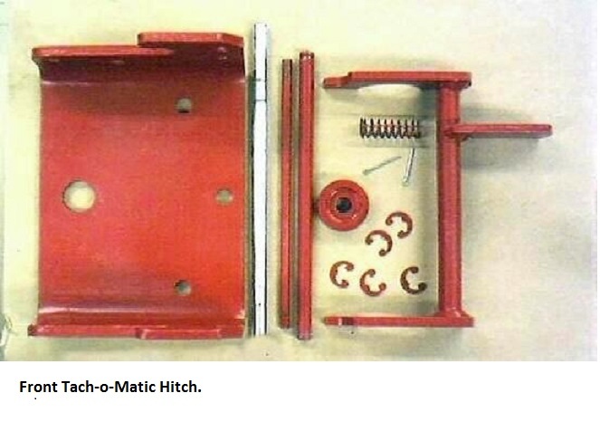

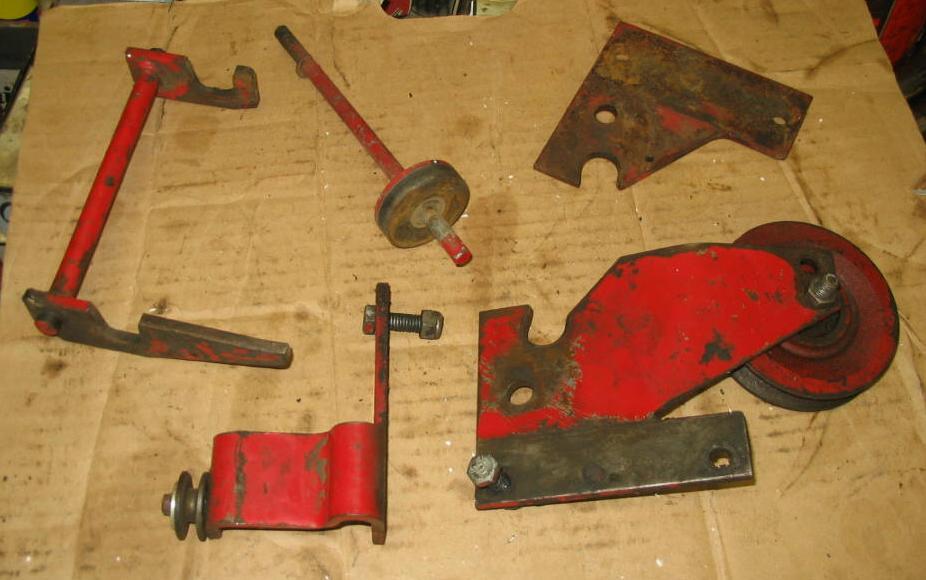

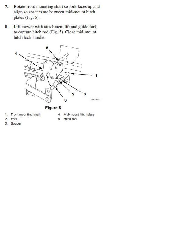

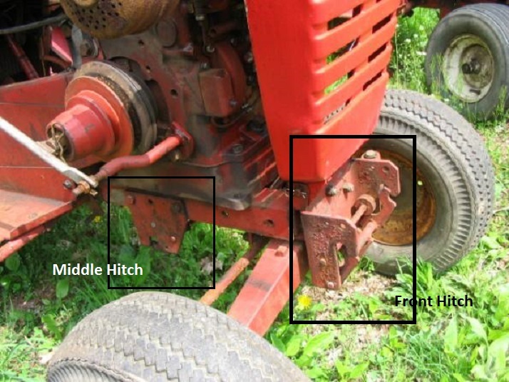

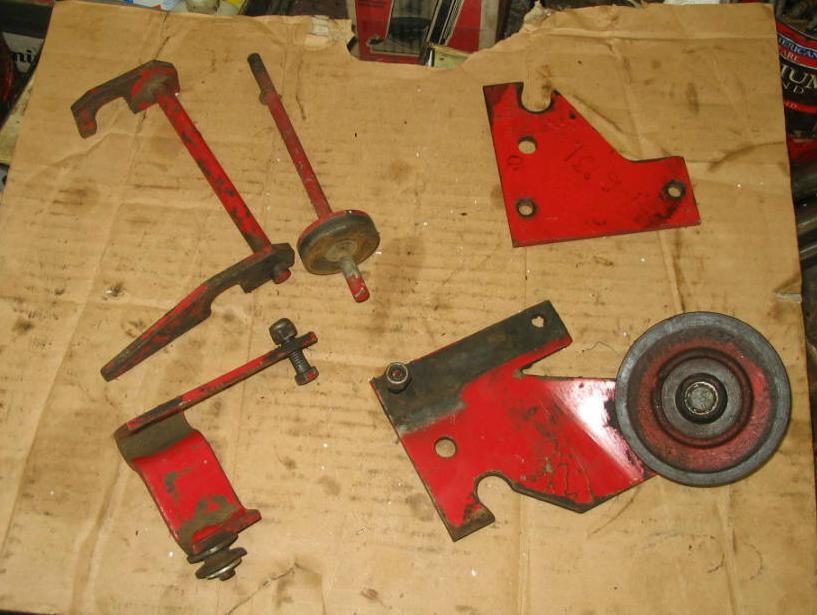

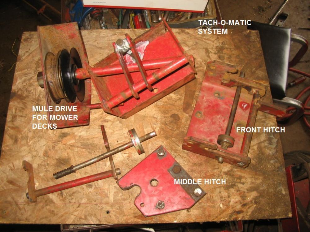

Wheelhorse designed the Tach-o-Matic system in 1973 models and is a universal hitch system to accommodate MOST of the implements without having to use a wrench or hammer at all to switch from a mower, dozer blade, snow thrower, or whatever.  Here are a few pics of the Tach-o-Matic hitches...FRONT, MIDDLE, and REAR.
ps... I have a good used Middle hitch for your 857  (the last 2 pics in this series).   Send an email to me at:
daveoman@windstream.net
You'll also see here the predecessor of the Tach-o-Matic hitch used on most models up thru 1972.  The primary change in hitch systems for the switch-over years of 1972 to 1973 (and all subsequent years) was the routing of the mower deck drive belt.  It was changed from a side-winder pulley/tension system to routing the belt out around the front axle, then back to the center mower spindle.
