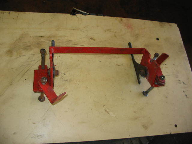

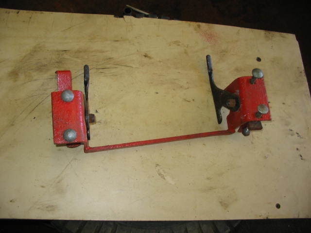

i just bought our house and got a c 120 with the purchase.  needless to say i am trying to figure it all out and boom we are suppose to have a good snow fall tomorrow.
Can anyone share any diagrams on how to attach this?  Do you need to take the mower off?  i have a tendency to over think the small stuff but i am a little stuck.

You need to remove the mower deck from the C-120.  There are videos/manuals here on Red Square of how to do that.  You can also find manuals on how to mount the dozer blade (snow plow).  For that, you will need a bracket mounted to the rear axle....looks like this.

thank you so much.  i will drop the mower tomorrow morning and try to attach the dozer.  the previous owner left all the booklets but i do much better with actual pictures so this really helps.  if i run into help i will yell.
