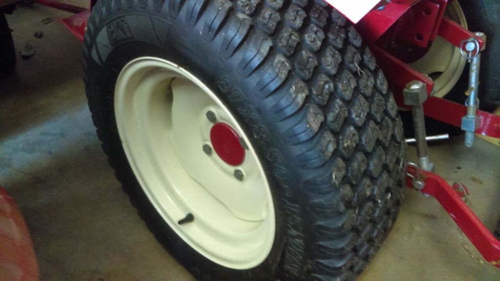

ol550 830 #12 Posted January 5, 2017 Have these on my GT-14 BKT 27X8.50-12 One heck of a tire! 2 Share this post Link to post Share on other sites
