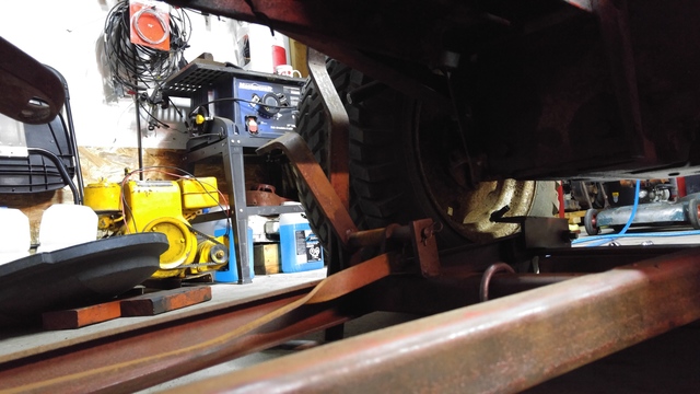

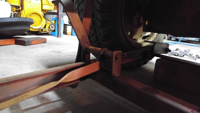

 I bought this plow for my 875 wheel a matic with the foot release off a member here.He's a great guy, and i'm really happy with the plow,and his honesty. I wouldn't hesitate to buy anything else from him. I've had other plow's for other model wheelhorse and have had no problem hooking up the lift arm/plate under the tractor to the plow to raise and lower it. Di need a trunion and a lift rod. If anyone could snap a picture of what i need or how i hook it up, i would really appreciate it. Thanks

 That's an early 60s snow plow frame.   I have one on my 603.  My lift link is approximately 10 and three-quarter inches at the center of the holes. Here are a couple of pictures.  I don't know if it's mounted correctly as this is the way I received it when I purchased it.  Sorry for the poor pictures my iPad does not have flash?
