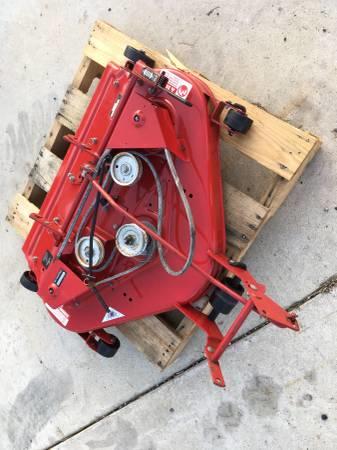

SteveP 1 #21 Posted September 5, 2017 I am looking for a 36" mower deck for my tractor, model 3536RL01 I see that you were selling some. Do you still have these left? Share this post Link to post Share on other sites
Walt 339 #22 Posted September 5, 2017 22 minutes ago, SteveP said: I am looking for a 36" mower deck for my tractor, model 3536RL01 I see that you were selling some. Do you still have these left? First Secondly this thread is from 2009 and as I read through it I don't think he bought any of them. I did happen to see this on CL last night if it is along what your looking for check Grand Rapids of west Mich CL. 1 Share this post Link to post Share on other sites
SteveP 1 #23 Posted September 5, 2017 WOW..Great! and thanks...Funny I look through those classified adds and didn't see that. That's exactly the one I need, these can be hard to find! 1 Share this post Link to post Share on other sites
Walt 339 #24 Posted September 5, 2017 5 hours ago, SteveP said: WOW..Great! and thanks...Funny I look through those classified adds and didn't see that. That's exactly the one I need, these can be hard to find! I just double checked put in wheel horse as 2 words it does not show up using wheelhorse. Share this post Link to post Share on other sites
