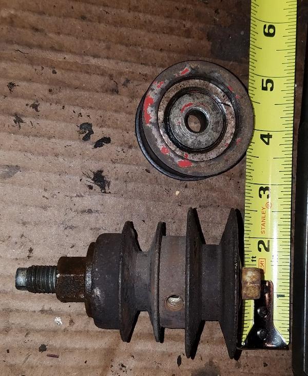

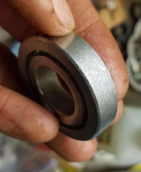

Walleye 28 #29 Posted January 17, 2017 Well I know I have another pulley or 2 around but it was late last night and I'm unable to find them at the moment. So here are the 2 that I did find. I assume that the small pulley with red paint still on it is possibly the clutch pulley? - It has a NICE 7206 bearing in it if that helps. I think I need a pulley for the engine. And that the other pulley was just thrown in and not applicable to the Suburban at all. Also attached is a photo of a General 22603-01 bearing. 1 Share this post Link to post Share on other sites
Walleye 28 #30 Posted January 17, 2017 Ok I found the tractor diagram in the manuals section - wish I'd found that sooner. Lol. Looks like I need #1608 drive pulley - only 1 right since I am not running a mower deck or anything right? #1616 Idler Pulley #1522 bronze bearing #3632 Stud Idler Pin #1272 Snap ring #1569 Belt Any suggestions on where to find these things? Share this post Link to post Share on other sites

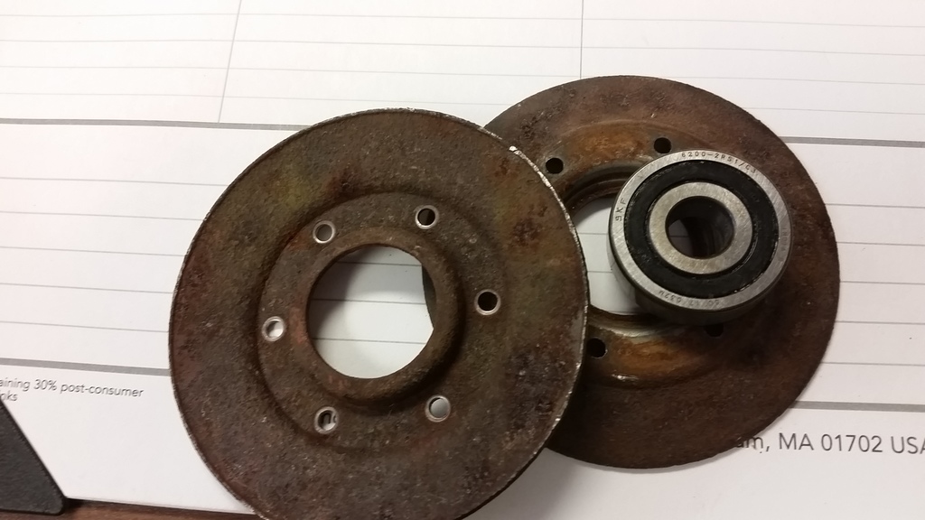

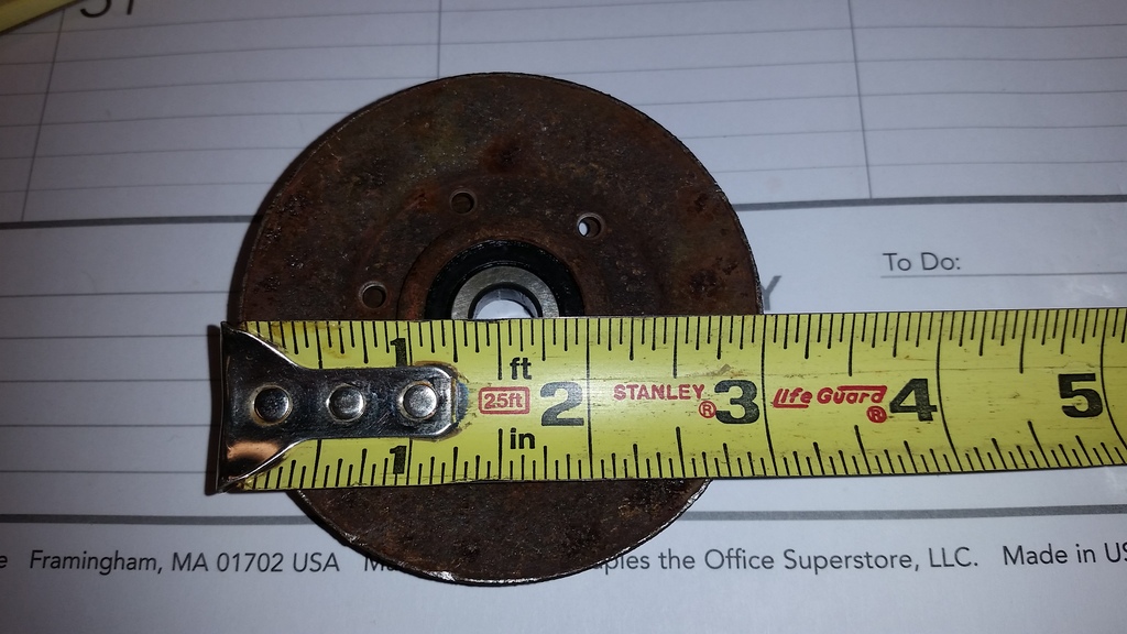

WHX?? 53,305 #31 Posted January 17, 2017 (edited) Some interesting conversation on that clutch idler pulley here Walleye http://www.wheelhorseforum.com/topic/57982-dennys-free-suburban-work/?page=4 starts on about post 79 or so. We did not have that type of pulley that is shown in the IPL , with the bronze bushing and clip so we were thinking the IPL isn't right at all or was for RJ's?? The 1569 belt is just a common off the shelf belt but I forget was size it was without looking at my build notes. I wanna say 29" in 1/2" width?? Dang memory! Can find out for sure. I do have an extra pulley that I separated for a new bearing...last post in this thread. I do not have the pictured slotted/threaded stud tho as I used it in my build. A bolt with appropriate spacer would work tho. http://www.wheelhorseforum.com/topic/61433-pulleys-idlers-for-free/#comment-570677 On the drive pulley that should be a common finished bore available anywhere. Don't have the dims right here but can get them for you. Edited January 17, 2017 by WHX9 2 Share this post Link to post Share on other sites
Walleye 28 #32 Posted January 17, 2017 Thanks Jim! Can you give me the diameter of both the idler and drive pulley? I will see if I can just find generic pulleys that will suffice. Otherwise, I will possibly see about getting that pulley from you., Share this post Link to post Share on other sites
WHX?? 53,305 #33 Posted January 17, 2017 (edited) Here is the idler I have, 3 in diameter it appears, 3/8 bore, 1/2" width. Will double check but if I am not mistaken (I'm most often am) 3/4 finished keyway bore by 2 1/2" dia. on the drive pulley. Might be some good candidates for a replacement here as well https://www.motionindustries.com/taxonomy/Mechanical Power Transmission/Power Transmission Belts & Belt Pulleys/Power Transmission Belt Pulleys/Standard V-Belt Pulleys/browse/en or here http://www.surpluscenter.com/Pulleys/Finished-Bore-Pulleys/?page_no=1&fq=ATR_Grooves:1&fq=ATR_Bore_Fractional:3/4\" Edited January 17, 2017 by WHX9 3 Share this post Link to post Share on other sites
