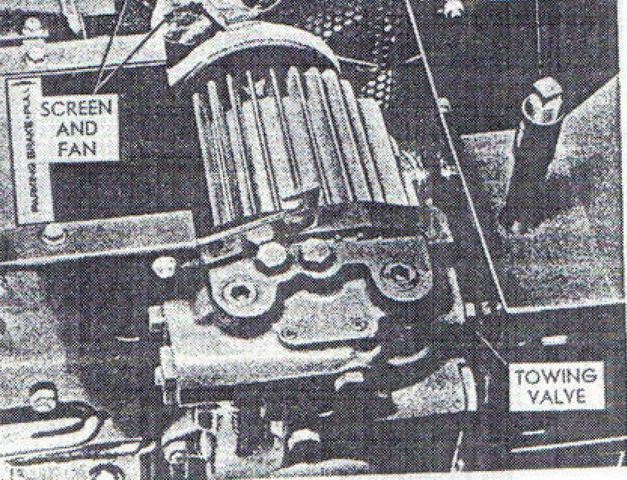

Is the tow valve completely closed?

All of the above easy checks.    I think the tow valve on this Sundstrand is a well hidden hex head bolt on the top, left rear of the case. It must be turned in CW.

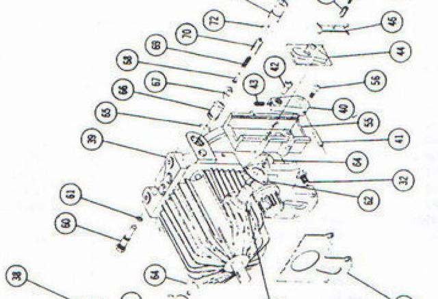

pfrederi
Tow Valve  #60 in first picture

:text-yeahthat:     If you were able to push or tow the 1277 then it is most likely the towing valve having been opened.
stevasaurus
When you go to tighten the tow valve, you just need to snug it...do not over tighten.it.  You need to open it to push or tow the horse.  :)
