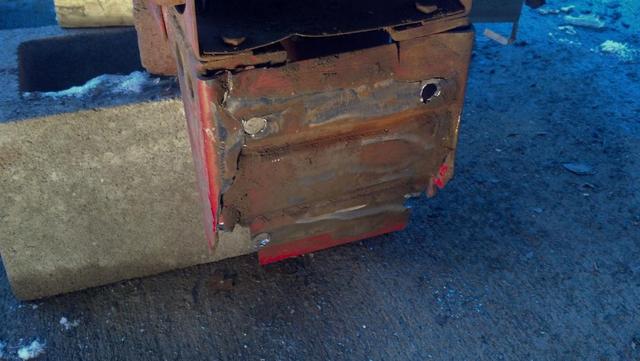

Hello all;

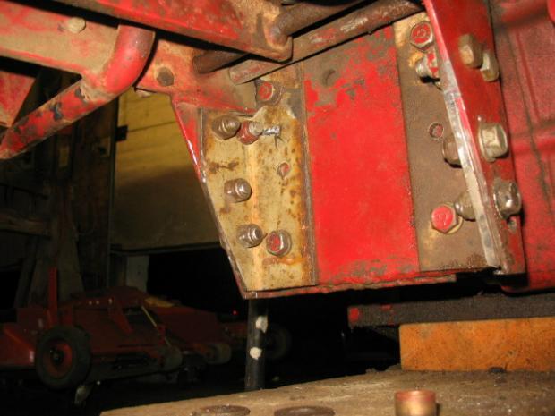

Trying to fab a new frame at work and need the bolt pattern for the frame to the tranny for my 1973 12 hp auto, He is a pic from the old frame . Trying to fab a u-shape out of 1/4" and dont know if I have enough bolt clearence on the sides. Looking for the bolt patten on the tranny.Thank guys.

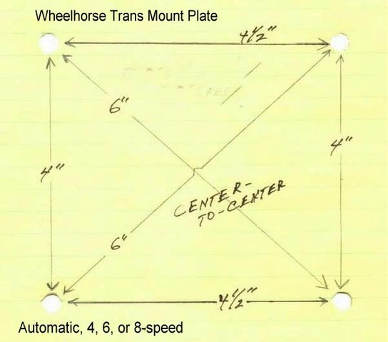

The bolts on my spare 3 speed measure     4.5" wide X 4" high.     I can't guarantee your '73 auto is the same. but my understanding is they are all the same.

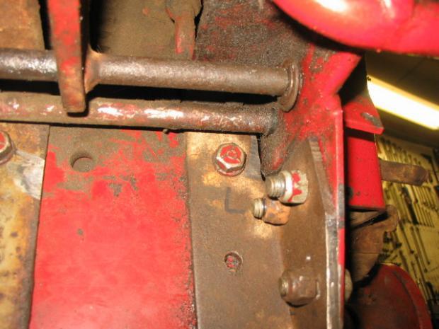

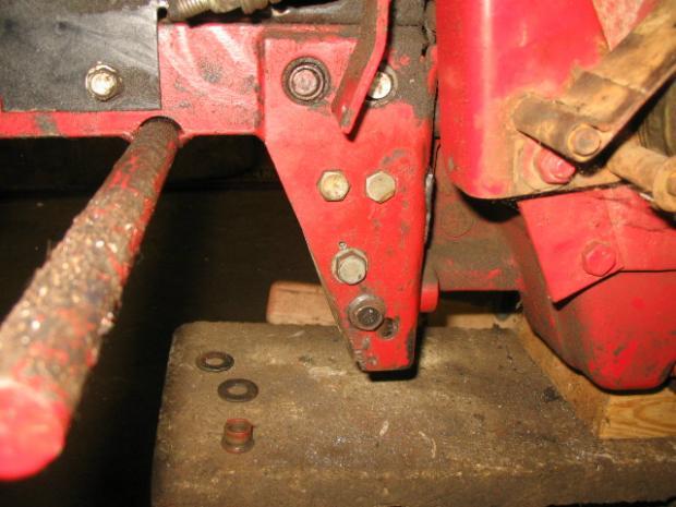

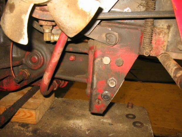

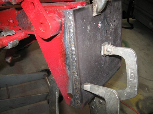

Thank for the replies. This is the second time I have repaired this frame. It is on the inside. I have some pics from the past repair on my thread. I didn't have the frame attachment with me,  I was hoping one of you guys had a diagram from an auto in your arcives. I just need to get thru the winter on this repair of the repair, so in the spring I can get a better an hope permanent fix.
here is the original repair

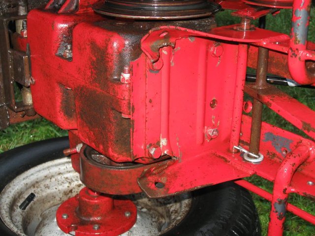

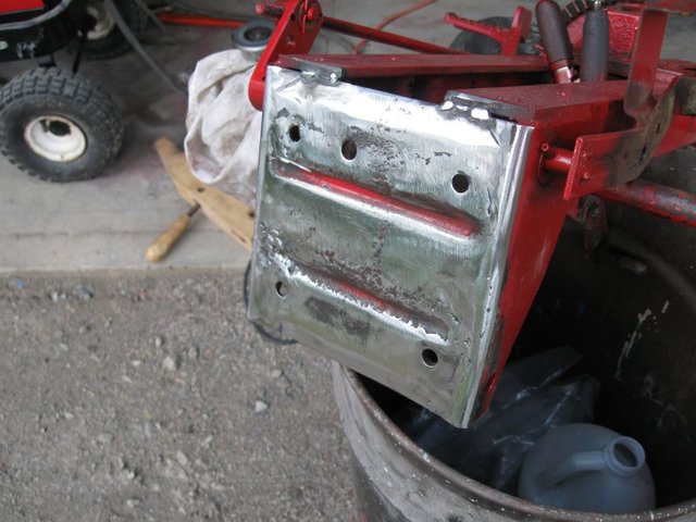

daveoman1966

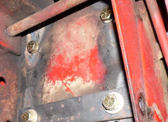

This should help...template of the frame plate.  I had the same issue a few years back and was able to reinforce the plate with 2  x 2 x 1/4" angle iron in each corner/side.  This will NEVER come apart ! ! !
If you elect this method, work on one side at a time.  Otherwise, calamity ensues.

Cracked mounts seem to be a common problem on these older Horses. On my 654 the transmission mount cracks on the transmission side were welded up and a 1/4 X 1-1/2 strap was placed across the front bottom of the transmission mount. I put the same strap on my C-101 and 416-8 even though they weren't cracked, a little insurance just in case, especially for the 416-8 since it pulls a 12" Brinly plow along with a 48" grader blade and a 36" tiller.
N3PUY
My 416-8 had a destroyed mount plate when I purchased it.  I don't know what the PO did to it but it was on a small farm.  I straightened it, welded the cracks and plated the mount area with 3/16" steel.  That moved the axle back a tiny bit but not enough to cause any problems.

Basic question (don't have my manual in front of me) I'm drawing up a  new bracket and need the bolt size that bolts into the tranny. Im thinking 7/16???
pfrederi
3/8"

When these frame plates crack, it is usually a 2-prong calamity.  First, the plate is cracked at the corners and the second place is at the two lower mounting bolts.  Very typically, the cracks / break-aways are BOTH at the corners and the mounting bolt holes.
Fitting a 1/4" (or 3/8") square plate to the front of the original trans plate, then welding it at edges & bolting it in 4 places does not fully address the issue of where it cracks at the corners.  You still have only 1/8" material at the corners and may very well crack again due to stress.  For this reason, I opted to use the 1/4" angle iron, fit to shape and drilled for each side.  This method adds 1/4" material to the frame plate for bolts,  AND adds 1/4" to the corner, giving 3/8" corner material that will withstand enormous stress before cracking....if ever.
A side benefit in just adding the 1/4" angle iron on each side....NO WELDING required.  Just drill and bolt in.  I used four 3/8" bolts on each side with Nylok nuts.
