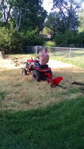

thejangler  :WRS:  as for the 657 frame I believe you can put in a 8hp kholer in it Good power there. Not to sure about a 10 or a 12.  I think if you go larger you run into different belts and pulleys. Not much difference between the 6 and 8. The 8`s you can do a lot with them. I have an 8 hp do plowing with it Have a 10c.u. dump cart I fill it with dirt- rocks -wood -tow up hill with it. the thing I like it is a small frame get in to tight spaces with it. Enjoy it what ever you decide.

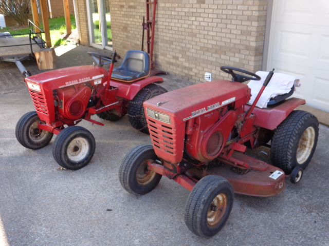

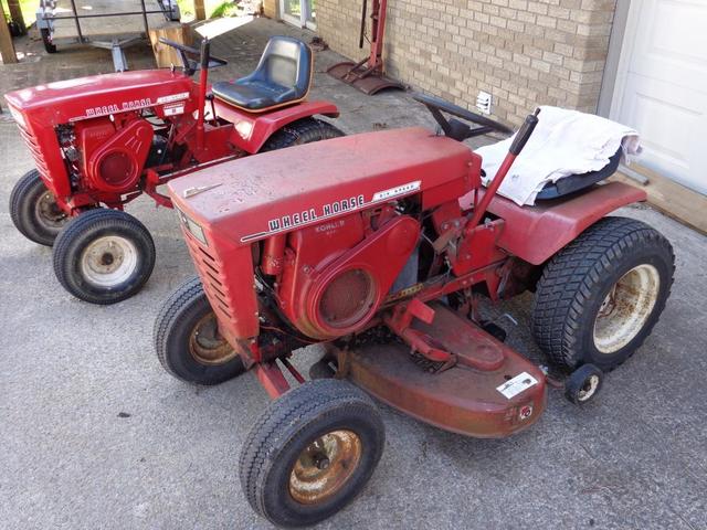

Interesting. I thought those were long frames. I see the 875 and 1075 use different belt guards to compensate for the difference in shaft height. Unlike the 70's b/c series where the 8hp sat on a riser plate making the shaft the same height as the bigger blocks. Interesting stuff. OK, who's got a 16hp mounted on a short frame? :)

I have both a 1067 and a commando 8 (which is 1 year newer than the 857 but the same machine) The frame is deffinatly longer on the 1067 and the hood is longer and taller. A kohler 10hp is massive compared to an 8hp. I think It would take an extensive amount of modification to fit a 10hp in a 857.
