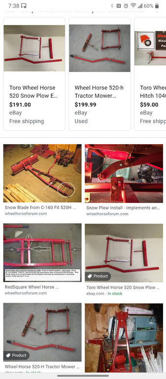

Wheel Horse Rodeo Star 0 #5 Posted September 20, 2020 Will a plow for a 520-H fit on a 4-16-8? Share this post Link to post Share on other sites
WVHillbilly520H 10,376 #6 Posted September 20, 2020 2 hours ago, Wheel Horse Rodeo Star said: Will a plow for a 520-H fit on a 4-16-8? Yes, but if it has the "extension kit" for the swept front axle you won't need that and can sell it to a 520H owner to recoup some of your money back. Share this post Link to post Share on other sites
Wheel Horse Rodeo Star 0 #7 Posted October 20, 2020 Thank you for the info sir, very detailed and appreciated. I have another question if you don't mind. Will a Snow Blower Model # 6 0200, SN 854189 fit either the 1989 416-8 or the 1991 520-H? Share this post Link to post Share on other sites
