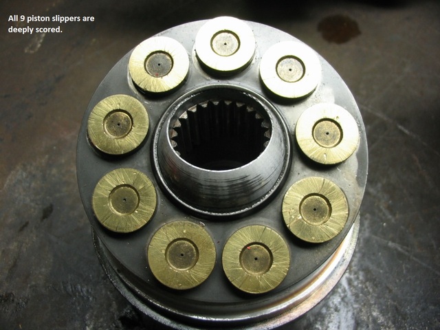

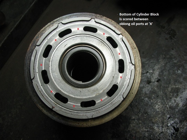

daveoman1966 3,788 #2 Posted December 9, 2016 There should be a HEX PLUG on the bottom, toward the rear. Be sure to blow all the dirt and crud out of it. What you describe...no power in either direction...is typical of a worn-out hydro pump. It should be model 90-2062 and I have rebuilt a few of these over the years. It is very likely that the internal BRASS surfaces are scarred / scratched leading to a loss of pressure and that causes lack of power. If you are at all a wrench-head, this isn't so difficult an undertaking, but take a lot of patience and time to get it right. Here is a pic of what MAY be the problem, although other issues may be suspect as well. NOTE.... you'll probably find other scarred parts in the guts... and you should replace the 3 rubber seals in the pump too. 2 Share this post Link to post Share on other sites

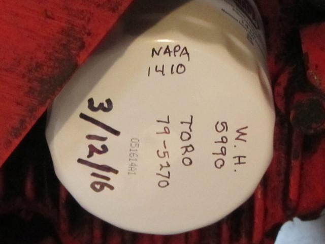

953 nut 57,430 #4 Posted December 9, 2016 1 hour ago, Bubba KC jr said: been sitting for a few years,it will not hardly pull in forward gear.but will not back up at all.i am going to try and change out the fluid and filter Do you know any of the history on the ? Did the transmission work when it was put up for storage? The filter you will need is a NAPA 1410 and the oil (if it is RED) will be Dextron ATF, otherwise it will use 10 W 30. Will the hydraulic lift lift and lower well; if it is strong then the pump may not be the problem. Another potential cause if the pump is good would be the acceleration valve springs. Let us know after the fluid change how it is doing and what you find. Take a look at the drive belt going from the engine to the Hydro pump; if it is not able to be tightened or is deteriorated that could be the problem. This manual should be helpful. 1-7441.pdf 1 Share this post Link to post Share on other sites

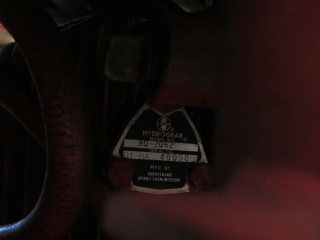

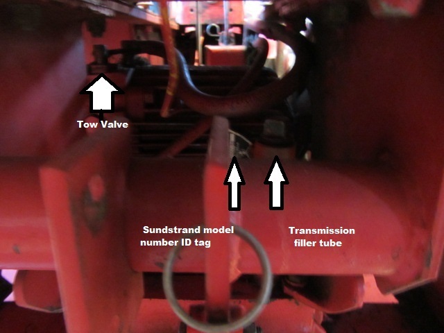

ztnoo 2,299 #9 Posted December 9, 2016 If you are going to change fluid and filter, I would suggest getting the tractor inside where it can be warmed up for several hours before changing tranny fluid. It will flow much better if warm and drain more completely. I also elevate the front of my GT 14 slightly when I change fluid to insure as complete emptying as possible of the transmission since the drain is in the very rear and bottom of the case. I also open the filler plug on top to vent the system. Here's some Sundstrand identifier locations: Close up of tow valve. Lefty loosey, righty tighty. Here's the Sundstrand VIN tag identifying the model. To my understanding, the 90-2062 was only used on the GT 14. Pic with proper transmission filters to use. Its very important to use a proper transmission filter when replacing because of the micron filtering abilities of these filters, as opposed to an engine oil filter. 2 Share this post Link to post Share on other sites

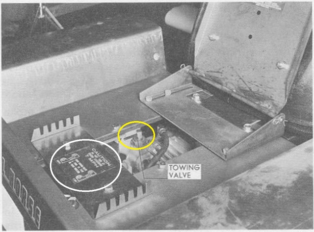

ztnoo 2,299 #10 Posted December 9, 2016 Found a pic of the tow valve in the 1-1441 manual. 1-7441.pdf It should help you locate the tow valve. I have increased the original size without much degradation of the original picture quality. Share this post Link to post Share on other sites

ztnoo 2,299 #13 Posted December 9, 2016 The tow valve on a GT 14, if you have the original and standard Sundstrand hydro 90-2062, is on the left side. Check the model number on the Sundstrand VIN tag, viewed from the rear of the tractor. If you are sitting on the seat facing forward, the tow valve will be literally under your left butt cheek. Of course you have to lift the seat to see it, but I assure you it is on the left side if you are facing forward like you are going to operate the tractor. Guaranteed. You may need to slide the seat forward as far as it will go to see the tow valve. Have another look at my pic and your own tractor. 1 Share this post Link to post Share on other sites

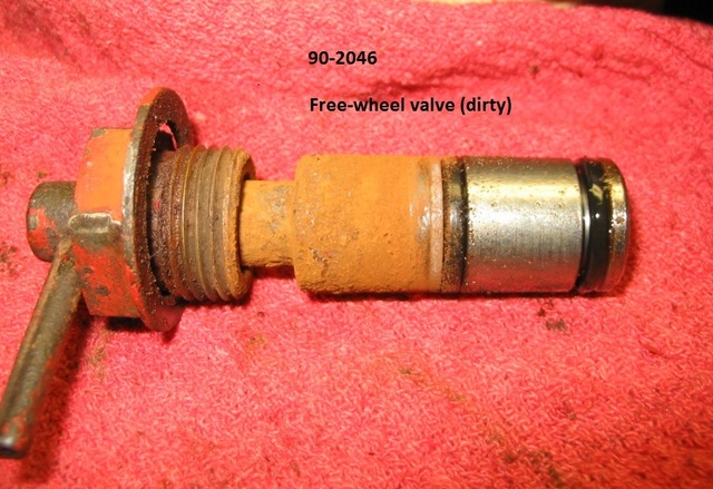

pfrederi 18,277 #15 Posted December 9, 2016 22 minutes ago, Bubba KC jr said: Sorry my mistake it is on the left side but it faces towards the front of tractor.i can't see it but can only feel it.so I think I have to take a part of fender off.do I need to tighten it to drive or loosen it to drive tractor.i apologize again.thanks for input There is a roll pin stuck though the top of the tow valve stem. Turn it so it faces the rear to push the tractor..Turn it toward the front to drive. This is ported valve you can turn it all day long the only thing that matters is which way the long end of the roll pin is pointing. There should be a sticker like in the manual picture above 2 Share this post Link to post Share on other sites
ztnoo 2,299 #16 Posted December 9, 2016 (edited) You shouldn't have to remove the fender. Possibly the seat, and the maybe apparatus that locks the seat in a fore/aft position to get to the tow valve, but you shouldn't need to remove the fender. I have never had to do that. The valve may be really stuck in whatever position it is now in, so it may take some real elbow grease and penetrant to free it up. It may have never been turned since it left the factory. If its a '69, 1-1441 model, that means almost 48 years at this point. That's a long time for any valve not to have been turned, one way or another. Screwing the valve to the open position (tow) should let you push the tractor around, although at almost 900 lbs. "wet" with fuel, oil, and tranny fluid, it's still work. We're essential talking about roughly half a turn. Screwing the valve to the closed position (drive) will allow the tranny to operate normally and it will be almost impossible to roll the tractor due to hydraulic resistance and pressure in the system. Edited December 9, 2016 by ztnoo 1 Share this post Link to post Share on other sites

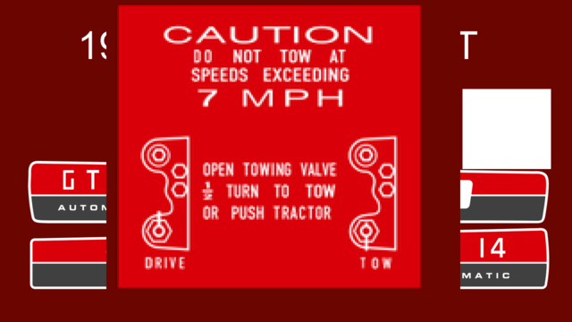

953 nut 57,430 #17 Posted December 9, 2016 Here is an enlargement of the decal that should be next to the tow valve showing the positions. 1 Share this post Link to post Share on other sites
ztnoo 2,299 #18 Posted December 9, 2016 White oval: Directions for orientation of the tow valve to either drive or tow. Yellow oval: Tow valve (shown in tow position). 1 Share this post Link to post Share on other sites

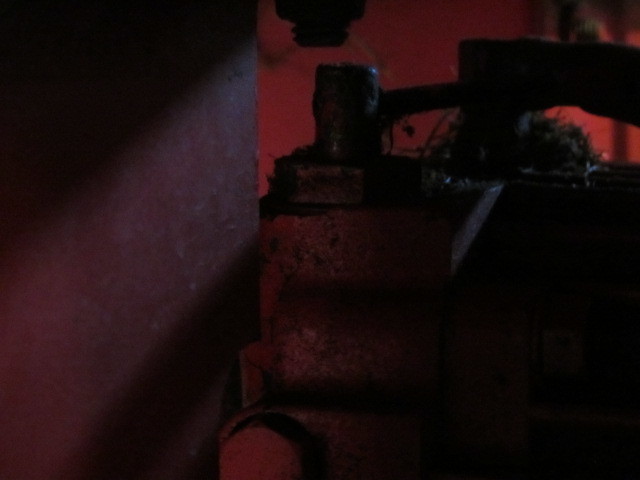

Bubba KC jr 9 #19 Posted December 9, 2016 My tractor has the battery under the hood and under the seat is just transmission and a bunch if hydraulic lines if I reach up under fender on left side I can feel what seems to be a part of transmitted that sticks out like a finger with what seems to feel like a flat headed screw with a straight screwdriver slot in it.I do know you can push it now its not easy but it can be pushed in what ever position the valve is in currently.after it warms up outside I will go out and use all this great information all of you have given me and also find the serial # and mod.# tag and get back with you all thank you all. 1 Share this post Link to post Share on other sites

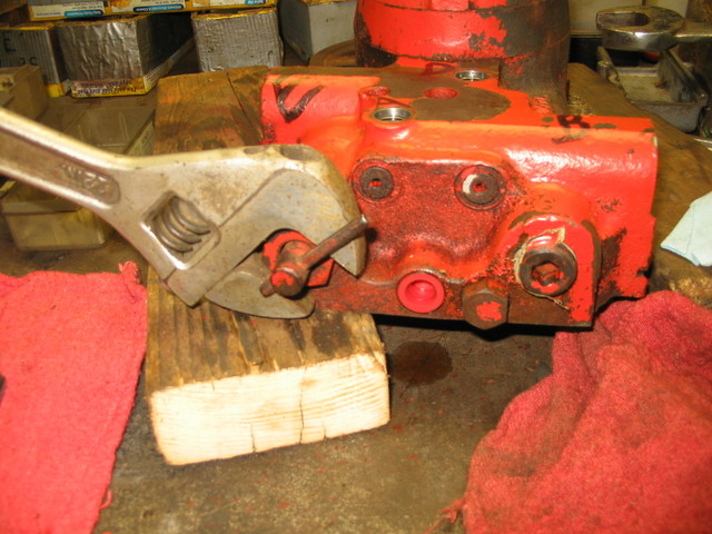

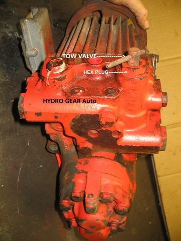

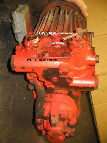

daveoman1966 3,788 #22 Posted December 10, 2016 Here is a pic of the PUSH / TOW Valve. If you cannot turn the 'roll pin' handle, just put an open-end wrench and break loose the HEX END plug. Doing this will open the valve and allow you to roll the tractor. Once indoors, take the HEX all the way out and free-up the valve. 2 Share this post Link to post Share on other sites

Bubba KC jr 9 #25 Posted December 10, 2016 I took some pics with my tablet and when I click on the choose files it does not give me the option to go to my documents or images.my tractor does not have the tow valve like in your pics it has the one that sticks out like a finger and has a flat head screw facing the front of tractor.behind left fender.i will have to use a short screw driver or take some of fender off.thanks 1 Share this post Link to post Share on other sites
