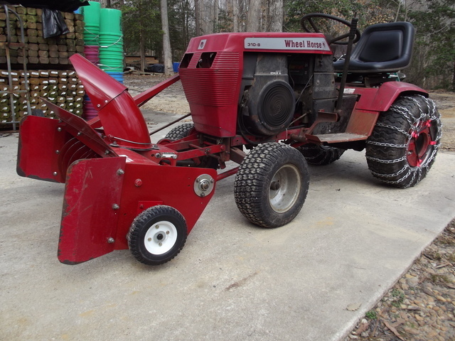

dlaw90 14 #5 Posted December 5, 2016 10 minutes ago, Ed Kennell said: My suggestion is to buy another tractor. A tractor for each implement saves time and it's good to have a back up snow machine. Haha I think I'll have to keep dreaming for now 36 minutes ago, Walt said: I would figure it would take around 1/2 hour to remove blade and mount snow thrower. Now this is only my estimate since this is first year I have had both. Hell this first year I have even used the tractor I inherited in 2011. I have mounted and dismounted both a number of times this year working through different things so the tools needed and steps to change them are fresh in my mind. Thanks! 34 minutes ago, JAinVA said: I gave up pushing snow a few years back and the only front blade I had on my c120 I didn't like.It was a an adaptation of a another brand's make and was not mounted like the WH unit so I can't say how difficult it would be to remove the WH unit.My blower is easy to remove and install.I leave the flag attached and wire it to the mower deck lift.I also installed 8" wheels instead of skids and the blower rolls easily once removed. JAinVa That sounds like a good idea. Do you have any pictures? Share this post Link to post Share on other sites
JAinVA 4,629 #6 Posted December 5, 2016 Pictures of the blower with wheels.Not my idea but my take on another members idea. The flag I have no pictures of but once attached you'll want to keep it on year round.JAinVa 6 Share this post Link to post Share on other sites

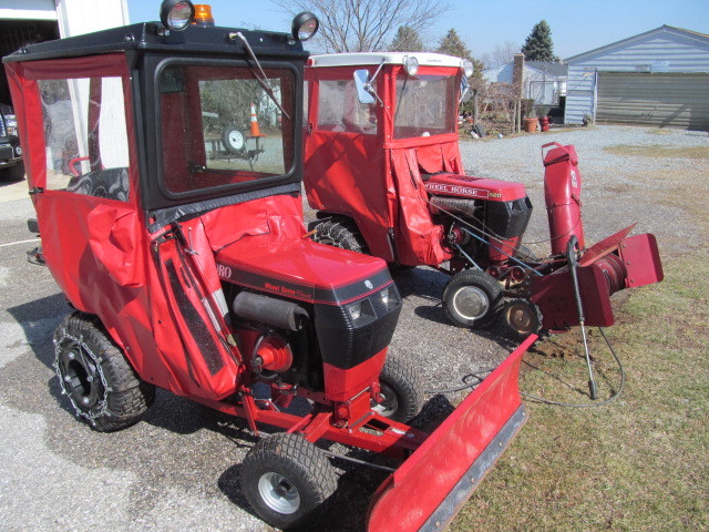

shallowwatersailor 3,214 #7 Posted December 5, 2016 We always have odd winters down here with snowfall compared to the snowbelt that I was accustomed to in the Midwast. My part of Maryland either has little to no snow (two succeeding winters in my seven here) or massive blizzards like last year with a 36" two day blizzard. The others were somewhat regular snowfall winters. I find for a blizzard that I use my walk-behind as I have a single-stage snowthrower on my one tractor that has less capacity IMO. Our irregular snowfall just doesn't justify a two-stage with the additional storage/weight involved.. But I also have two tractors with blades that are ready I use them for the majority of snowfalls we have, plus cleanup after the walk-behind. One has a UMHW edge for the majority of use so I don't damage my neighbors driveways ( I do six neighbors drives as well as mine) but the other one has the steel edge for the occasional ice storm that we get. If the old snow pack gets too bad, I can use my Johnny Bucket to move snow around. For fun I also have a Simplicity walk-behind with a blade to play with. 4 Share this post Link to post Share on other sites

DennisThornton 4,770 #10 Posted December 6, 2016 I can't imagine anymore not having blade and blower ready on tractors. Both attachments and WHs can be found to not break most banks. If you can afford a tractor, blower and a blade for not much more you have another tractor. I'd suggest making that the goal even if not possible for whatever reason right now. 7 Share this post Link to post Share on other sites
