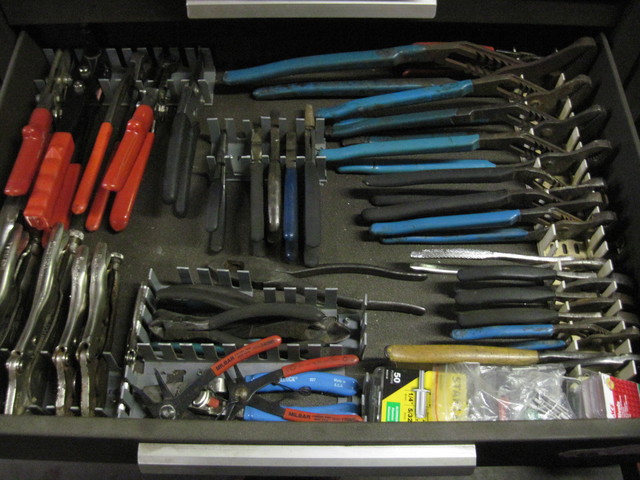

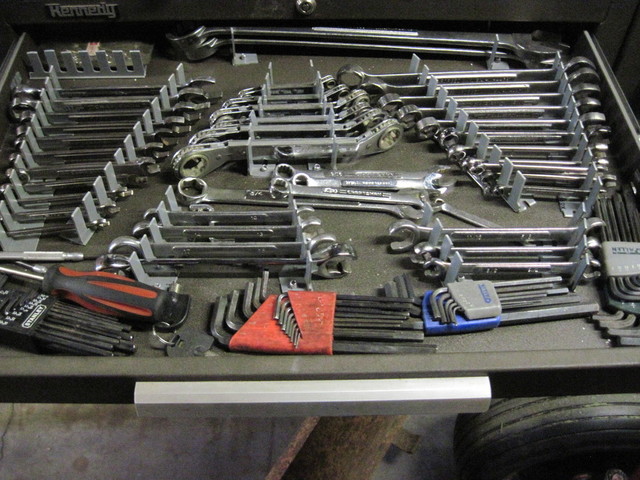

Walt 339 #1 Posted November 20, 2016 Today while reading through the threads that I'm following to gain knowledge for future use I seen a picture in Lagersolt's snow blower auger bearing replace thread. And since I have been meaning to post this idea I have used since entering the work force I seen it as perfect time to pass it on. This setup makes it easy for me to find tools and also when putting tools back after working on a project a open slot keys me in to a tool I over looked while picking them up. I take wire trough cutting it to the length I need to hold the number of tools I want to organize. I then cut it to heigth needed to clear when closing drawers. Once those 2 steps are done I widen the slots that wires went though to fit the tools I've chosen. I split the trough for use with wrenches and used scrap for boxing in the side cutters and snap ring pliers. Though the years I have learned that once these steps are done it is best to set the tools up and position the whole setup were you plan to mount it. I originally used 2 sided tape this is okay but may need to be repaired if glue drys out. I now drill a hole in each end and pop rivet them from under side so rivets don't interfere with anything below the drawer. Some times the length will dictate the addition of a second or third rivet for stability. I spent majority of my career in industrial settings allowing me access to used wire trough for free so I can't say what it would cost to buy a length of it. 16 Share this post Link to post Share on other sites

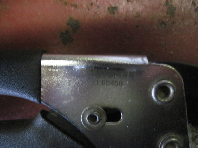

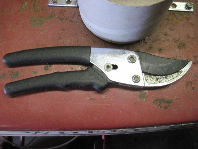

Walt 339 #11 Posted November 20, 2016 22 minutes ago, Ed Kennell said: How do you trim that Walt"? Side cutters? If you look in at picture with the pliers in it in the back left of drawer the black handle tool next to all the red handled tools are a pair of craftsman pruning shears. I use those to cut the height and also to widen the slots then its easy to either bend and break at bottom of cut is its a thin cut or use utility knife if it's a wider cut. I also use those to cut it to length. That pair of pruning shears are more than 30 years old bought them just for this use even though have been know to cut a low hanging branch here and there. Snap a couple of pics of them looks like I got tool number. Now as for separating it into 2 pieces like I did for the wrenches I just score a line (couple of passes with utility knife) down middle of bottom and rock it back and forth till it breaks. 40 minutes ago, Lane Ranger said: Looks like a surgeon's toolbox ! My kid says I have ADHD and OCD because I can't seem to ever take a day off from working on some project and because I like things to be done or stored in a certain way. Me I like the way I feel when I'm working with my hands and challenging my mind plus I sleep well if I work each day. As for the OCD I don't like wasting time to find a tool I need, also helps when I have someone here helping or needing help to say go to this drawer in the left, right or middle section of tool box get this tool from this area of drawer. I also prefer to do things the proper way the first time that's why I tend to over engineer things I build, and her house and mine both surpassed all the local building codes when I rebuilt them both over the first 6 years of retirement. 5 Share this post Link to post Share on other sites
