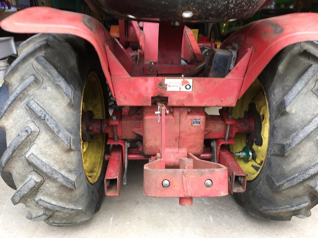

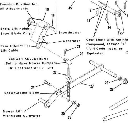

T-Mo-(Moderator) 4,533 #5 Posted December 5, 2016 I put the newer style axle bracket onto my 702 and it fits. But I don't have much of a lift, but I'm not sure where the lift point is on a 702 for the front blade. I do know it takes a longer lift link, but I cut a piece of chain and tried it with that, but I'm not sure if I'm mounting it in the right spot. Any help would be appreciated at this point. BTW, sorry for the yellow rims, but the ags where mounted on them, and I didn't want to put these dry rotted tires on the Wheel Horse rims. They will get a new set of ags. 1 Share this post Link to post Share on other sites
stevasaurus 22,968 #6 Posted December 6, 2016 (edited) See if this works for you. Your picture looks like that bracket did not interfere with the brake drum at all. How close is it? Edited December 6, 2016 by stevasaurus Share this post Link to post Share on other sites
T-Mo-(Moderator) 4,533 #7 Posted December 6, 2016 1 hour ago, stevasaurus said: See if this works for you. Your picture looks like that bracket did not interfere with the brake drum at all. How close is it? Steve, there was plenty of clearance with the brake stuff. 1 Share this post Link to post Share on other sites
