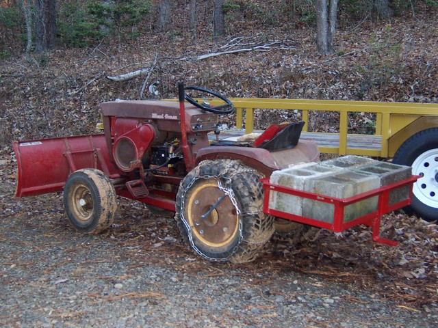

953 nut 57,970 #41 Posted December 19, 2016 On 11/18/2016 at 10:26 PM, lynnmor said: I now have a cracked left transaxle case. Are you sure that there wasn't contact with an immovable object while in motion at some time that contributed to it? In have a home made 2" hitch receiver on my 1055 snow plow and have a 16'; X 32" rack that slides into it, double duty, caries garden tools etc. in warm weather and four concrete blocks for weight for snow plowing traction, 4 Share this post Link to post Share on other sites
Kurt-NEPA 755 #42 Posted December 19, 2016 16 minutes ago, 953 nut said: Are you sure that there wasn't contact with an immovable object while in motion at some time that contributed to it? In have a home made 2" hitch receiver on my 1055 snow plow and have a 16'; X 32" rack that slides into it, double duty, caries garden tools etc. in warm weather and four concrete blocks for weight for snow plowing traction, Wow, I like that idea! I've used a carry-all on my larger tractors for years and love it. You gave me nice idea to add one to my 520H. Thanks 4 Share this post Link to post Share on other sites
Duramax7man7 506 #43 Posted December 19, 2016 Yeah, a standard 8x8x16 cinder block weighs about 30-35lbs unless it's lighter kind which are about 28lbs... So that's some good weight. For extra you could place them on wood and fill the centers of the cells and make them even heavier! Share this post Link to post Share on other sites
