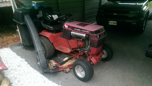

I went with a pr off eBay for $80 to the door "Trac Gard N766" 16x7.50-8 on the bagger 520 I bought in August and rather happy with them so far , just looked and there is also a pr of 23x10.50-12 of the same brand for $156 to the door as the fronts for $65/pr right now, and yes I would stay with the original size just my :twocents-02cents: and the fact bigger looks better, Jeff.

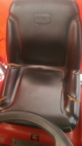

Thanks for the reply about the seat.  My seats have failed at the bottom from flexing at the adjuster tracks.  I made up steel plates that go between the seats and the tracks to help with the problem, so far, so good.  Used .112" thick galvanized from McMaster-Carr.

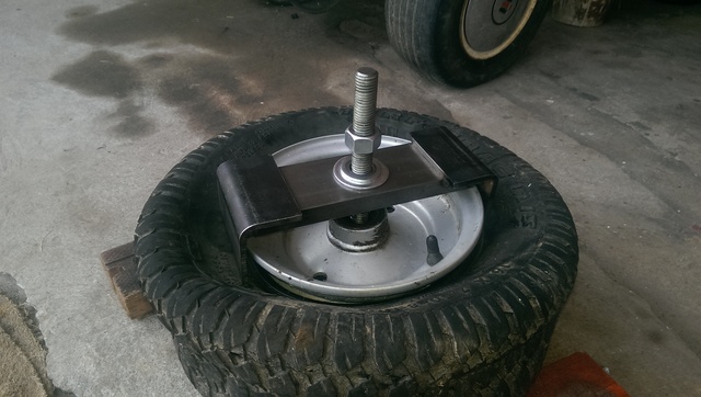

My 2 fronts showed up the same way, some dish soap on the beads/wheels and no schrader valve installed using a "pistol grip" inflator end and squeeze the air till "pop pop" beads seated just fine installed valve and set pressure,Jeff.  And here's my dedicated 8" Wheel tire bead breaker (I know I should have made it adjustable but it works for me) do 1 side the flip over to other.

ACman
Yeah , I sure wish I still could do my own tires , I don't know how many I've mounted and repaired :tools-hammerdrill: . I didn't have the luxury off a powered tire changer :wacko: !
air powered clamp and bead breaker ...even then you had those beads that didn't want to move  :ranting: ! My favorite were the old military tires we used for manure spreaders , those things were tough .

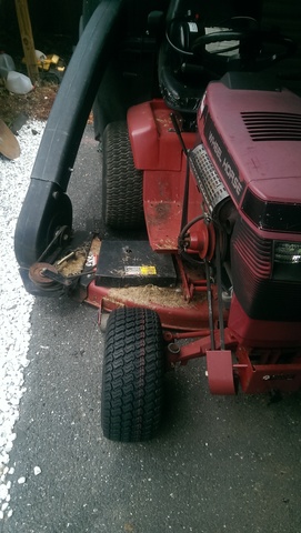

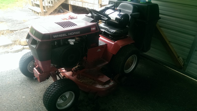

Here's one with them all mounted up . He said they mounted up pretty easy . He used the old rear tubes put them in the new fronts blew them up and placed them by the wood stove :handgestures-thumbupright: . The rears were filled with RimGuard and he charged me $85 for everything , so that brings my total to $235 . Not to bad for four 4ply tires mounted and rears filled :) .
